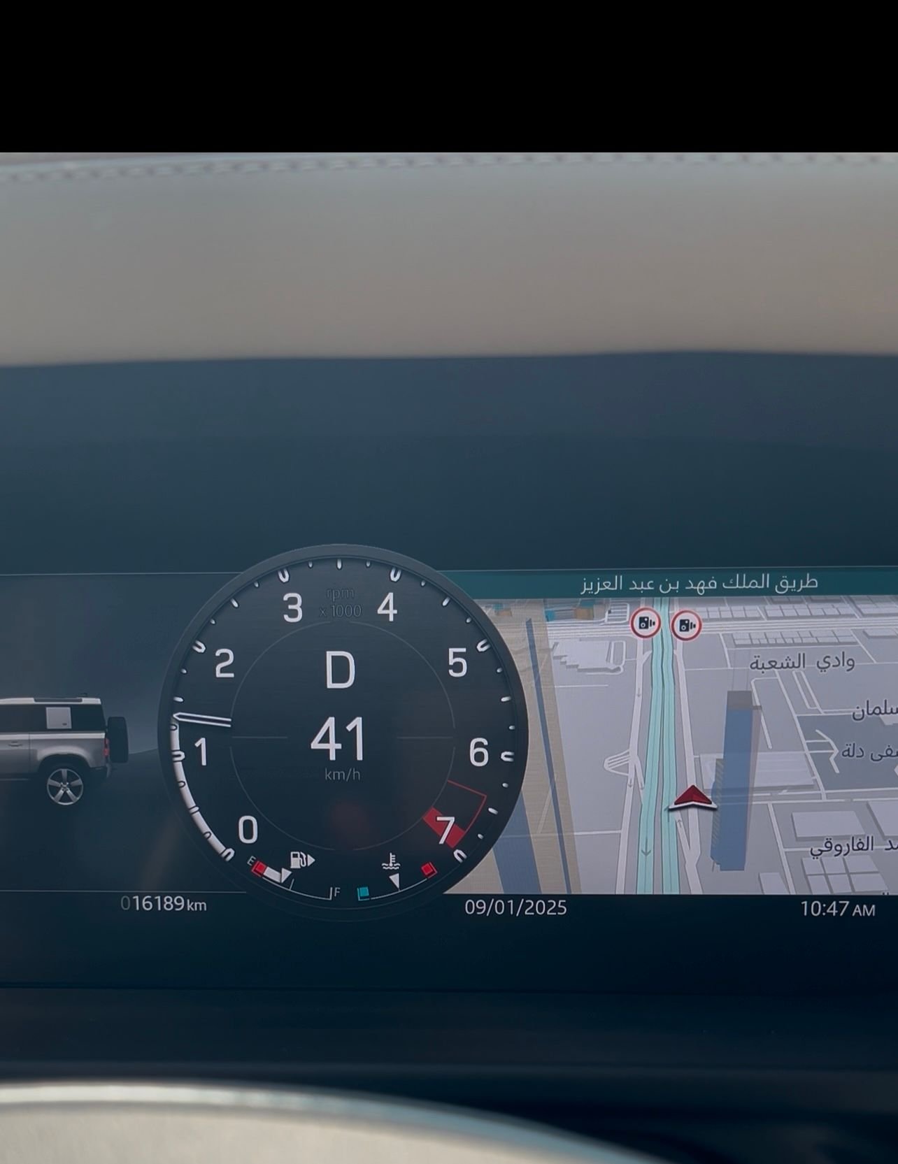

Old Jan 10, 2025 | 03:02 AM
Dajani's Avatar
Joined: May 2024
Posts: 25
Default Image showing the problem
The control panel turns off for a minute then turns on while I am driving the car
