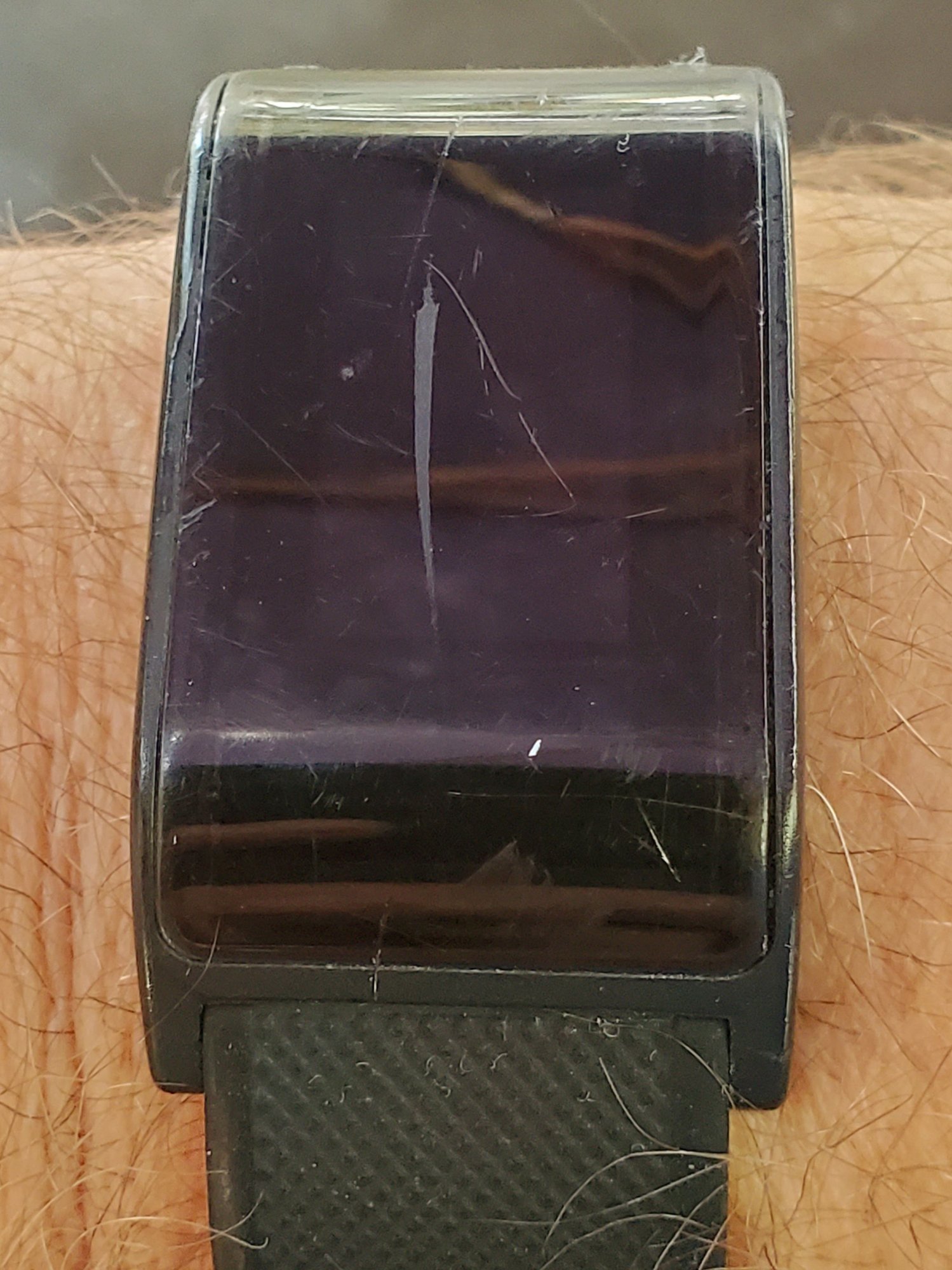

Speaking of which, a permanent plastic film on the display would be nice... That screen scratches so damn easily for an "activity" watch. I've had mine, what, 3 / 4 months? Although I use it every single day for a variety of activities, most of those scratches and scuffs are there to stay. Get used to them.
