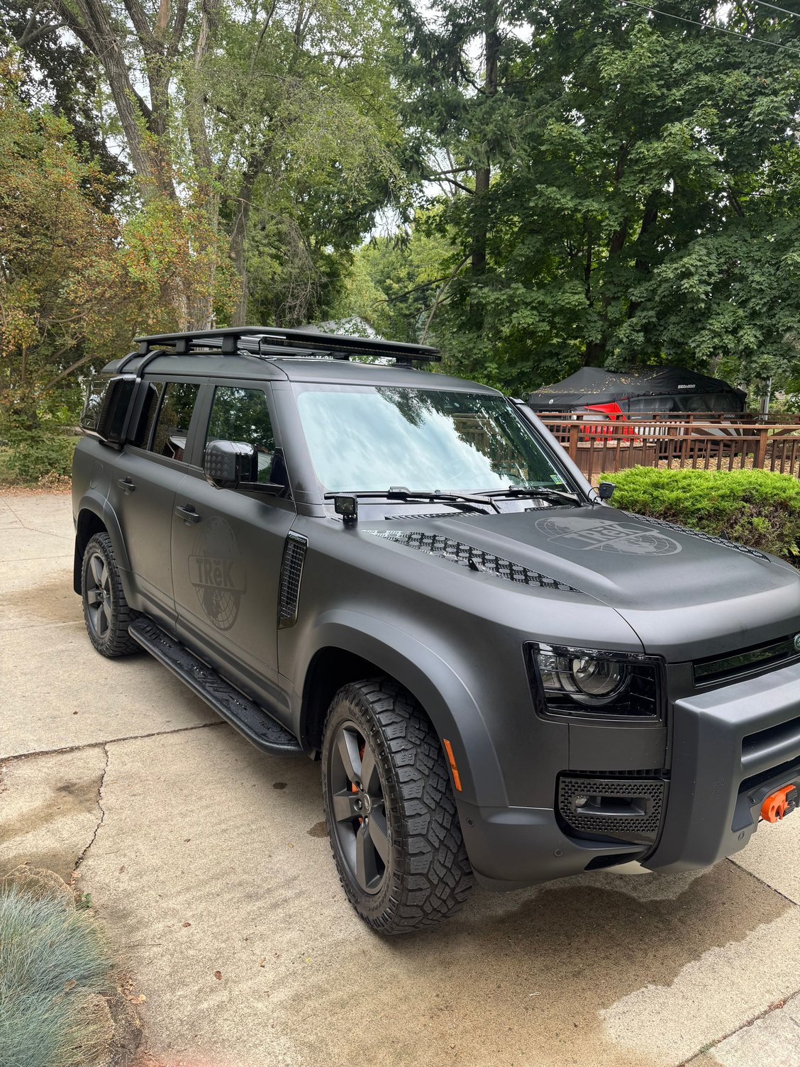

Hi All,
New to me Defender 130 Trek. Doesn't have adaptive cruise control. Earlier I was looking at an outbound that didn't have it either. That salesman told me it didn't have it because of the winch, which I thought was strange. Anyway, I'm thinking about getting the Gap tool to activate it (among other reasons). The question I have, is how do I tell if I have all the necessary hardware to make this work? Where is the radar module thing located if I have it? Seems like it would be around where the winch is, but I don't know what I'm looking for.
Thank you!

Every Defender comes with the hardware. It is located behind the LR badge on the grille.

Its the green oval emblem that is the ACC sensor that comes standard whether you option ACC or not - and looking at your picture - I can actually see a case for why the winch bumper may interfere with it

Ive the same bumper (on a 90) and Ive a winch and my ACC works without an issue.
hope that helps

You'll have no problems with that winch setup.
Adaptive cruise will activate no problems. OEM winch setup. Compatible.
