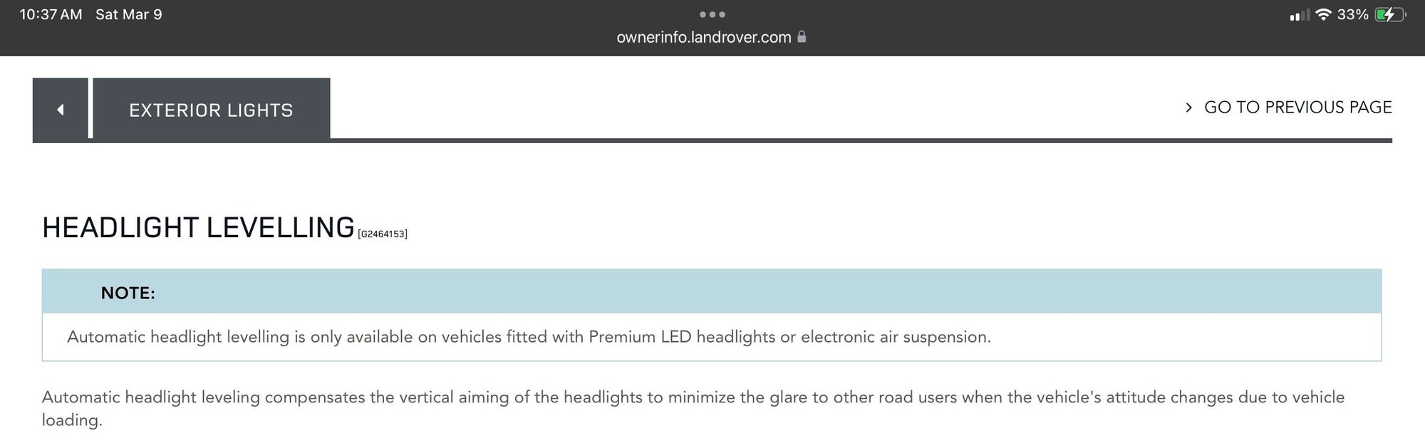

I have a 23 Defender l-400.
When I start the ignition at night my headlights dip and raise.
I am wondering if mine might just need a software update when available?
Thanks...I have had it 2 months and still learning about it.
