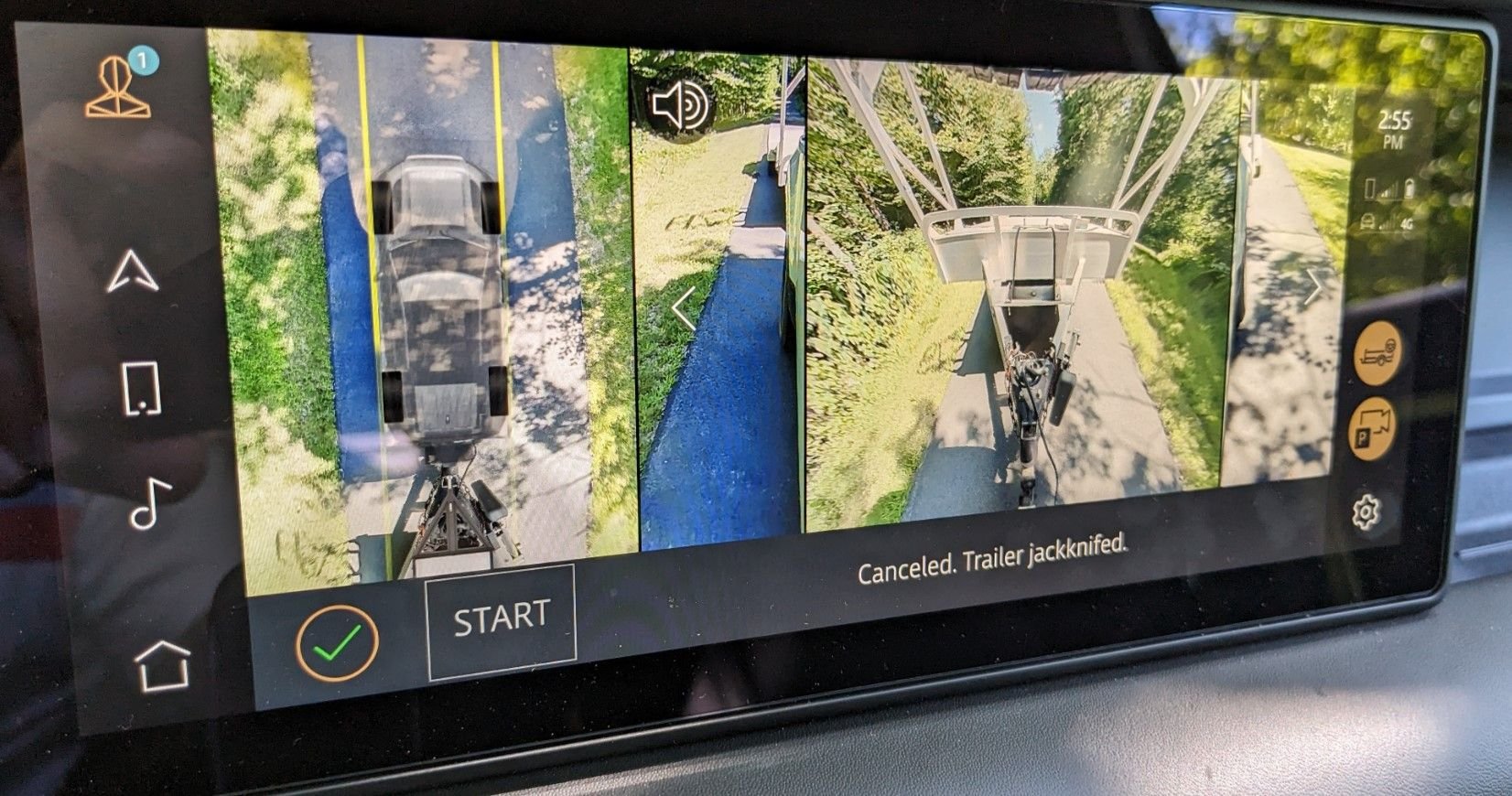

Has anyone gotten this "Cancelled. Trailer jackknifed." error when trying to use Advanced Tow Assist?
Process/Symptoms:
  1. I'll select the Advanced Tow Assist icon
  2. The screen repeatedly displays the "Apply brakes and shift into reverse." message for a moment and then says "Cancelled. Trailer jackknifed." It toggles back and forth between these two message 3 times then exits.
  3. During that time I can select the "Start" button and when I do I get an error gong sound and it says Cancelled then exits
  4. If I try that 2-3 times it eventually asks to calibrate the trailer. I'll go through the calibration process of driving straight forward, which seems to be successful.
  5. Back to step one with no change in behavior.
I've deleted my trailer profile and re-entered it several times and also made sure to do the calibration in a well lit area without shadows.
My Tow Assist 2 activation was done by Ralf Sarek, when I asked him about the error he said he had seen it before but couldn't recall what the solution was. Can anyone point me in the right direction?

Is your trailer mirrored / ie stainless steel mirrored finish?
Edit: never mind, it's not a closed trailer, is that right? I was wondering if all the trees in the image were screwing up the works.
Old Aug 24, 2023 | 10:33 AM
MickD's Avatar
Joined: Jun 2023
Posts: 67
Likes: 48
It's an aluminum open trailer. The finish has typical aluminum oxidation and is not reflective.
That is a good point about the trees and shadows. I did try it in an open area with the same result.
