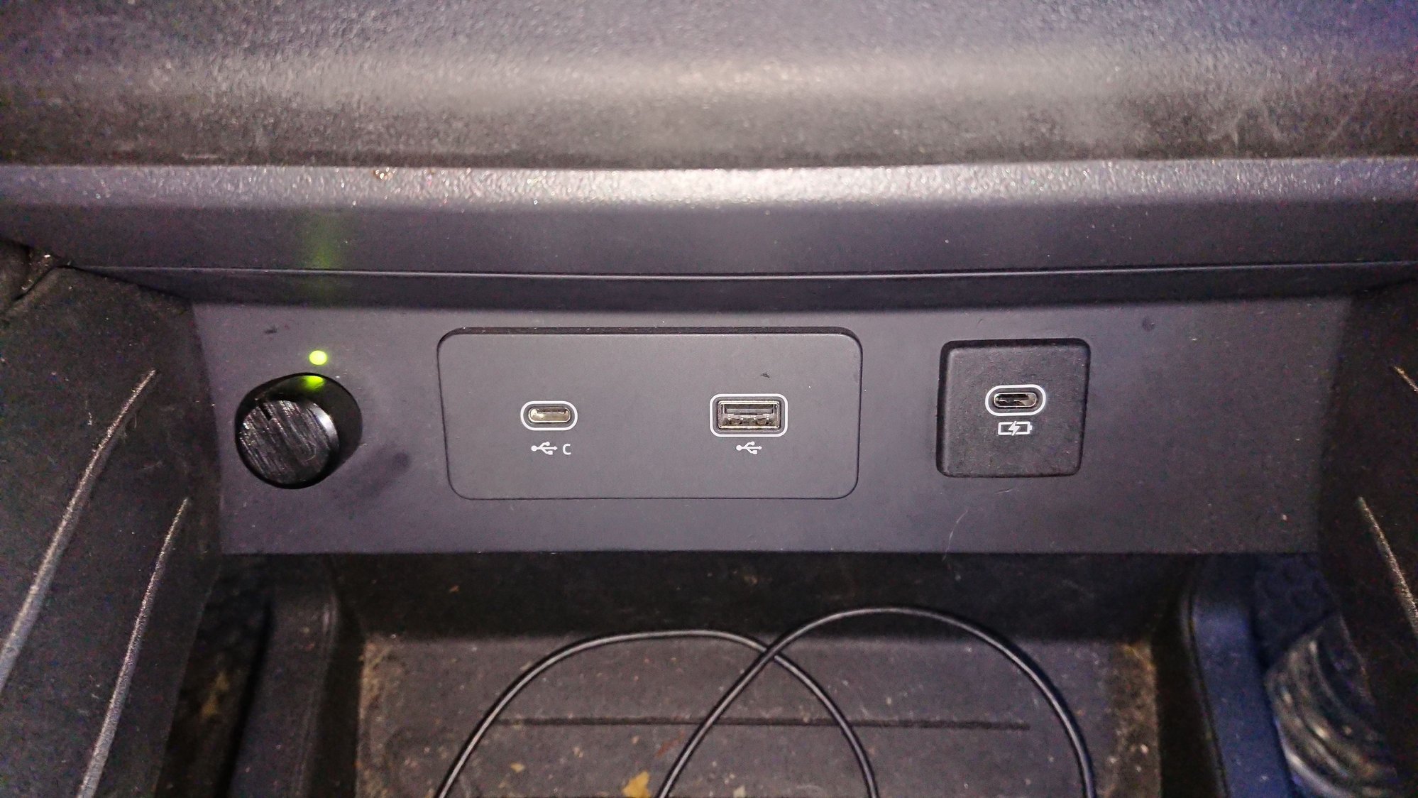

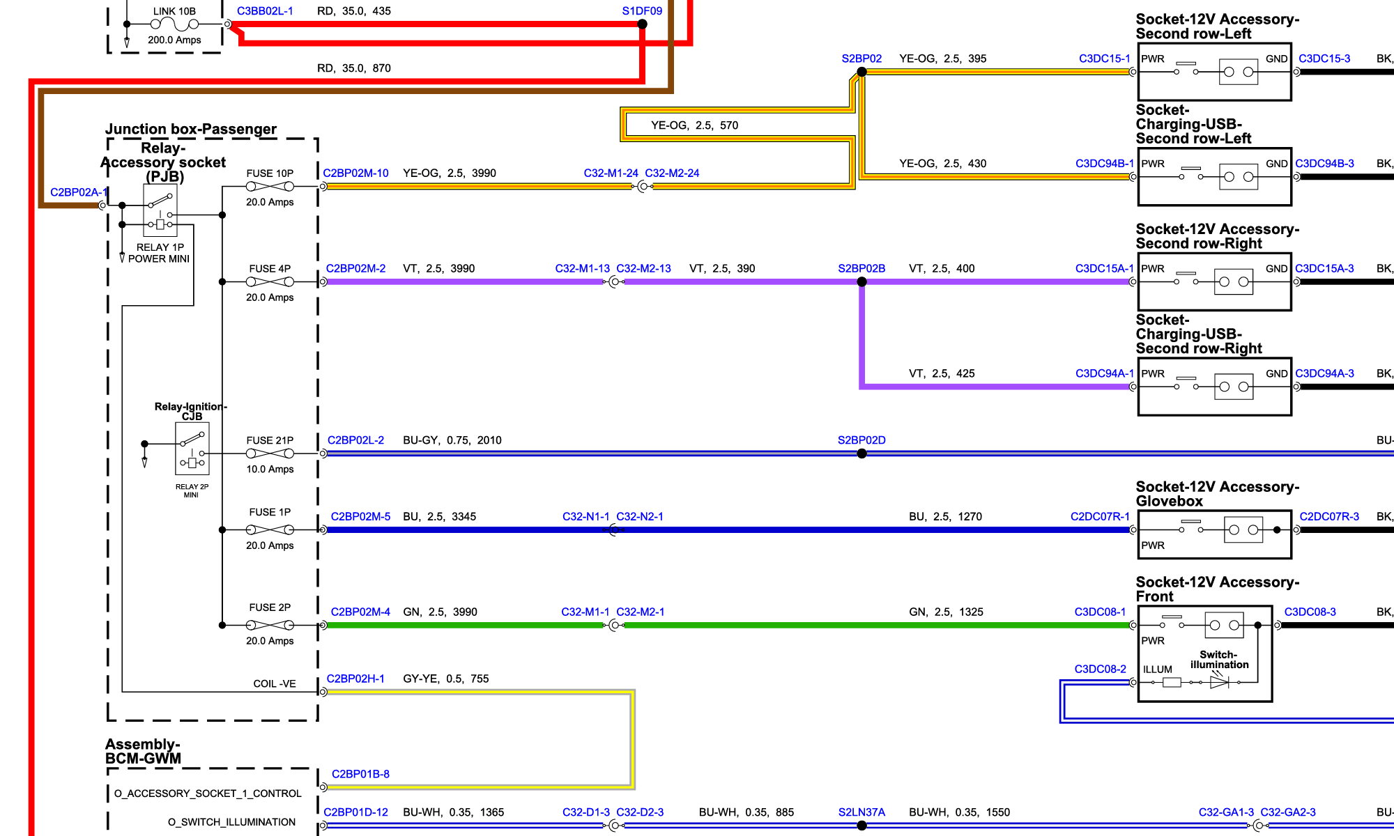

I did both in front. Just wired them direct after the Battery Monitor System 12v positive.
They are BCM controlled, so just cut that 12v + wire ( isolate) and connect your new 12v + always live.
No problems after 6 months.
Did also change the 12v cigarette lighter socket for an USB C . So on the dash tray USB A always live and on the console USB C always live.
In the cargo my Cigarette lighter socket is also always live, wired the same.
