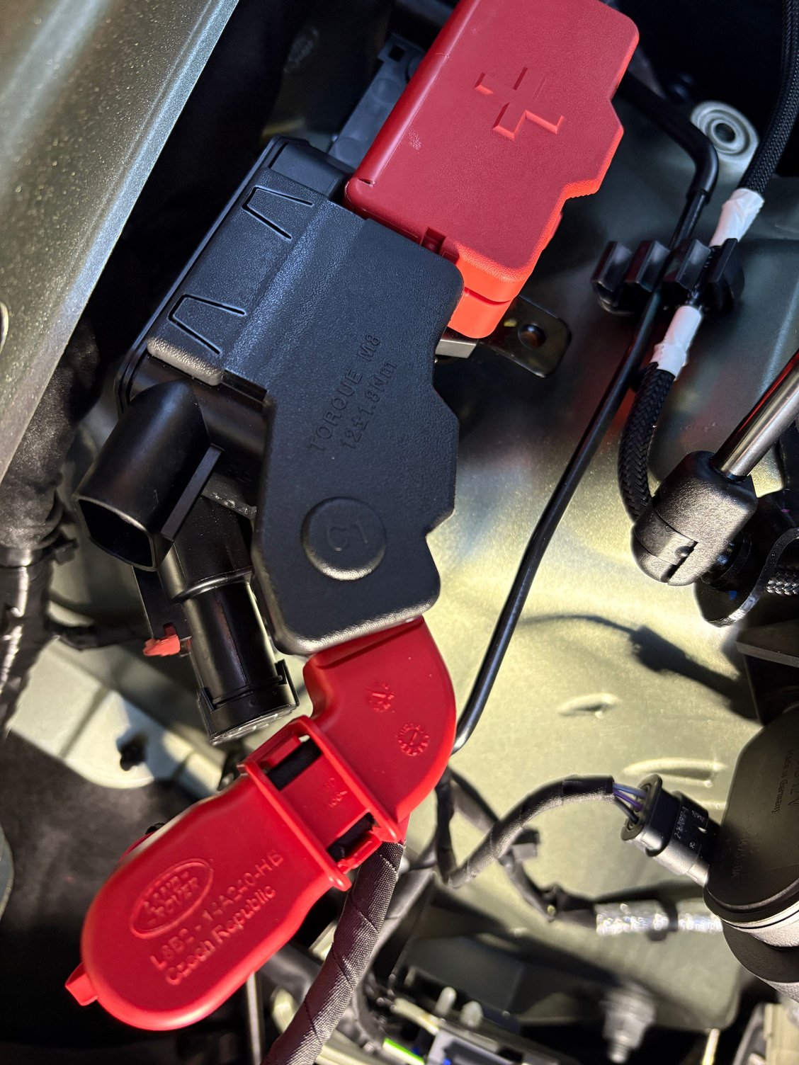

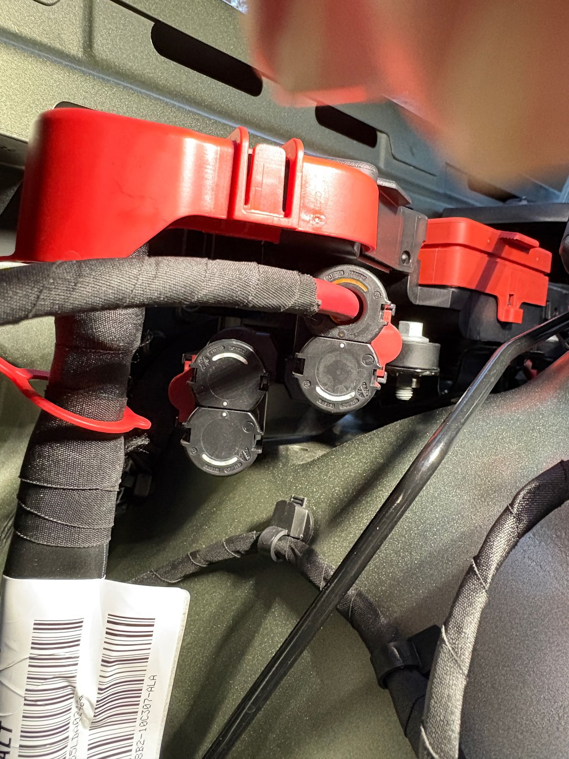

I am looking to install an Anderson SB50 power harness to our 2025 Land Rover Defender 110. It is a P400 mild hybrid. We had a look around the vehicle and spotted an electrical hookup in the engine bay. See pictures. I would then run the cable down and underneath the covers to the rear of the vehicle and pick up the negative earth there. This is to plug in a camper and charge the batteries on the road. I have seen multiple ways of doing this. Some take the power from the battery under the seat, I have read about folks taking power from the 48V hybrid battery. The camper will take both.
I would be interested if anyone has done this. Land Rover dealer does not and will not help.........mumbled something about a warranty.
Any advice on how best to do this or identification of the plug so I can purchase one would be greatly appreciated! Thank you.
Battery terminals left side under bonnet
Connectors.  One used and one spare.  Is this to hook up a winch?  Land Rover dealer did not know what this was for.

So I took power from the 48vdc to 12vdc converter under the rear load space. Added a relay so that power isn't always live. I also moved the trailer connector to the flat area near the license plate. See this Thread and this.
