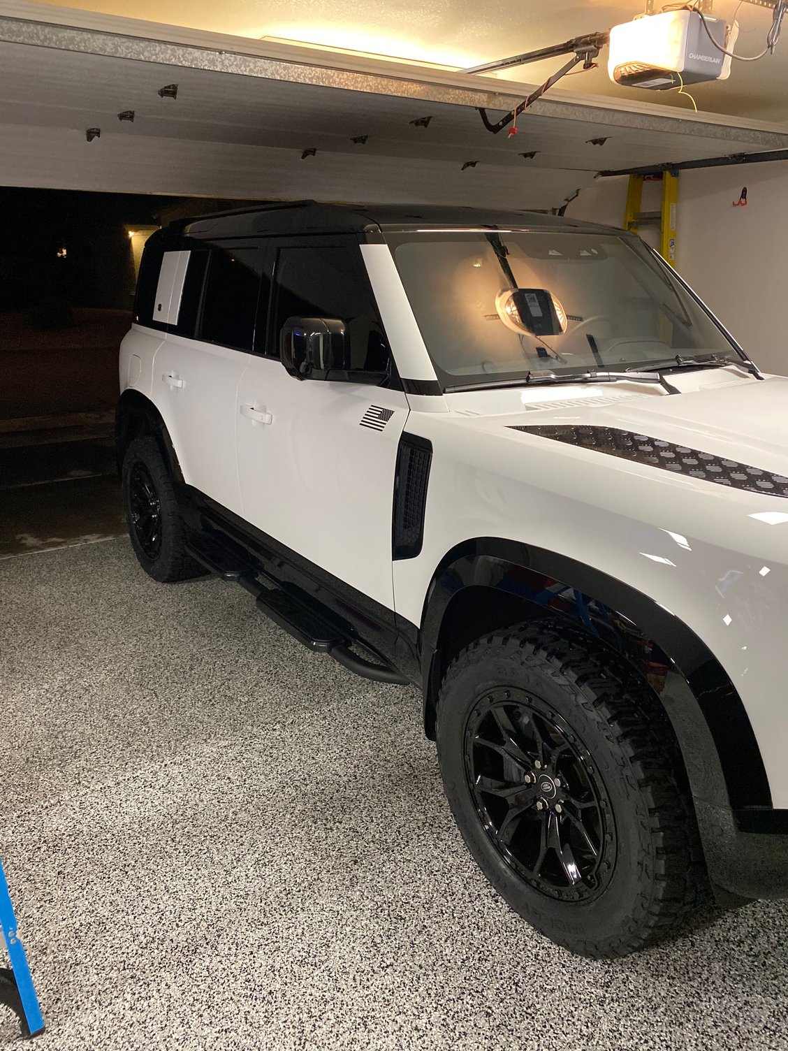

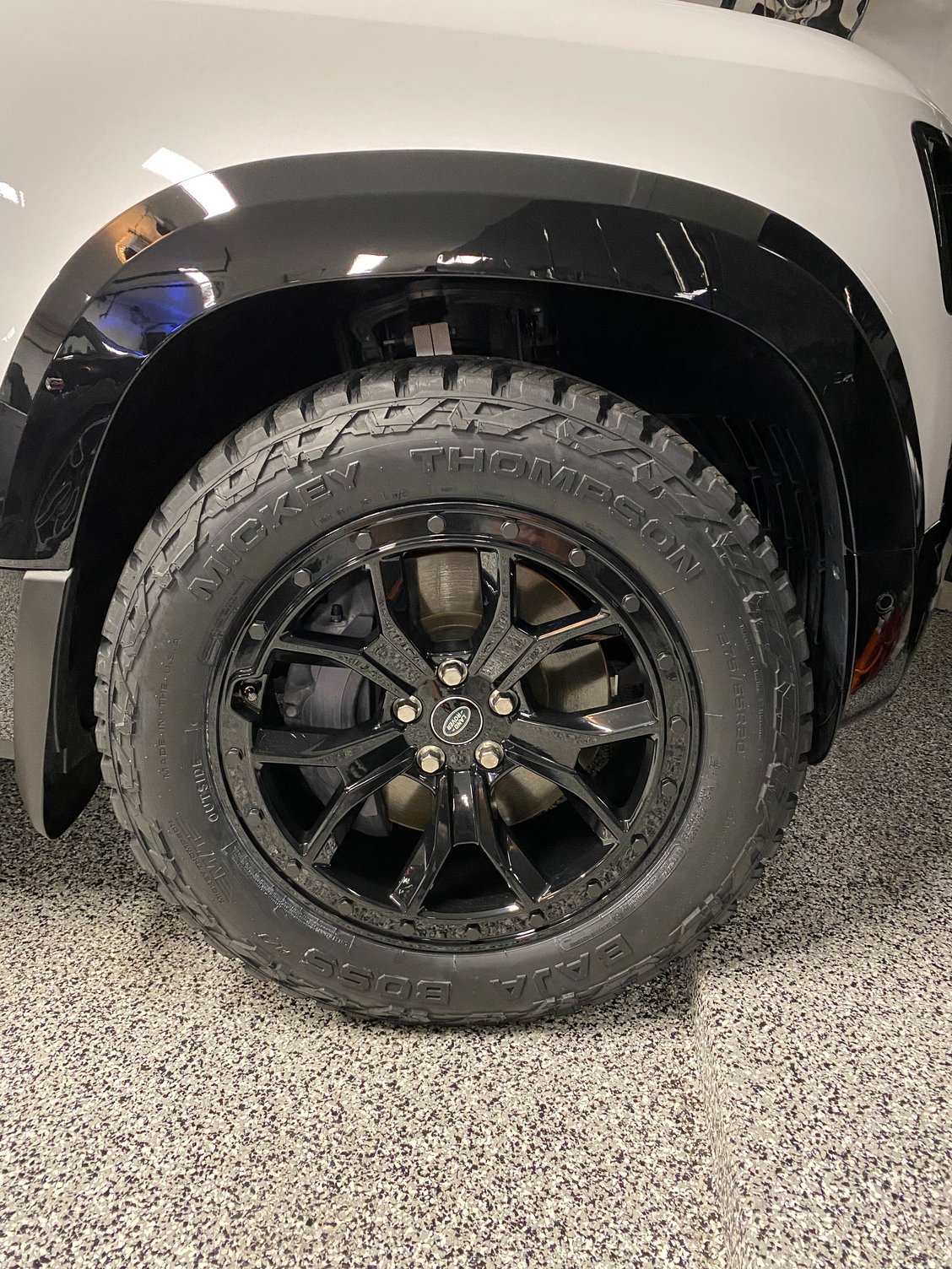

For what it’s worth, I have 20s but also have a set of OEM 18” steelies. Stock tire on that wheel from LR is 255/70-18. I tried a 275/70–18 and it rubbed terribly, in access/normal/lifted heights, with and without 30mm spacers, with and without 1.5” lift rods. Plus, it looked too big to my eye (see picture.)
Sold those and went with OEM size, but in an aggressive tread (this is my actual off-roading tire set.) Even though they are the OEM nominal size (255/70-18), they measure out to exactly 1/2” taller than my OEM set of 20” tires. They fit (without lift or spacers) but I wouldn’t want to even have 265/70 because it’s that close. There is just not very much room built into that wheelwell. JLR doesn’t seem to want you running bigger tires.
275/70:
It was 1” taller than OEM:
And here’s the 255/70 I settled on:

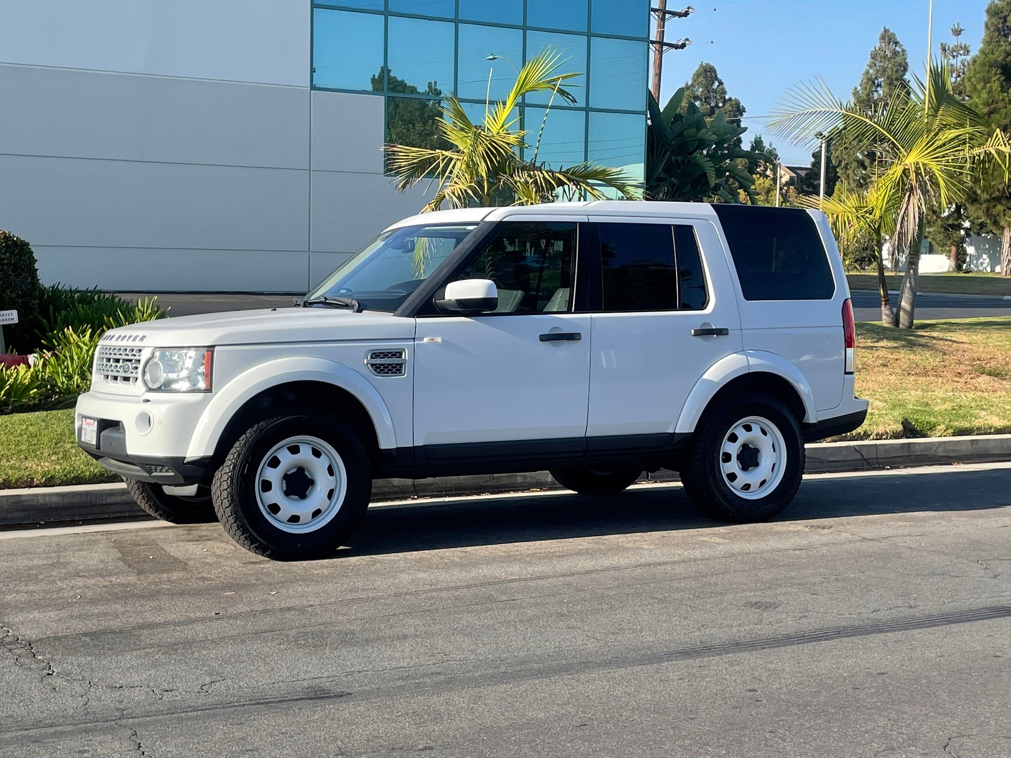

I’ve got the 255/70 R18 steel wheel/tire set up on my LR4. Those baby’s are tall,
that’s max lift with gap tool

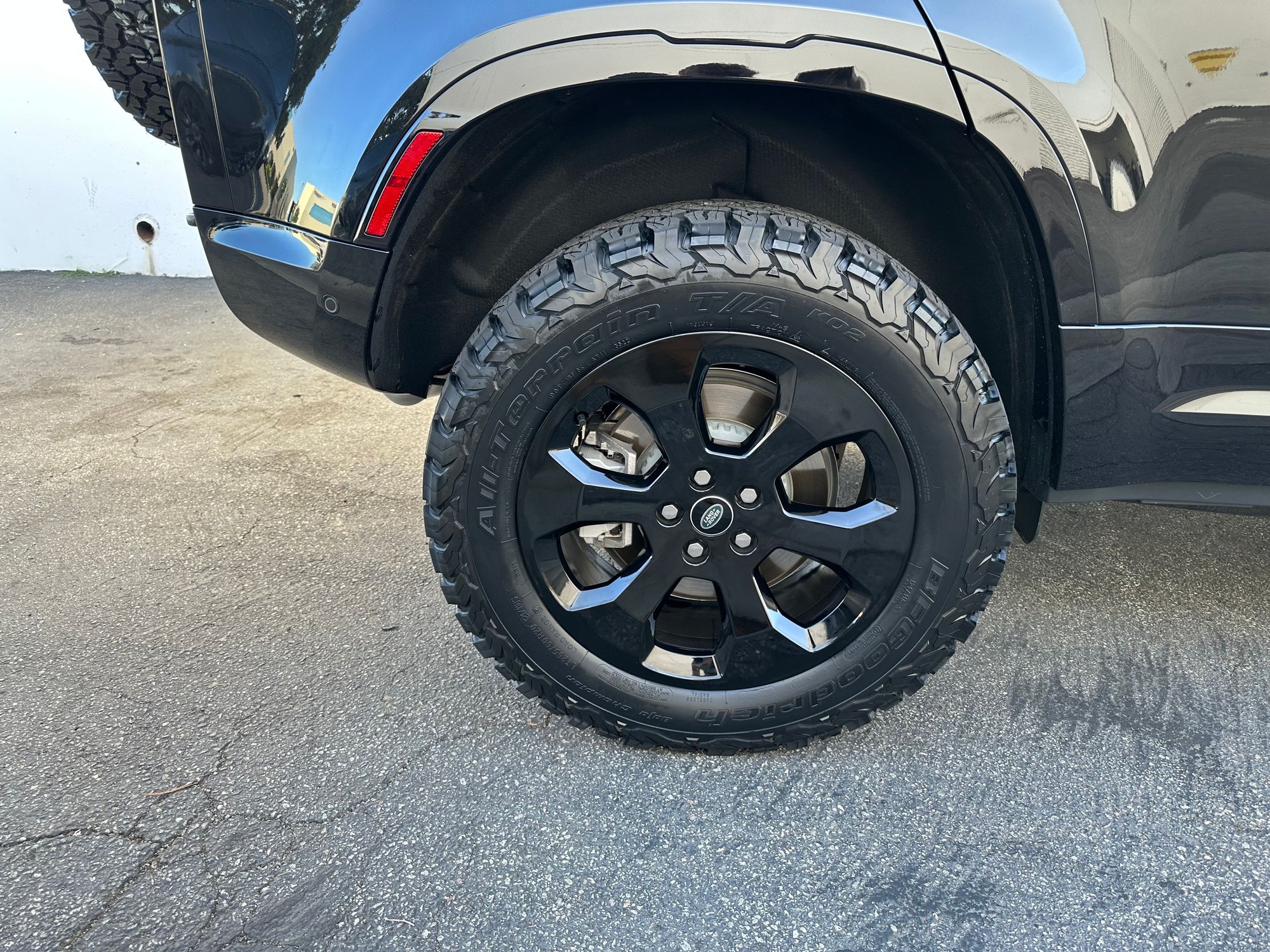

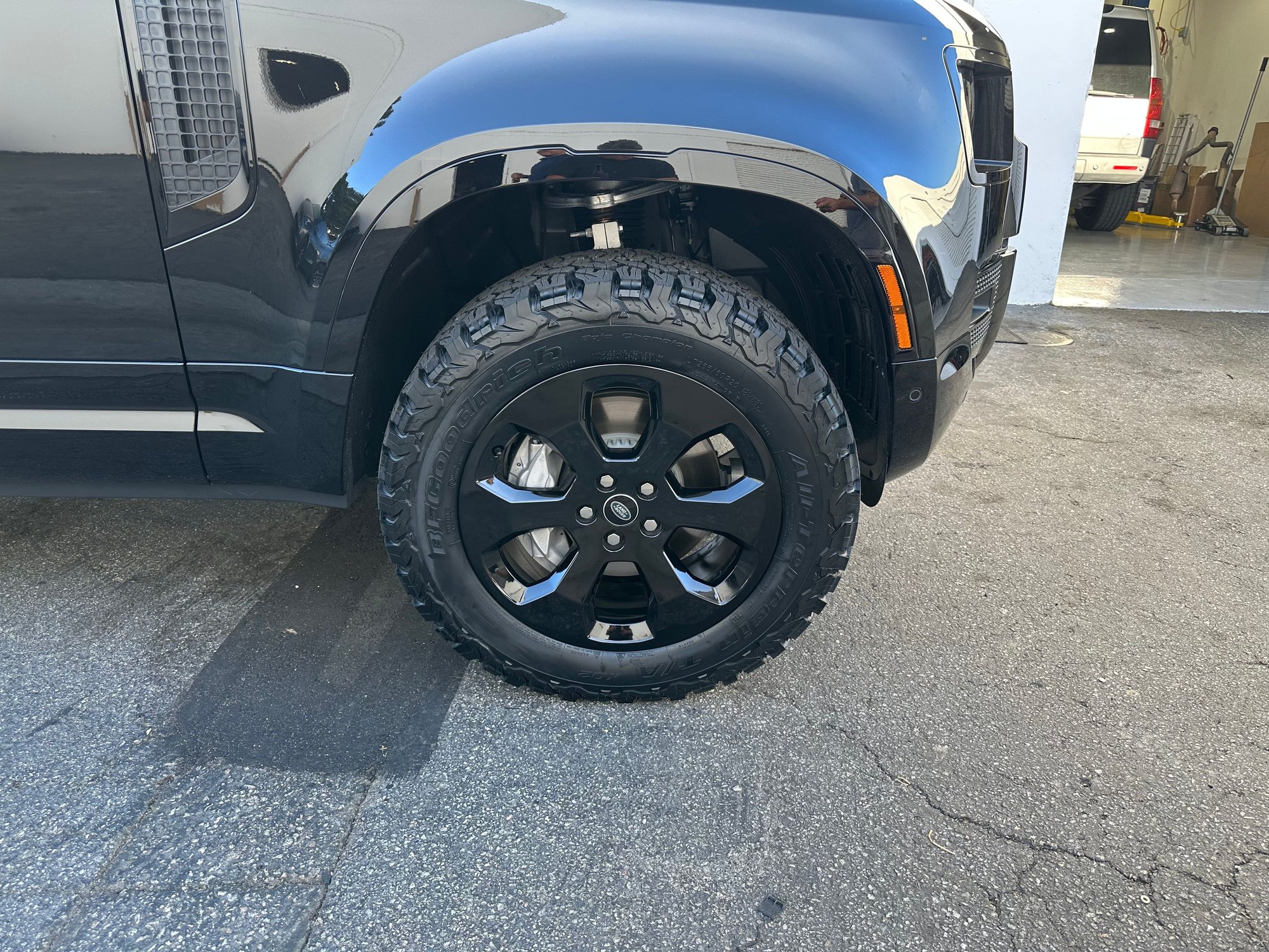

im trying 265/60 R20 BFG KO2 on this rig. It’s got a 2” lift. Should be picking up today so I’ll update with the rubbing situation.

so here are the 265/60 R20. No rubbing.
