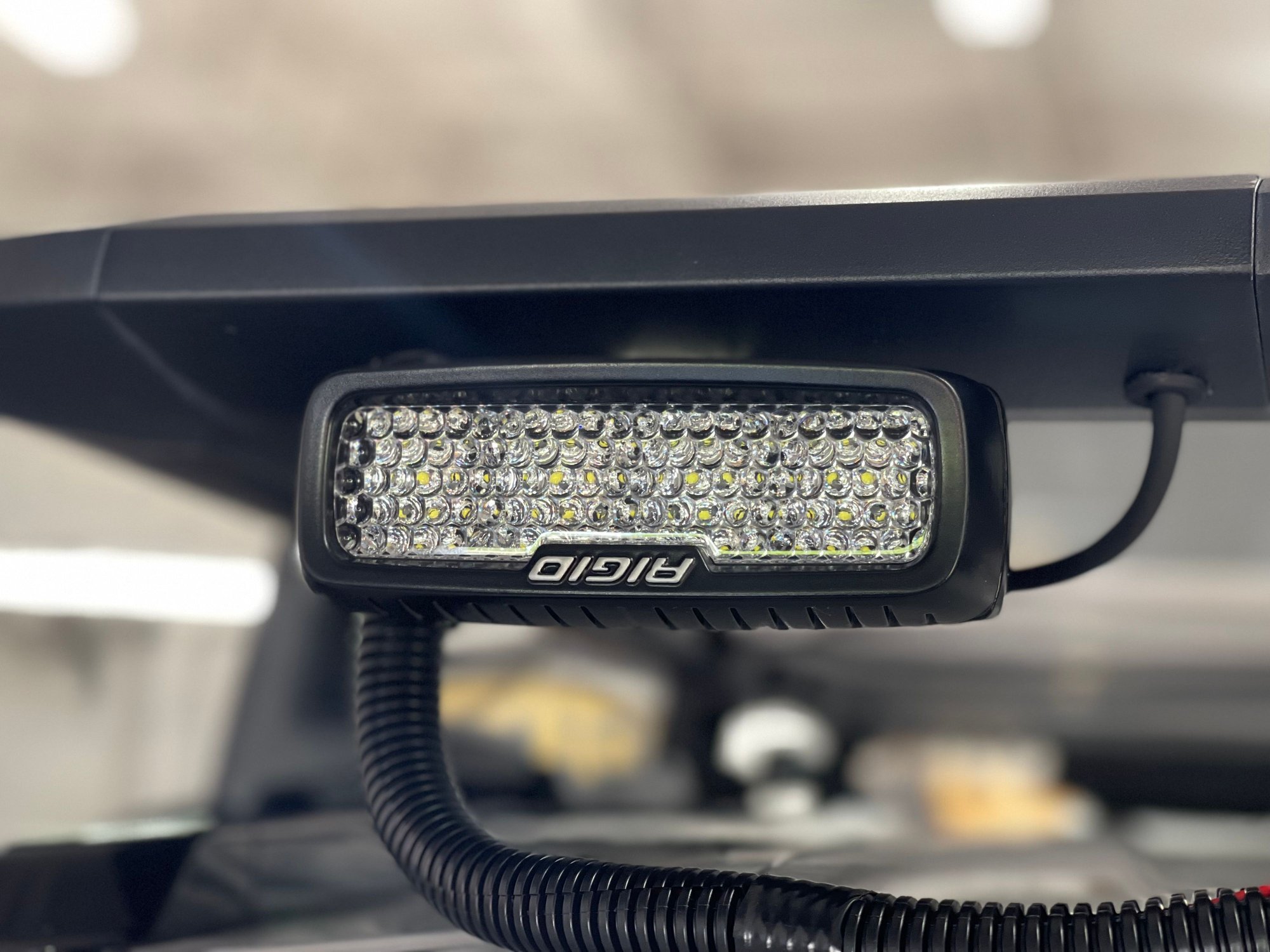

Default Rigid Rear lights
Here is a set of Rigid chase lights installed. Multiple color lights, strobe and reverse light integration. They fit really well under the rack.

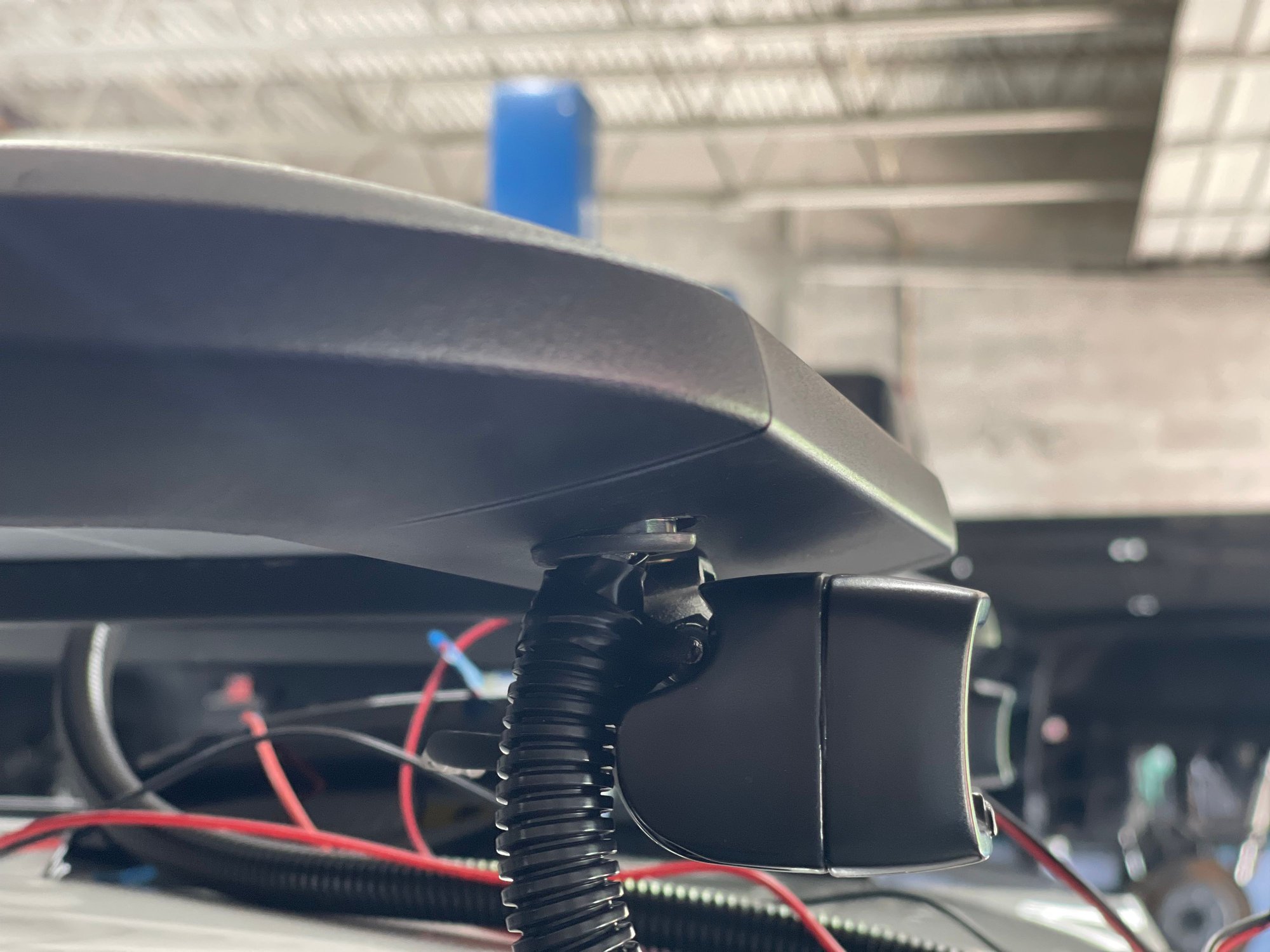

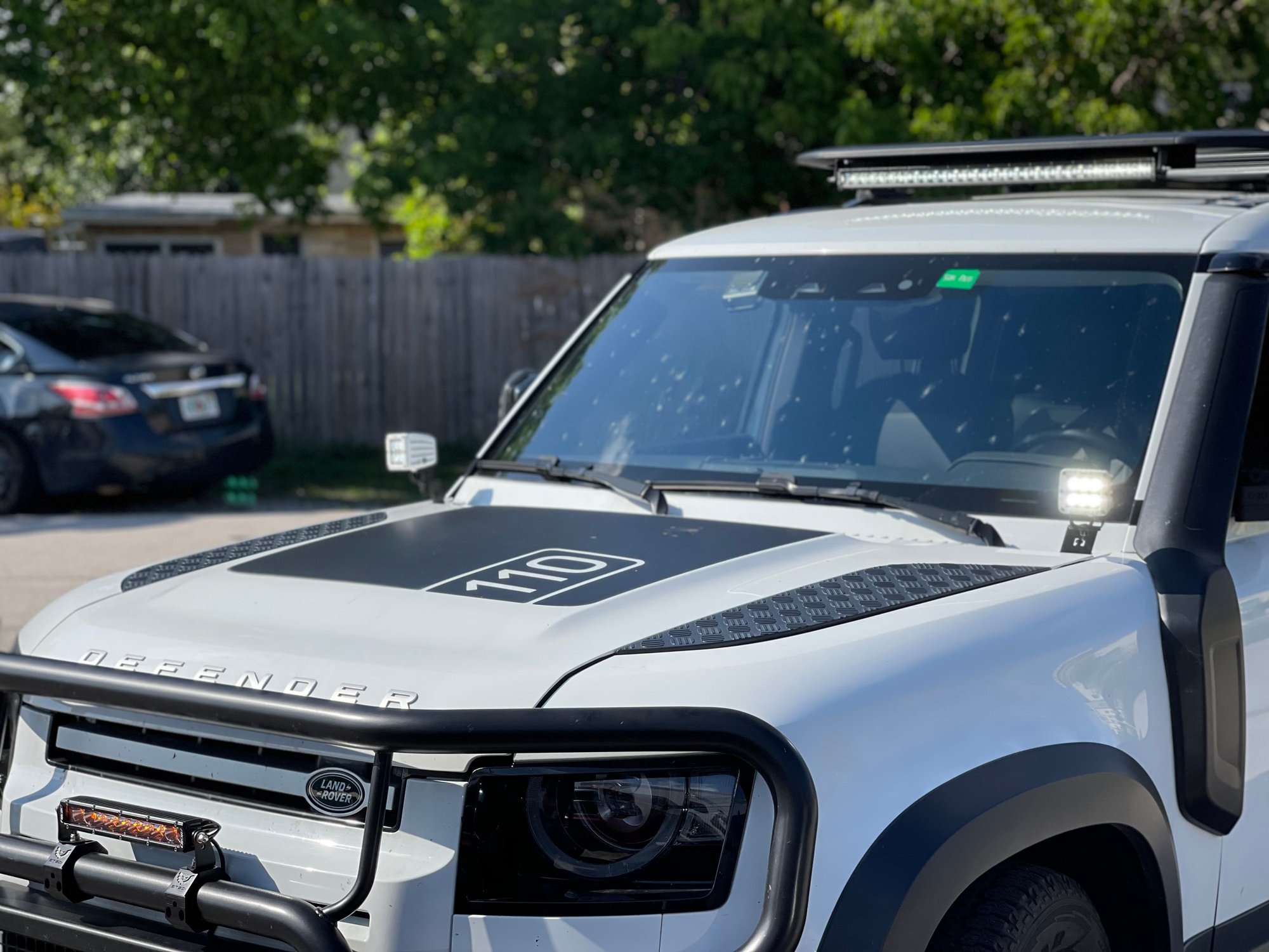

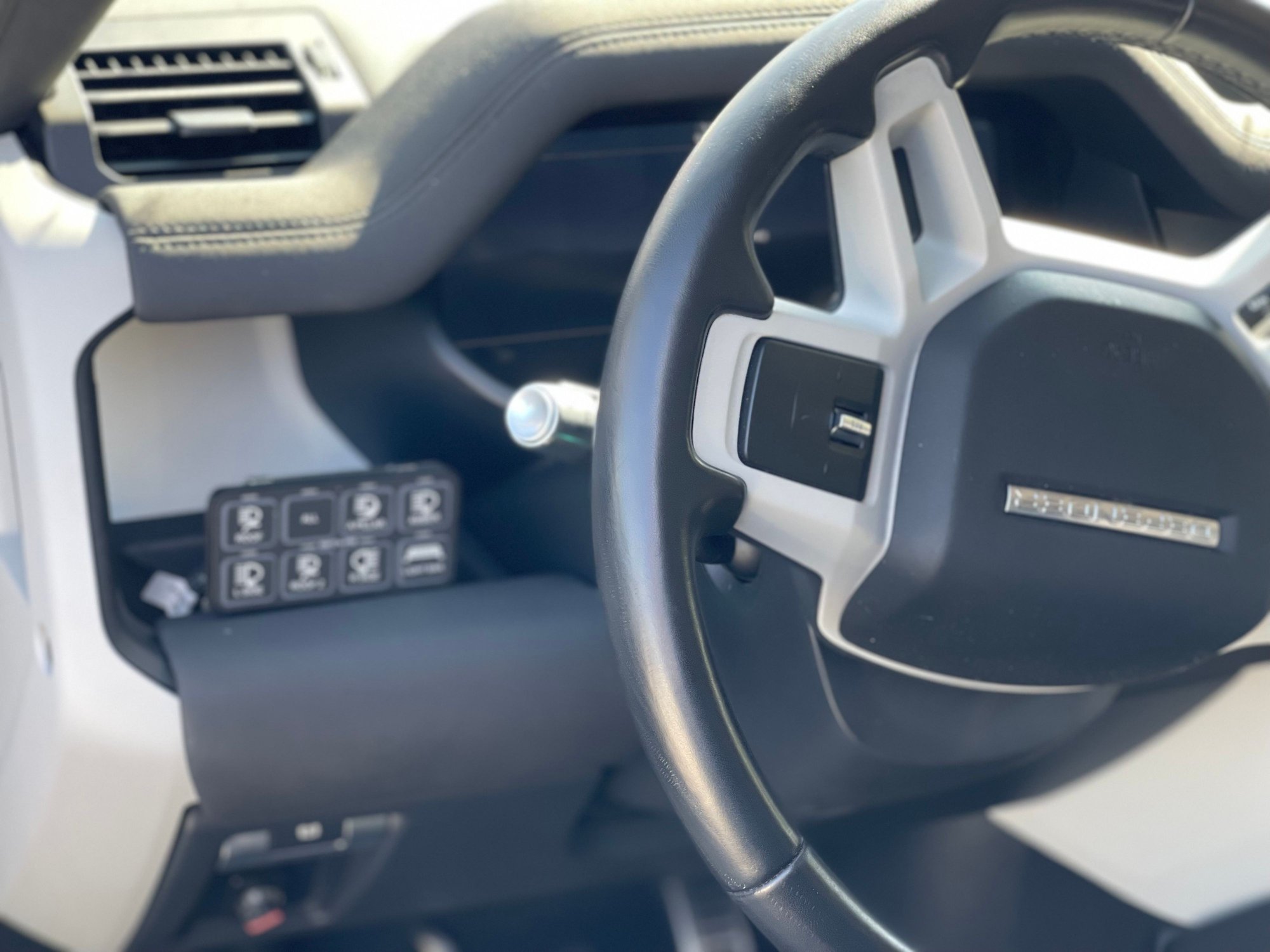

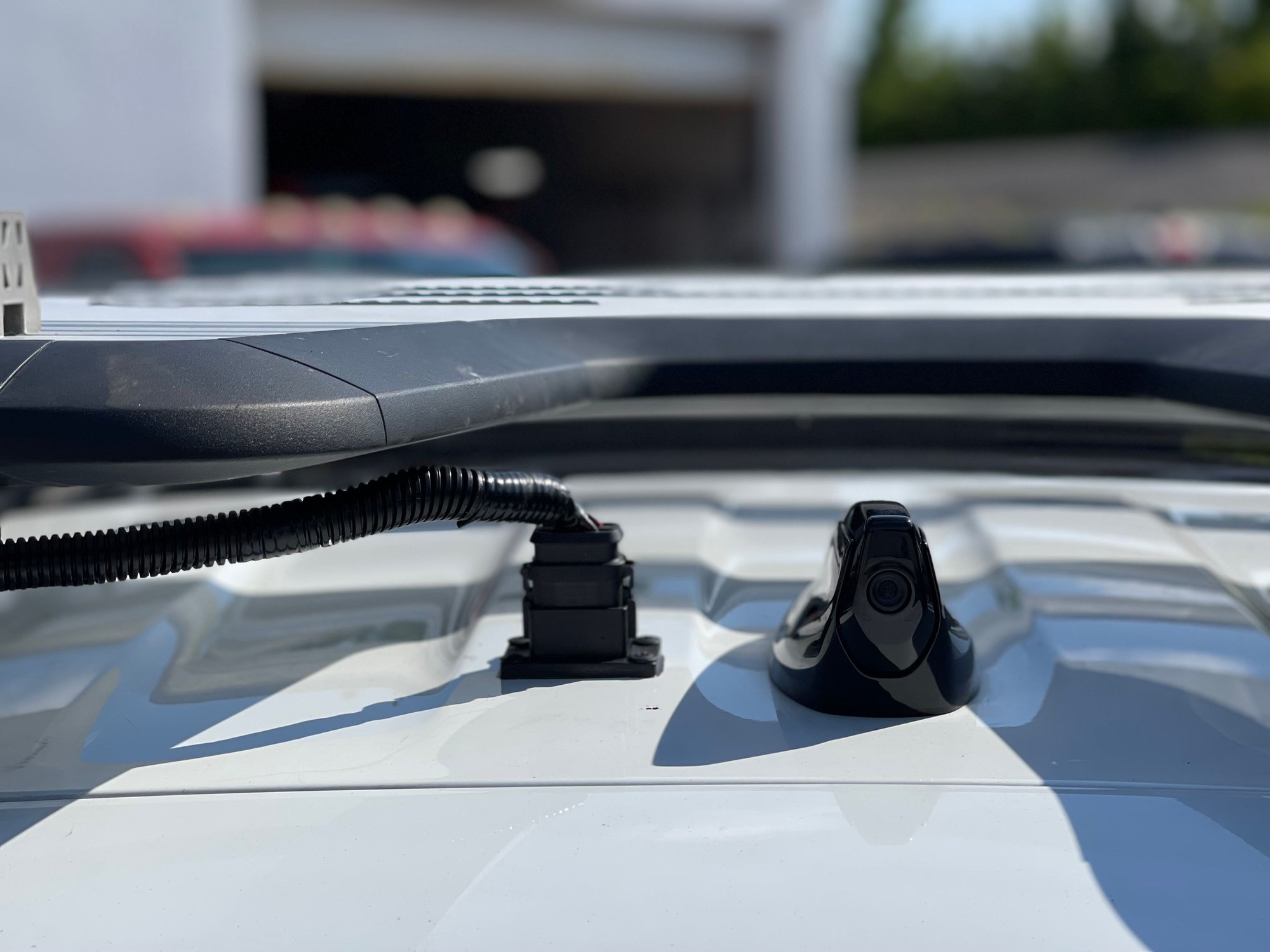

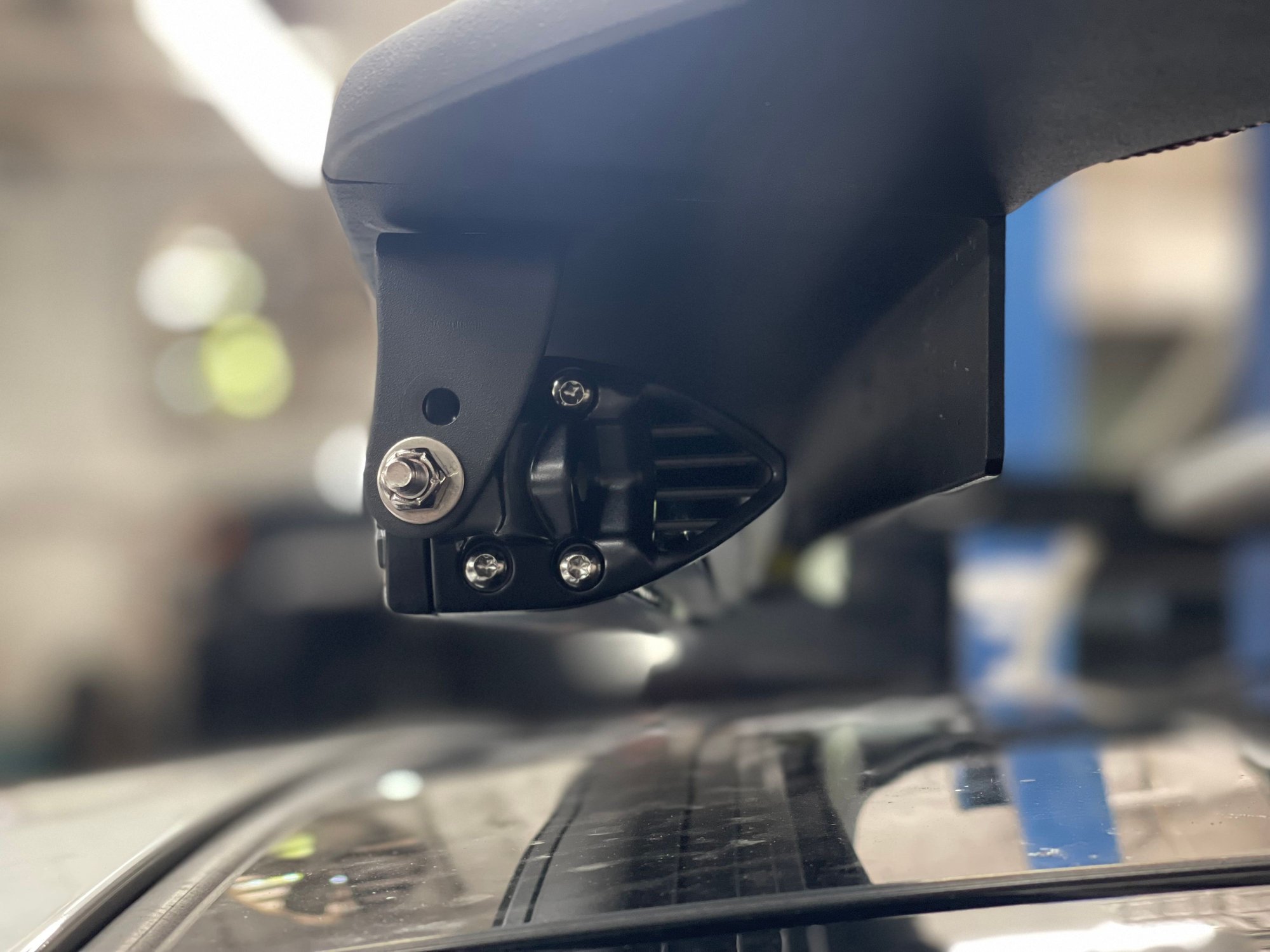

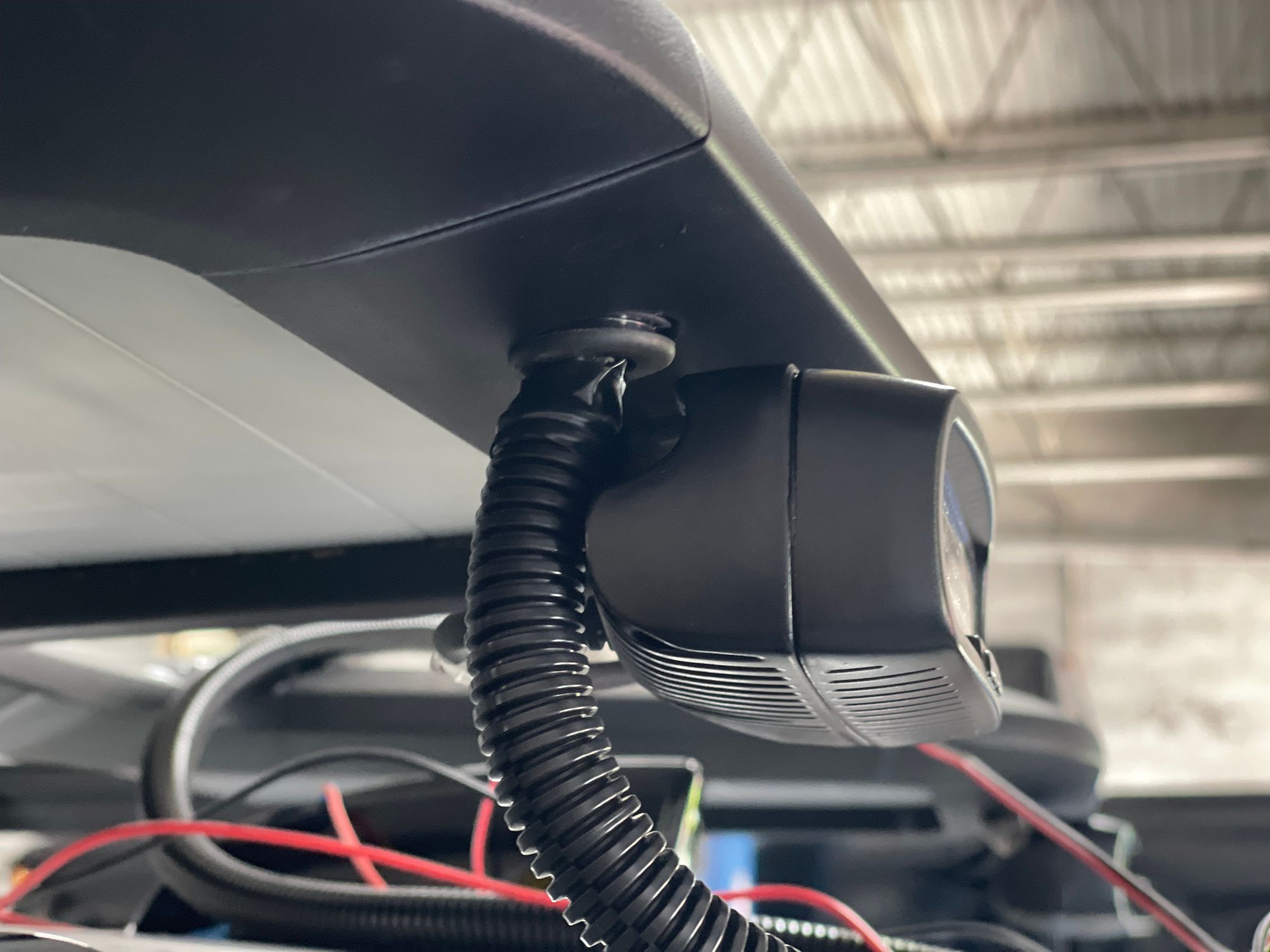

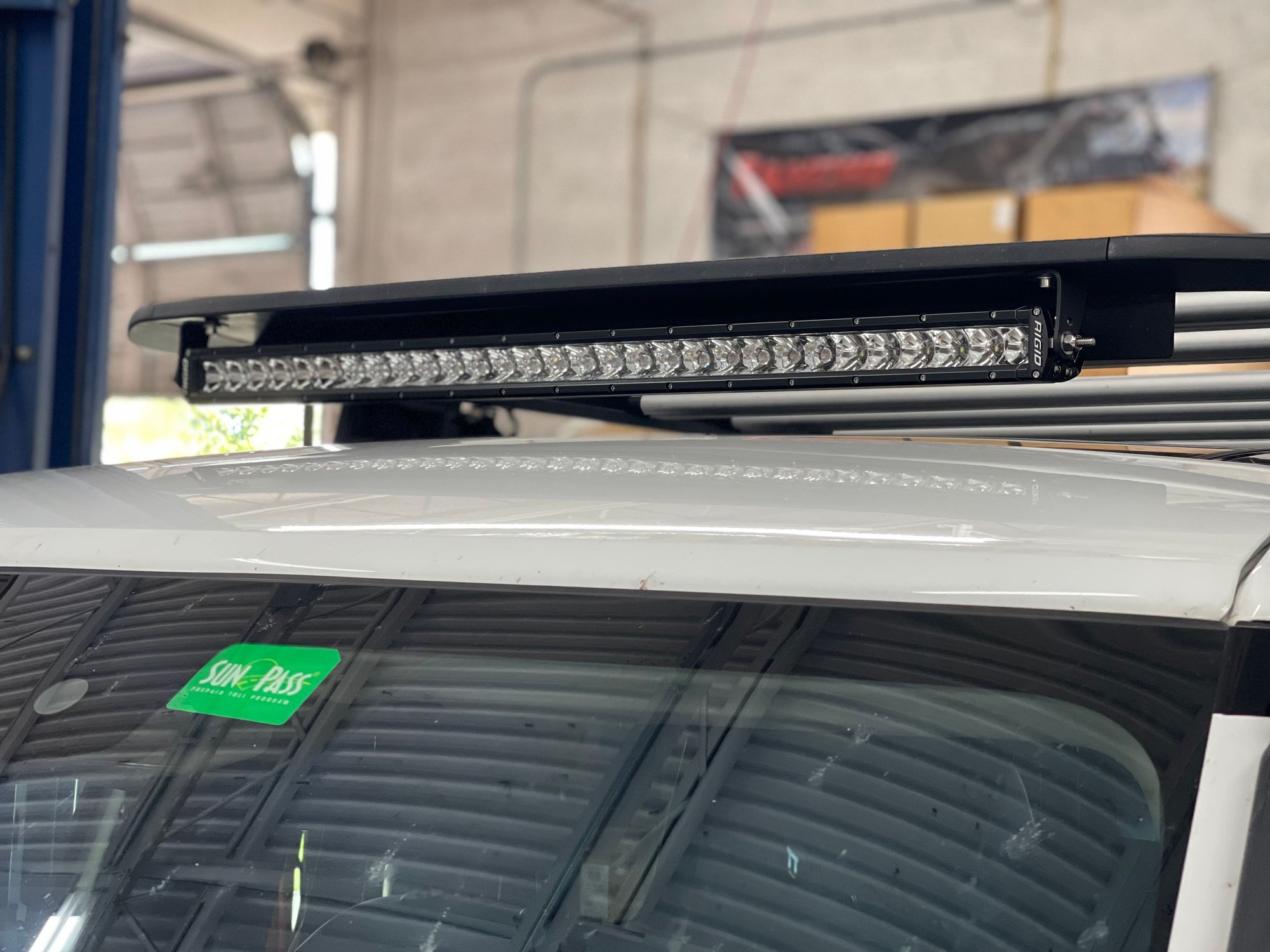

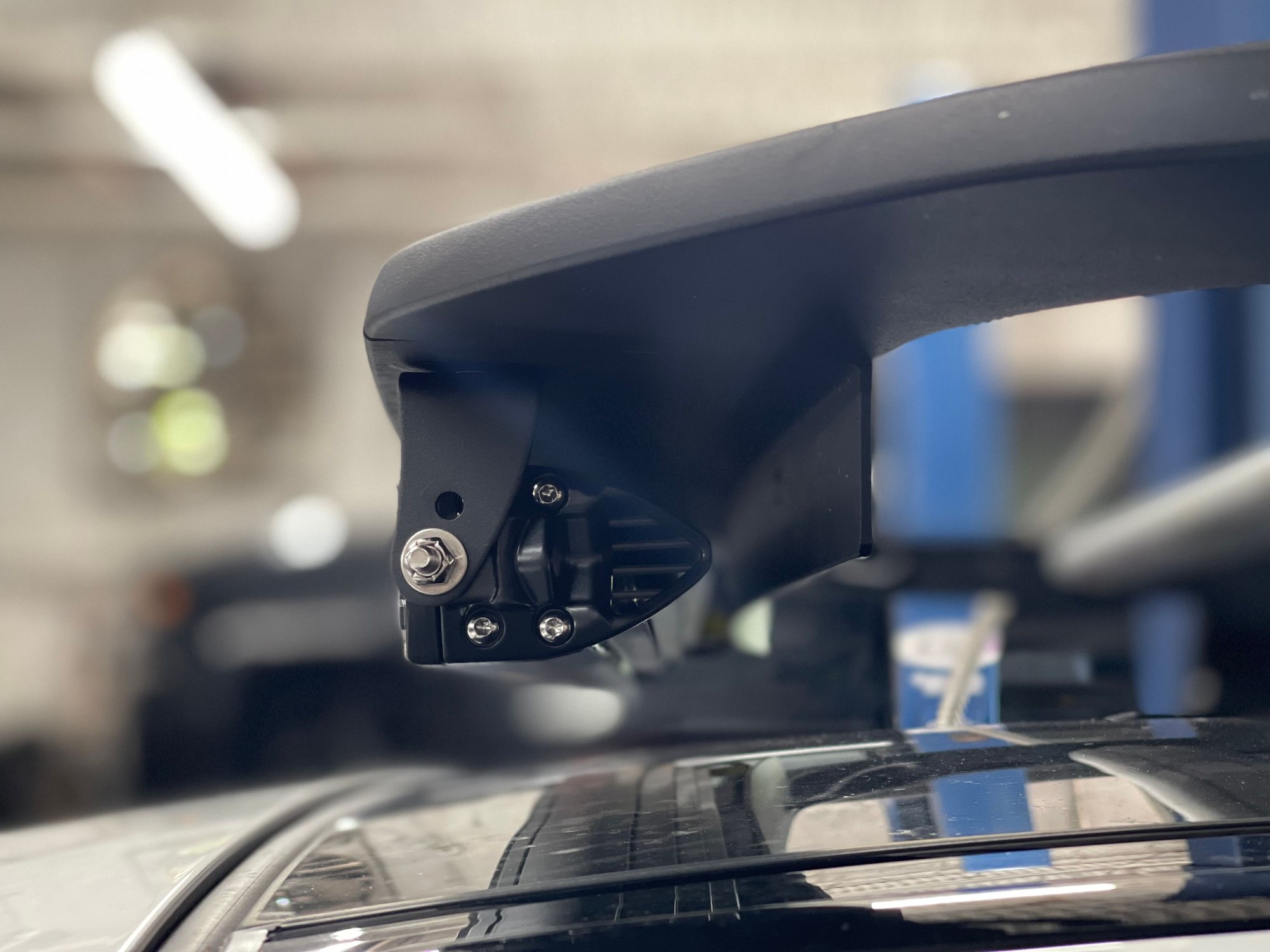

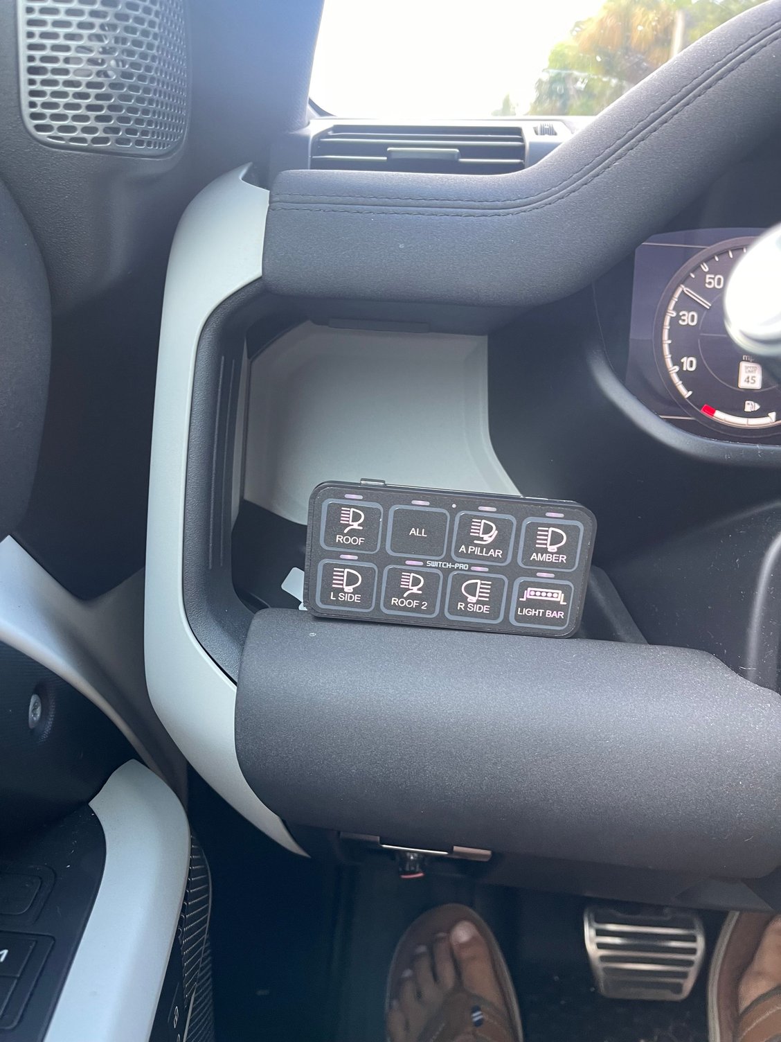

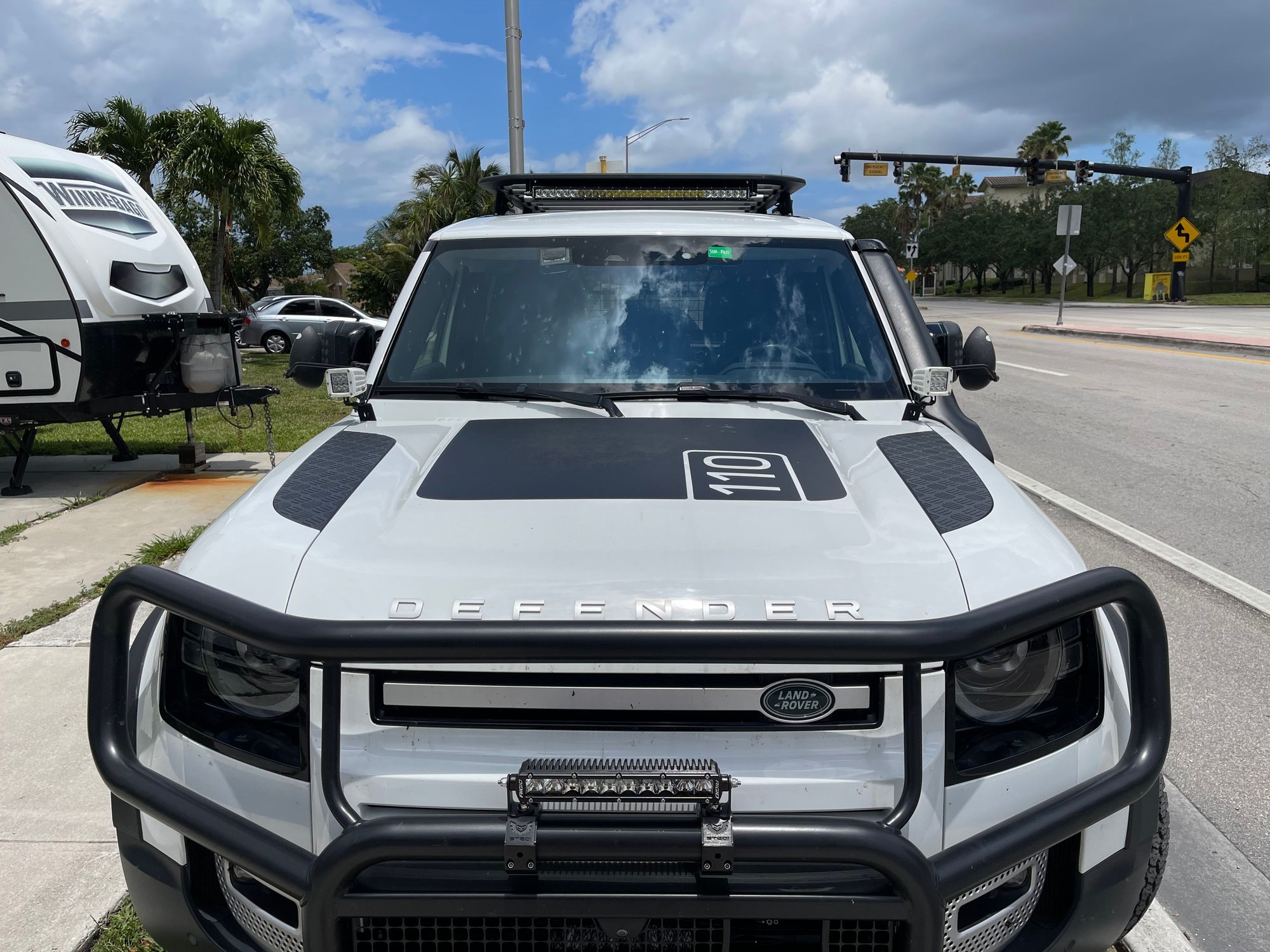

Hope this helps

VERY nice! Thanks. I'm thinking you routed up the a-pillar? How did that go? Got any shots (I'm sure you do....)

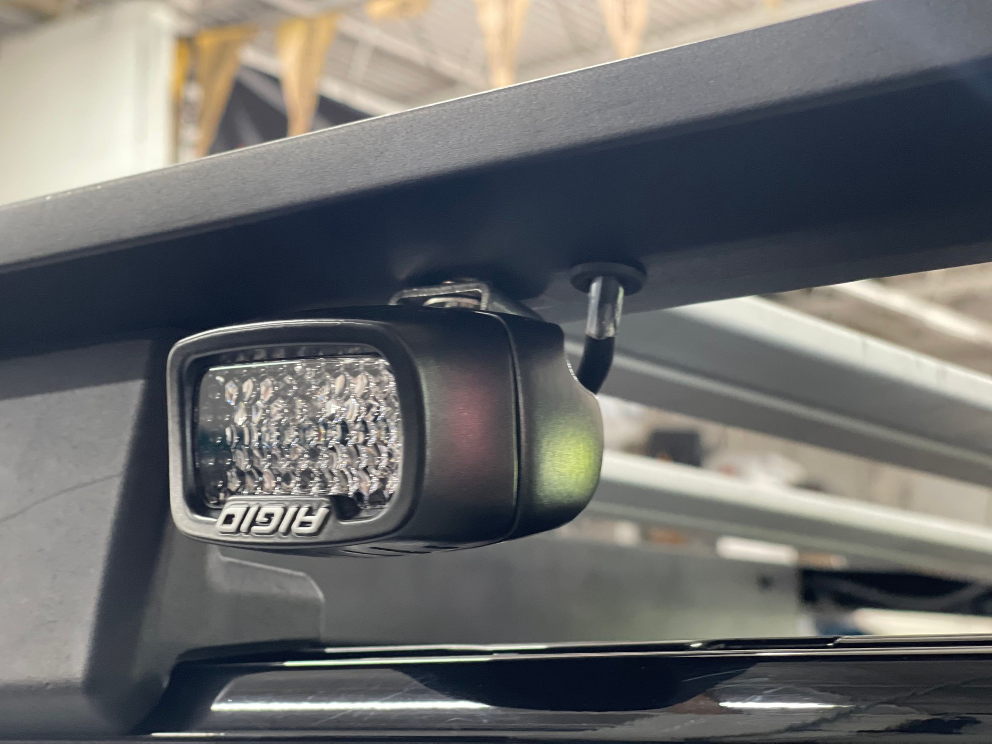

This is were the installer made a mistake. I asked them to use the rear plastic piece over the rear door and they went in through the roof. To say that I was more than livid with what they did is an understatement. I had shown them pictures and physically pointed out where I wanted to the cables installed And since the installer was doing multiple things on different vehicles “ he is the store manager” he forgot. I did get a lifetime warranty in writing from them. If I had any leaks, they would fix the damage of the interior and reseal everything for the life of the vehicle. And I plan to keep it for at least 20 years. The peace right in front of the camera and the Deutsche connector is plastic, and there is several different size grommets that you can use to power in through there and still keep the shell waterproof. I cannot take credit for this idea. I got it from a mate in Australia. His name is Anthony Palmer.

Wow! I can quite imagine your anguish on that. I would have done the same. Kudos to them for the "warranty". That would definitely make me a bit more acceptant (as long as they were in business). For some weird reason, doing that thru the D-pillar would be totally ok for me, not the roof. I appreciate the insights, but for obvious reasons I'll stay away from that approach<g>. My warranty isn't worth sasquatch.
