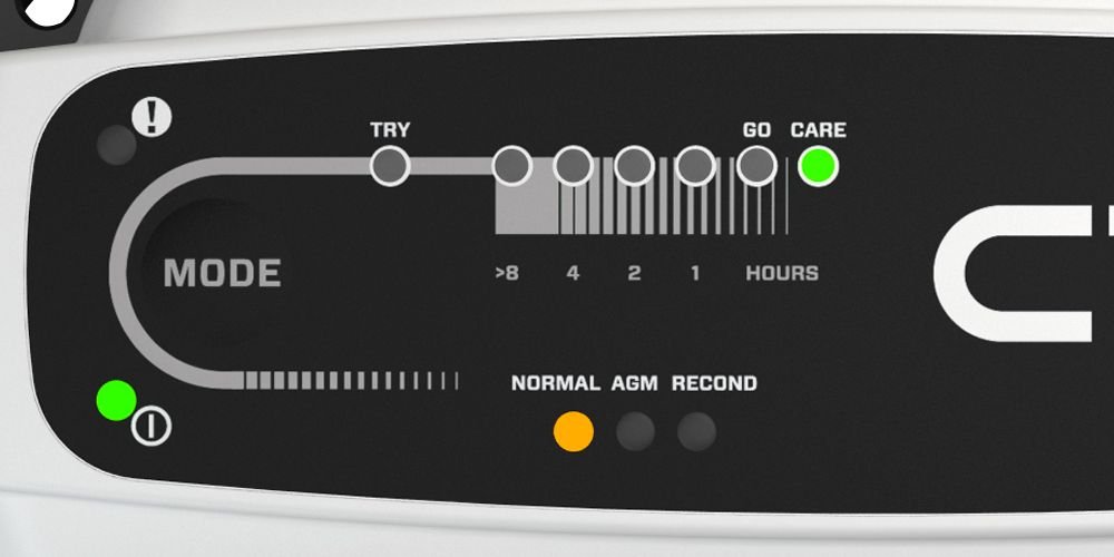

My Ctek Time-To-Go charger failed on first night during overnight charge (my battery was completely dead). But after driving a couple of hours after jump start next day, It charged fully.
This model shows general idea of how many hours I need.
https://www.ctek.com/us/battery-char...1qECIizMm413-w
Oh, and I used AGM setting as that's what we have from LR. (this image is directly from Ctek website).

i have been charging on the ctek for more than 8 hours and came back and it failed stopped on step 2. jumped it with another car and it took a little to get the car to start.
i am noob in electronics so pardon my noob questions. so is my battery completely dead and need a replacement or so drained that i needed a jump and maybe it it can charge now?
i might replace the battery to avoid bigger issues. looks like you need to remove the front seat to fully access the battery?

It might charge if you drive it for a while and then try to charge it again.
Odds are it’s going to need to be replaced.
Seat just needs to go all the way forward and up and you can access the battery under the seat without removing it fully.

Charging time depends on the amperage of the charger. Once charged it will shift to maintainer role.

Same battery with same charger, Ctek failed charing when it was from complete dead. Then jump starter + driving to charge batter then connecting Ctek, made it fully charged. So you may want to drive to charge some then Ctek may charge properly.
