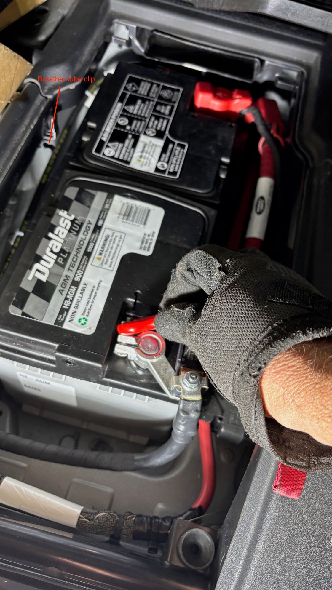

6. Removed the negative terminal. I used an insulated Knipex 10mm open wrench.
7. Removed the positive terminal.
8. Taped the cable terminals and tied them to the seat bracket out of the way of the battery.
9. Used the plastic terminal covers from the new battery to cover the terminals on the old battery.

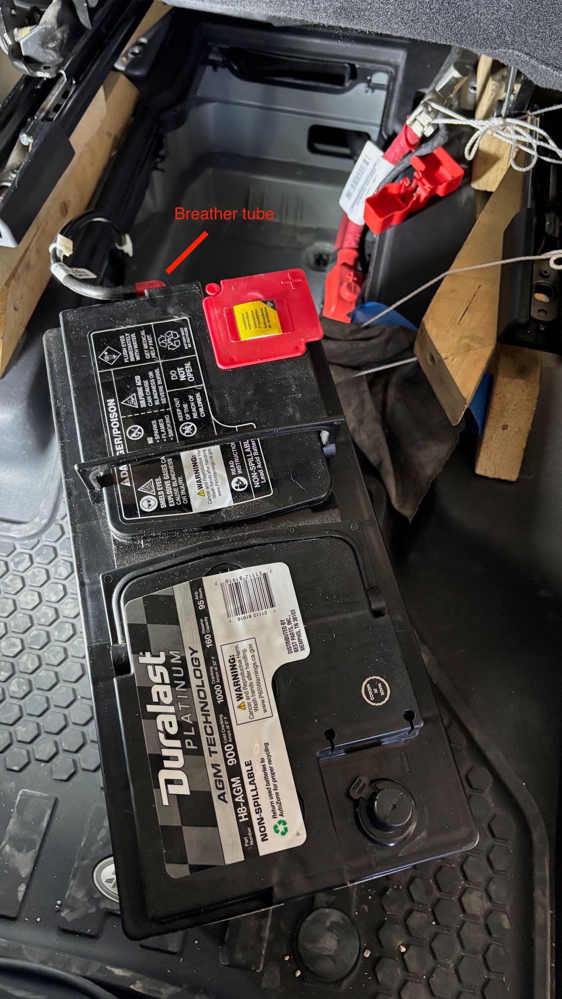

10. Disconnected the breather tube from its middle clip.
11. Removed the bracket securing the battery (two 10mm hex bolts). I wrapped the tools in tape - just in case.
12. Lifted out the battery onto the rear passenger footwell.
13. Removed the breather tube and removed the battery from the car.

15. Put the new battery onto the rear passenger footwell and connected the breather tube to the positive side vent hole. (Note: the Duralast has a vent holes on both ends. There's a plug attached to the red plastic positive cover that comes with battery. Remove the plug and insert into the negative side vent hole.)

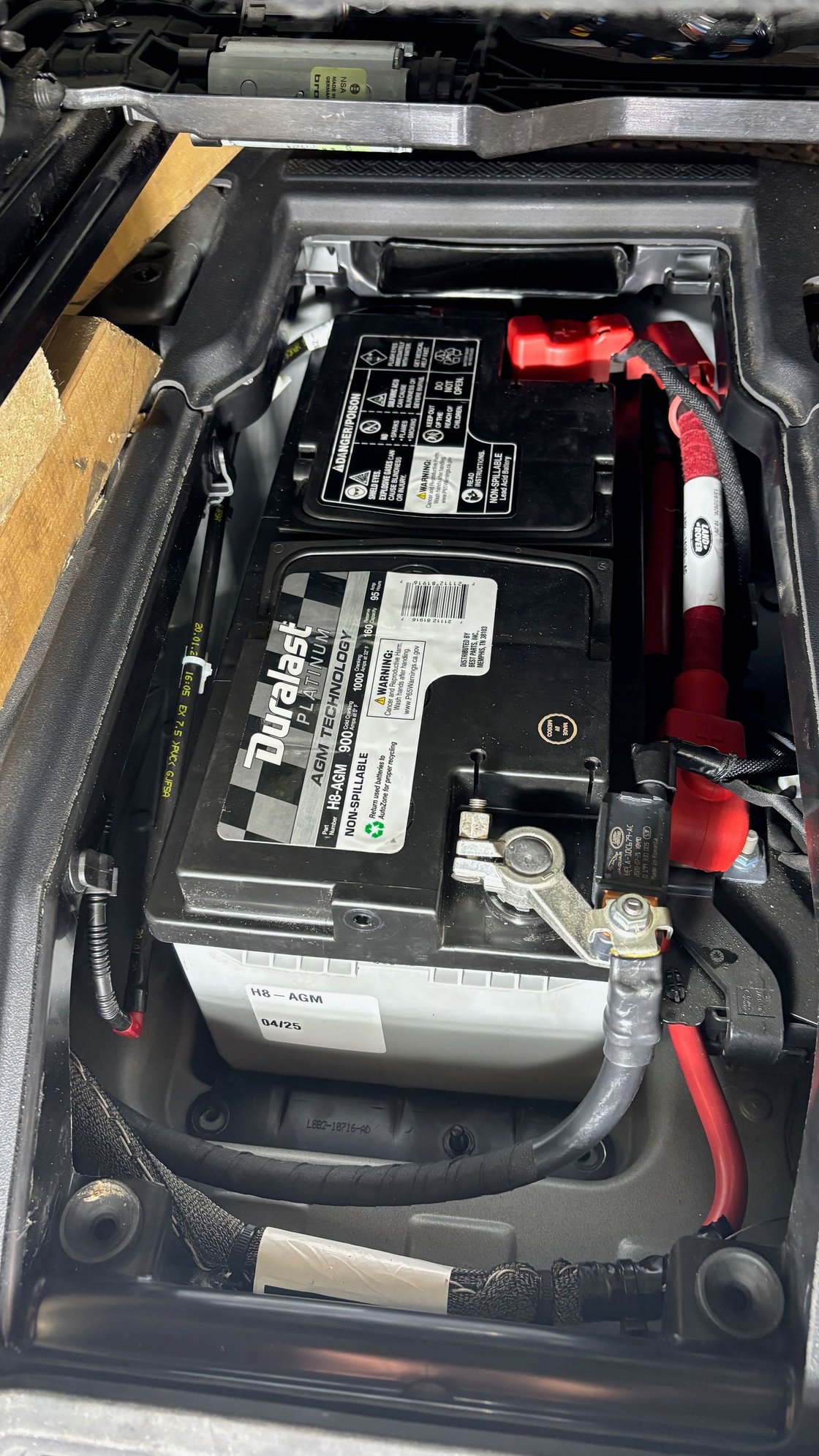

16. Lifted the battery in and connected the positive then negative terminals.
17. Connected the breather tube to its connector.
18. Refitted the bracket.

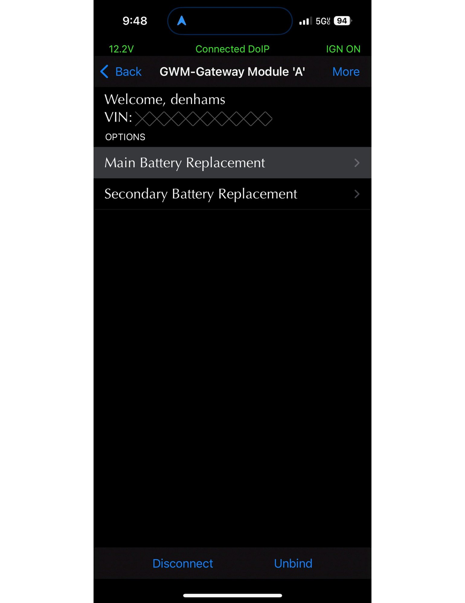

21. Started the car. Ran the Gap fault check. Ran Gap battery replacement routine (Service Test - Gateway Module).
