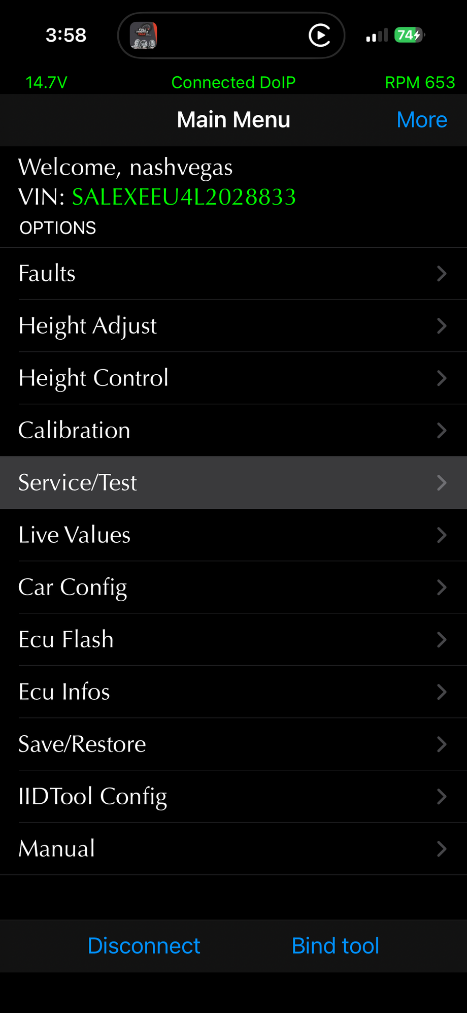

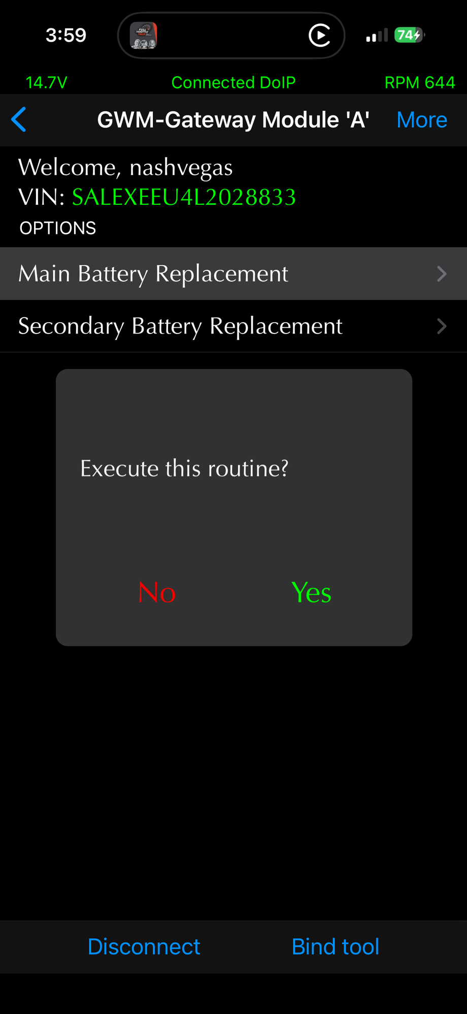

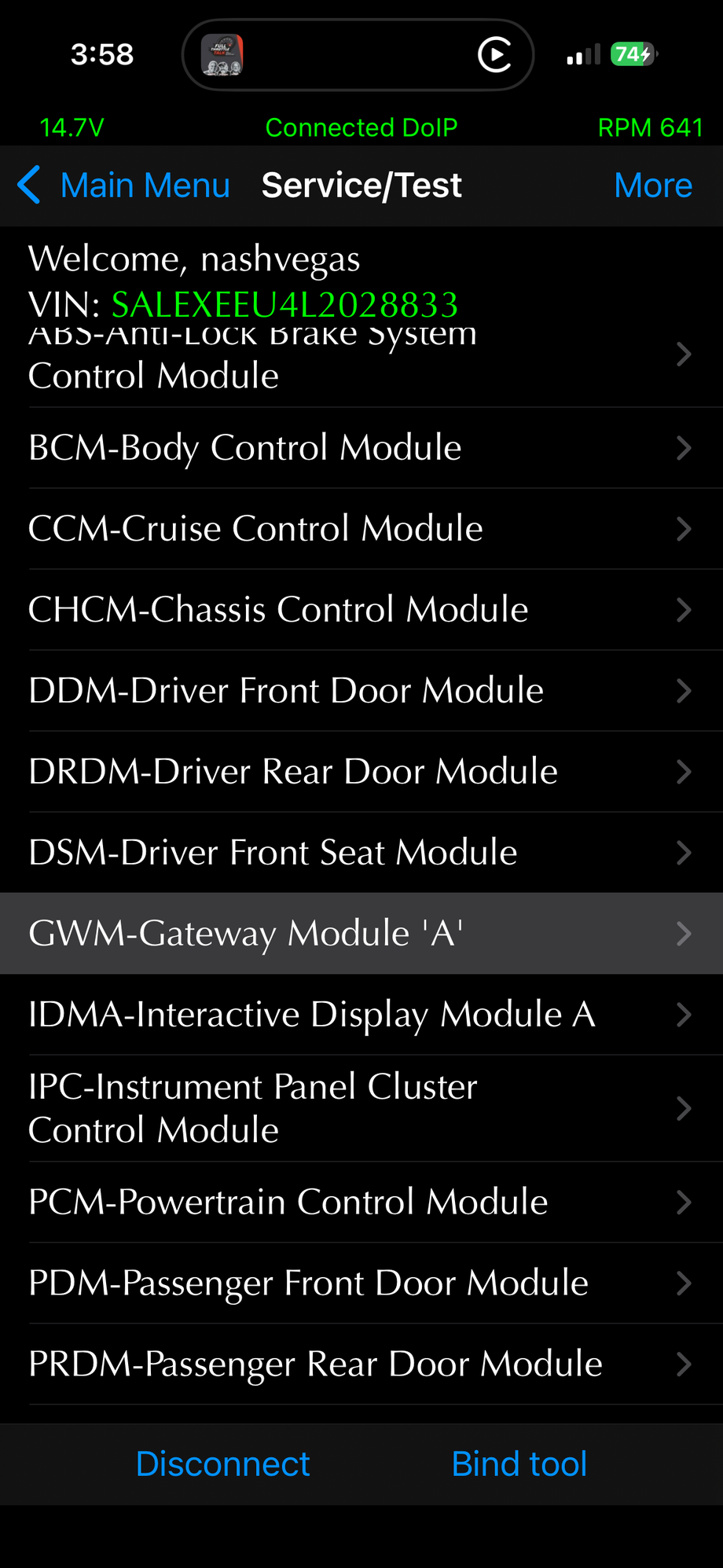

[QUOTE=roverrex;940228]
Anyway, I’m unable to find Gateway module under service test. Can’t find battery replacement routine anywhere. Any tips? Autozone did whatever they did with their computer and claim everything is set. But all these strange issues have me worried.
/QUOTE]
You on the latest G4 Gap IIDTool? Maybe your Gaptool isn’t updated or latest tool / firmware (ie it’s a G3?? Here’s the menu path screenshots on my G4:
