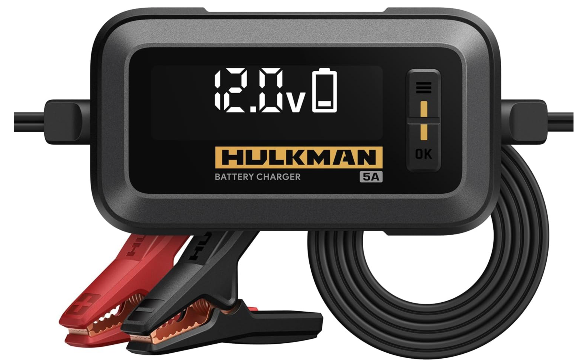

For Defender, I had to change 12v. cigarette charger to clamps which is annoying (to move Ctek and change charing connector from 12v to clamps) so I bought the Hulkman and using claps. Defender is quite easy to charge as I only have to pop the trunk as positive and negative connections are right there without taking any other panels.
I do want to attach quick connects but I'm not sure what size nuts I need to buy to secure these washer style quick connect to positive and negative terminals. Do you happen to know?
