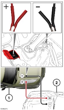

You should connect the trickle charger to the battery terminals under the hood. The lithium battery under the trunk is the battery for the 48v MHEV system, which is used to support the engine. It replaces the accessories with an integrated starter-generator to help improve fuel economy, give a slight power boost at low RPMs and offers nearly instantaneous auto stop/start. It is charged with the energy recovered under braking and does not require external charging. The standard 12v battery under the seat powers the infotainment system, interior electronics, accessories etc. and should be on a trickle charger if you're storing your car long-term. Like I said, connect the charger to the battery terminals, which I have attached a photo below.

The P300 and P525 use the same method as the P400/D200/D250/D300/D350 MHEVs - use the terminals under the hood. All JLR products are like this, as none have the battery in the engine bay.
