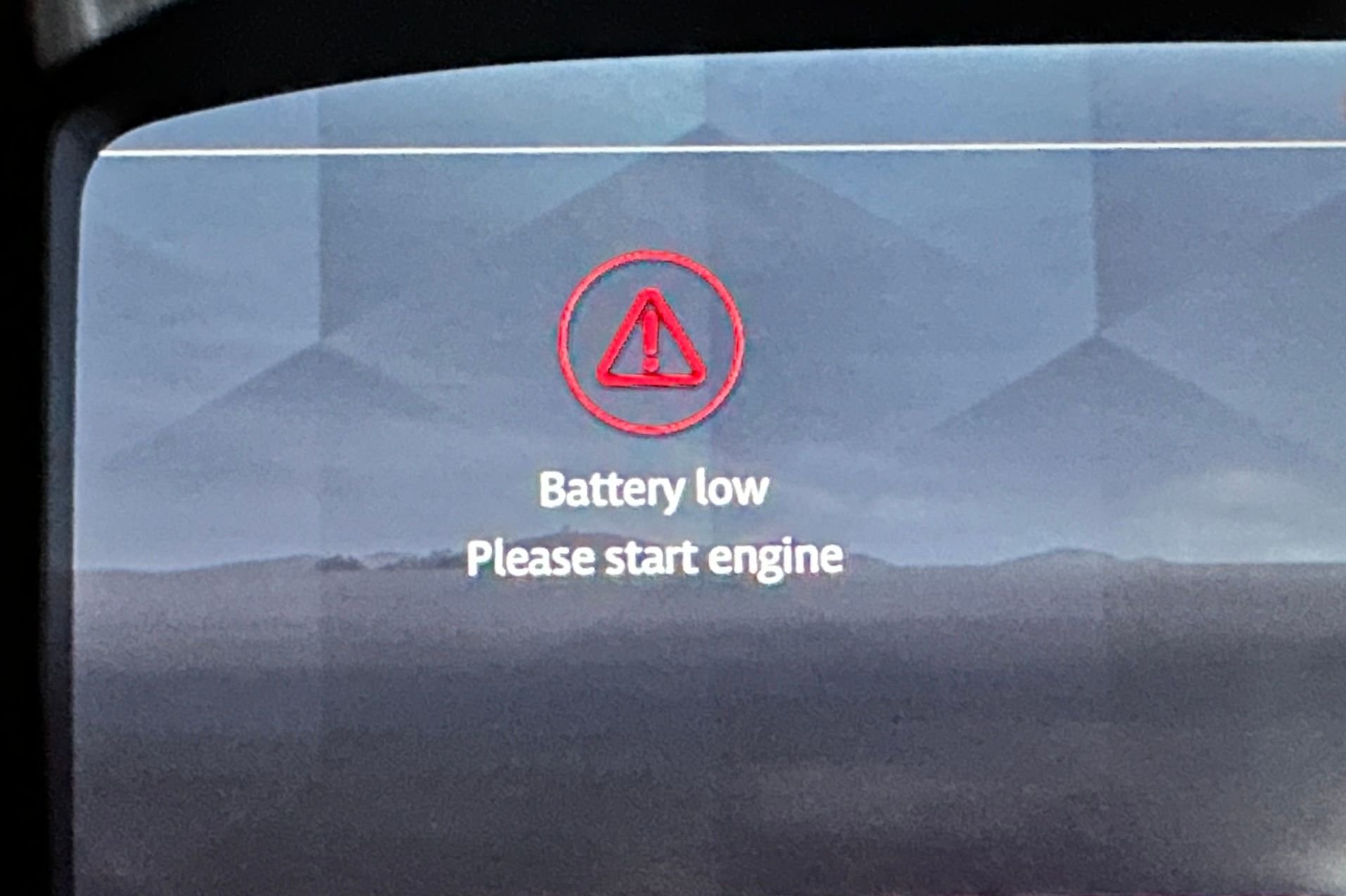

I’ve found my ‘22 model battery drains super fast and often get the low battery warning after 2-3 days of non-use. Super annoying and I’m guessing not normal (I’ll have the dealer check it out next time there).

I had that screen before, when it was in for Xpel PPF the other week. I havent charged it but have driven it daily since and it has not come back...
