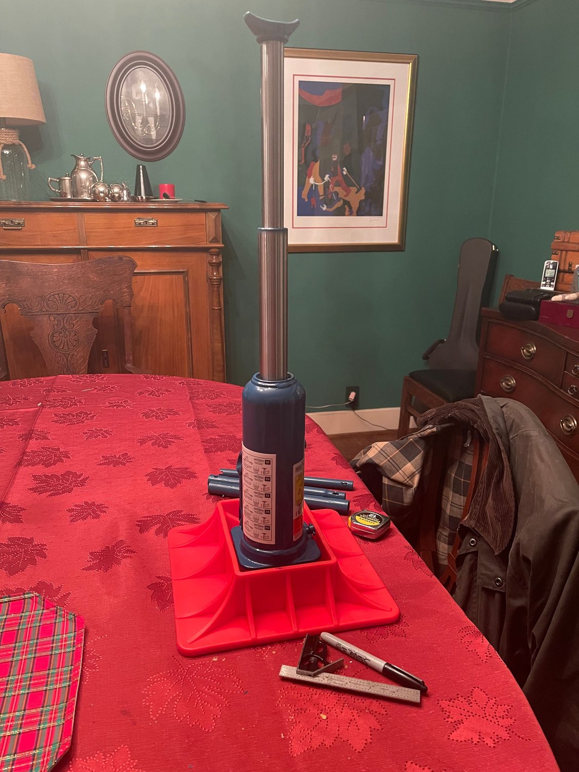

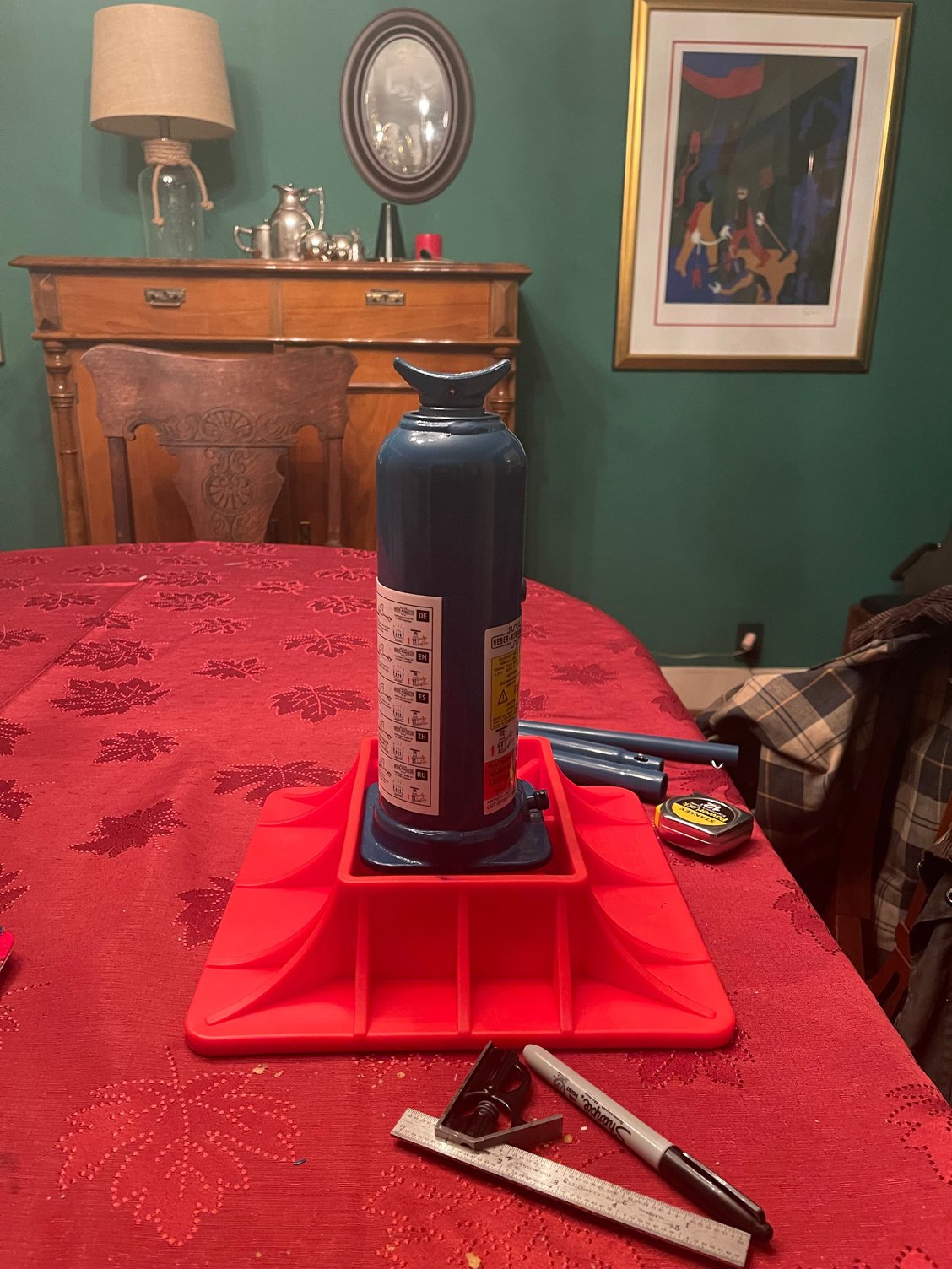

I don't know how the bottle jack works. As mentioned above it can lift to a total of 16 inches. But my car needs around 10 inches of actual lift, not total height. So my 10 or 20 ton (I forget which) torin big red bottle jack won't do it.
I had to use it in an emergency and by dropping the air suspension all the way down so if hit the jack, then opening a door so it didn't change height, I could just get it high enough if I totally deflated the tire
If others can make it work that's that's great but it definitely will not on my 2024 X with air suspension.

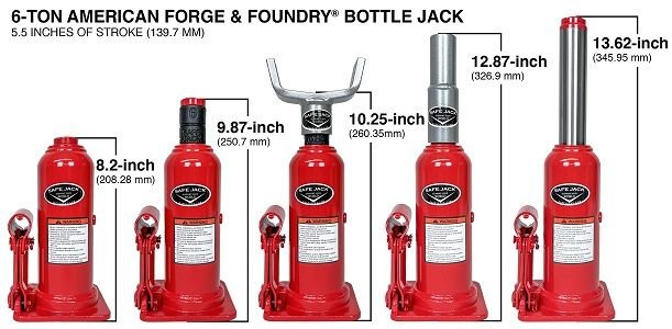

Safe Jack looks great, but I don't see how it would work for us:
Their documents show the stroke to be 13.62" - 8.2" = 5.42". I just tried jacking up my Defender with a floor jack, it required a minimum lift of 7" for the front wheel to clear the ground. This safe jack cannot manage that.
Reading the reviews of the Big Red jacks is really scary and they don't have the stroke that they claim either, making their usefulness marginal.
So, still looking for a quality bottle jack which will work when I need it and can perform a lift of 8" or so.

I posted a detailed breakdown at this post a while back - it may be helpful with respect to the lifting heights. 20~26"+/- is possible with a SafeJack and the extensions available.

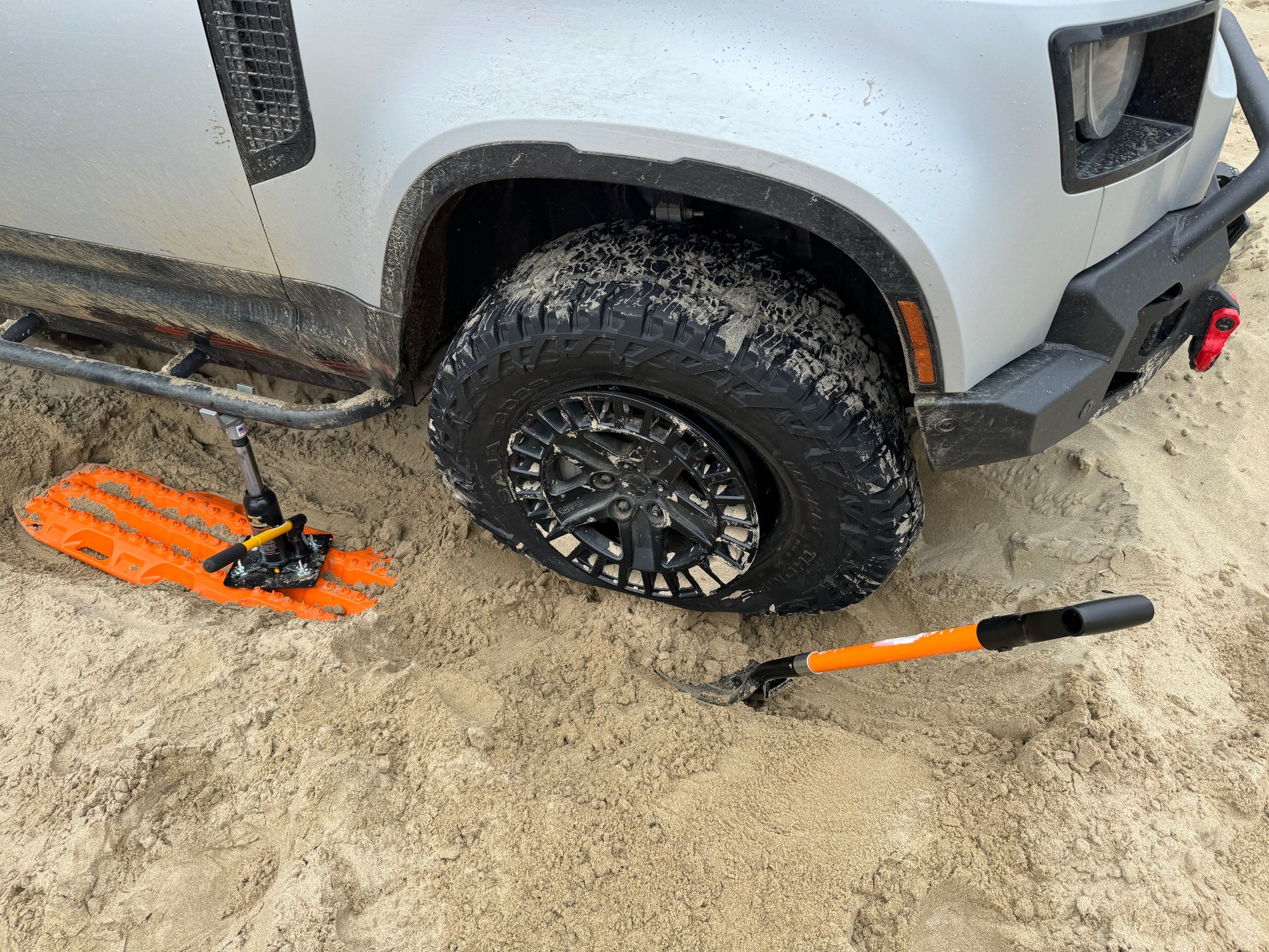

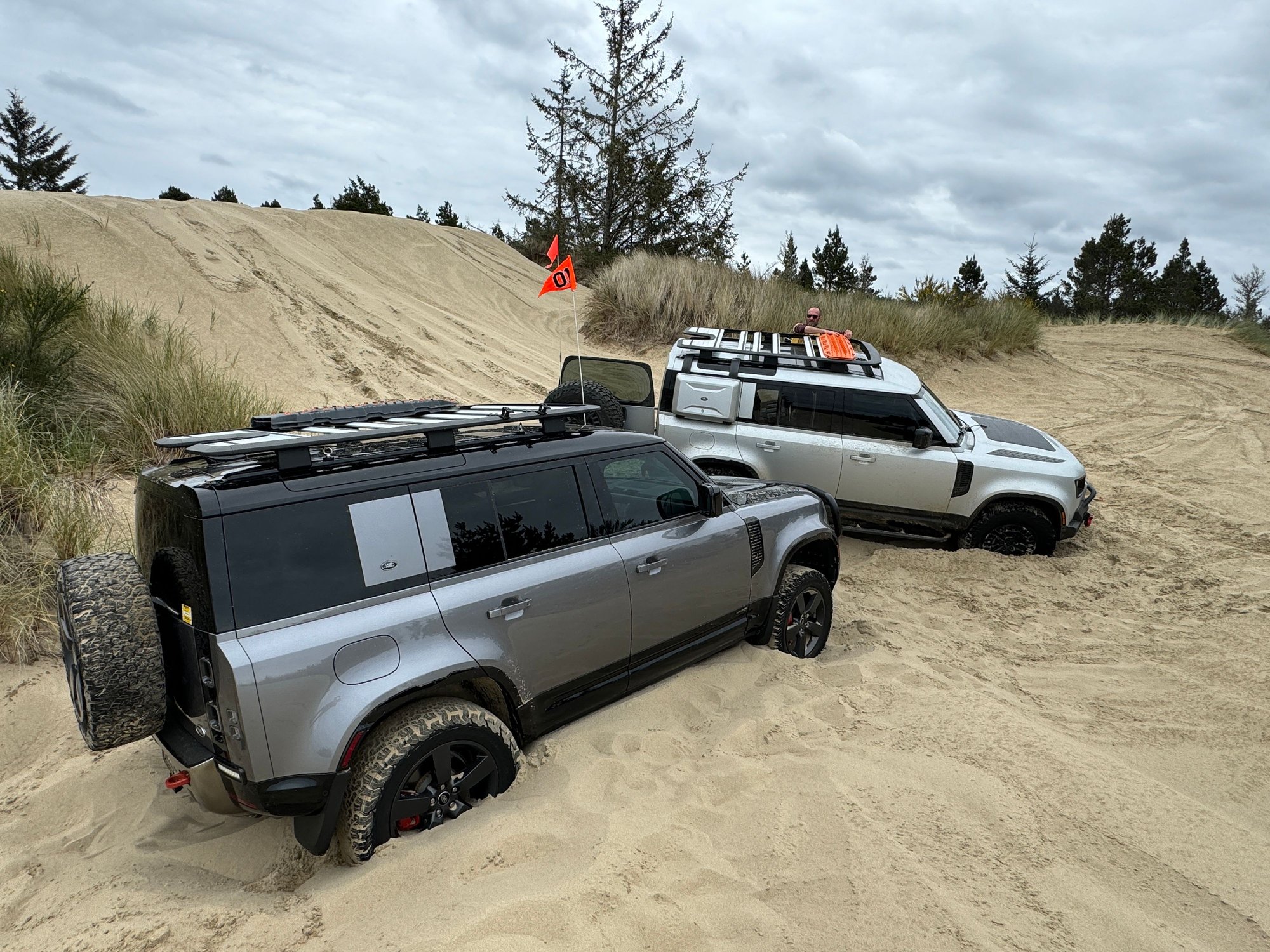

My take here is that perhaps you’re asking the wrong question. It’s not going to be solved with a “bottle jack”. Bottle jack is IMO the right packaging, size, weight, and compromise for most use cases.
I’ve now changed 3 tires on 2 different Defenders with a Safejack on different surfaces (sand, driveway, trail) and have made it work every single time, once I had to use the bottle jack AND the jack that came with the defender to reposition and a shovel and a bunch of wood; but just FYI, the other option I’ve read about that is a tall enough bottle jack is the Mercedes original equipment sprinter van bottle jack. I don’t have any specs or technical info - but multiple people have recommended this jack to me as well with a hi-lift base. Maybe it’s good?

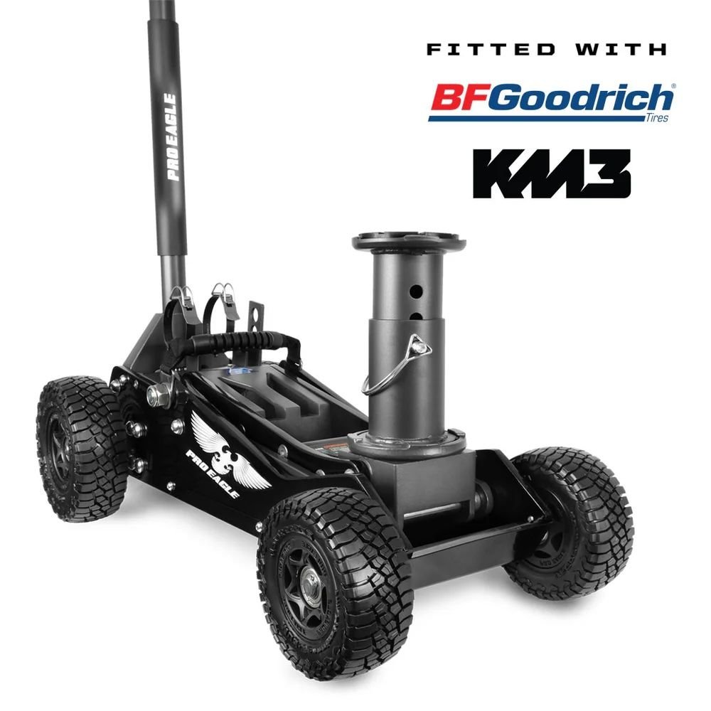

I do know that changing a tire on a trail is as simple as “jacking up the truck removing the wheel and putting the new wheel on” I think is a mistake. It’s usually a bit more McGuyver than that. Jack travel is only one of the problems you face. Two jacks. Jackstands. Etc. The compromise would be to carry a huge floor jack. I’d rather deal with a lack of jack stroke and figure it out. So you’re not wrong,
In an ideal ideal ideal world, where space was not an issue -- this is what I would carry every day and on every trail ride. https://www.proeagle.com/products/3-ton-big-wheel-jack-kratos
