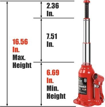

Amazon Amazon

According to the last entry by @BritCars in this thread https://landroverforums.com/forum/20...-126009/page3/ you need over 10" of lift to get the tires off the ground. That jack only has a 7.5" lift, so it seems like it wouldn't work. Do you have one and have verified it works on an air suspension Defender?

The Torin Big Red is double ram - over 16" height. I've used it on the trail to change a wheel.

The jack can get to 16", but only has a lift of 7.5". Did you use this on the standard chassis lift points, or somewhere else? Do you have air suspension?

I used the standard jacking points. I've air suspension.
