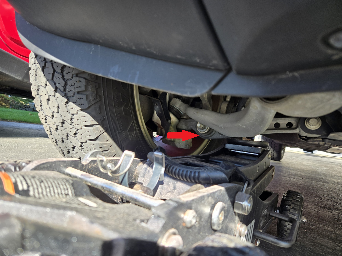

@H1Tad thanks for your advice on the hylift - I was a bit apprehensive myself. Where on the control arm is suitable for jacking with a floor/bottle jack?
Old May 1, 2025 | 07:51 AM
  #32
H1Tad's Avatar
Joined: Nov 2024
Posts: 384
Likes: 327
From: Cape Elizabeth ME

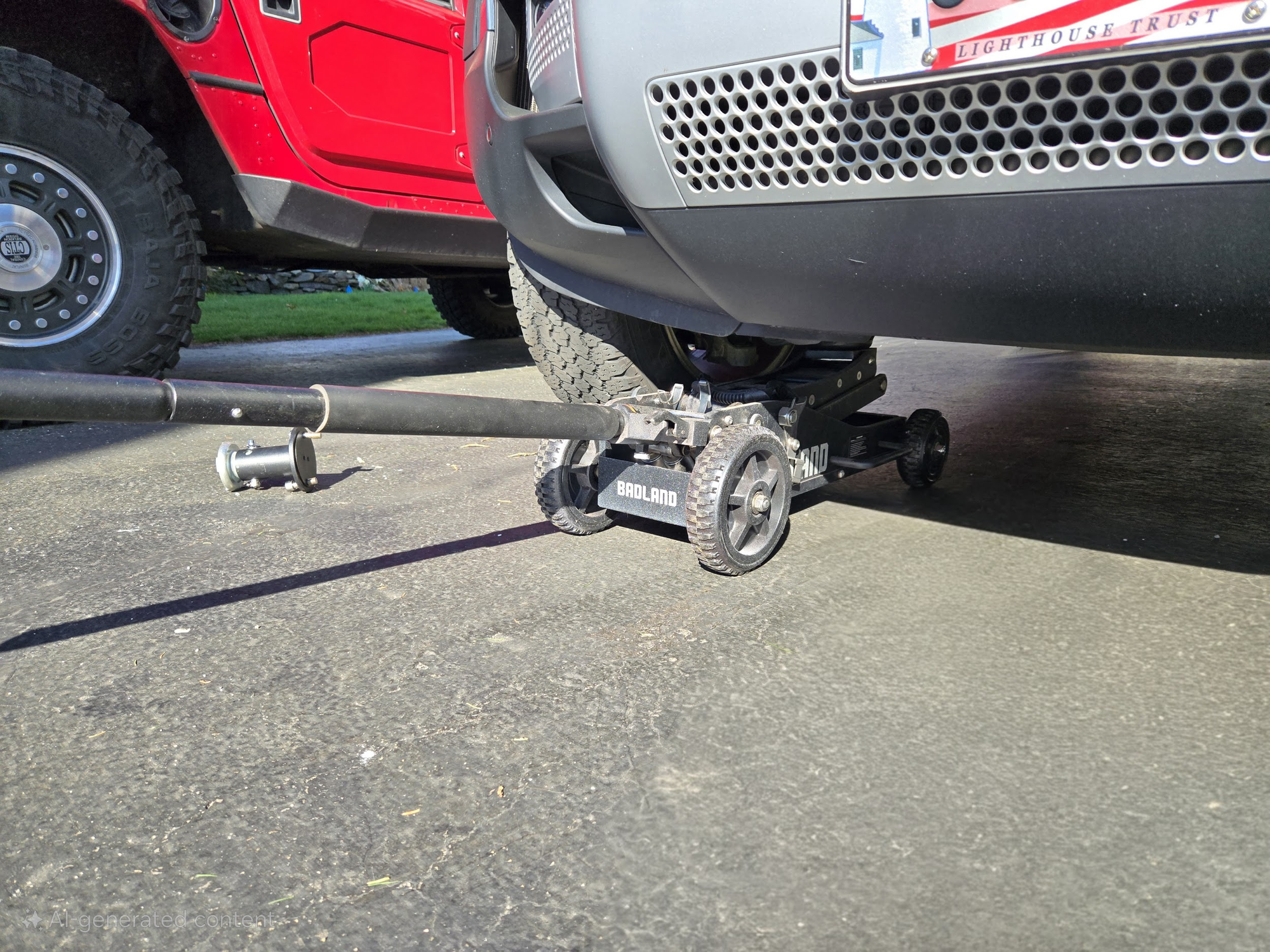

You know thats a good question - and its a task that I haven't actually had to do on account of my Defender's excellent reliability record so far. But thankfully the wife is out of town so I have access to the Defender this morning so I just took the jack out and tried it myself. Now that I actually had to use the Offroad jack on the Defender, its a bit tough to get under the side or front bumper and I had to take the height extender off for the first time in I donno how long.
Now I'm sure this isn't the "recommended" way but sometimes you gotta do what you gotta do.
On the front - I'd jack as close to the wheel as you can get, ideally right under the bolt knuckle area that I put a red arrow on. I couldn't get close enough with my jack on my coil sprung Defender but I'm guessing that in offroad height you should be able to get a floor jack under there no problem.
Rears I assume would be pretty easy as the LCA casting is yuge.
I've got to get to work so I'll leave it to the experts to explain how to do the rear - or if I've got it all wrong.

@H1Tad Thanks for getting out into the field and looking and what you could do! I think I’ll just stick to the specific jacking points though and find an adaptor for them…

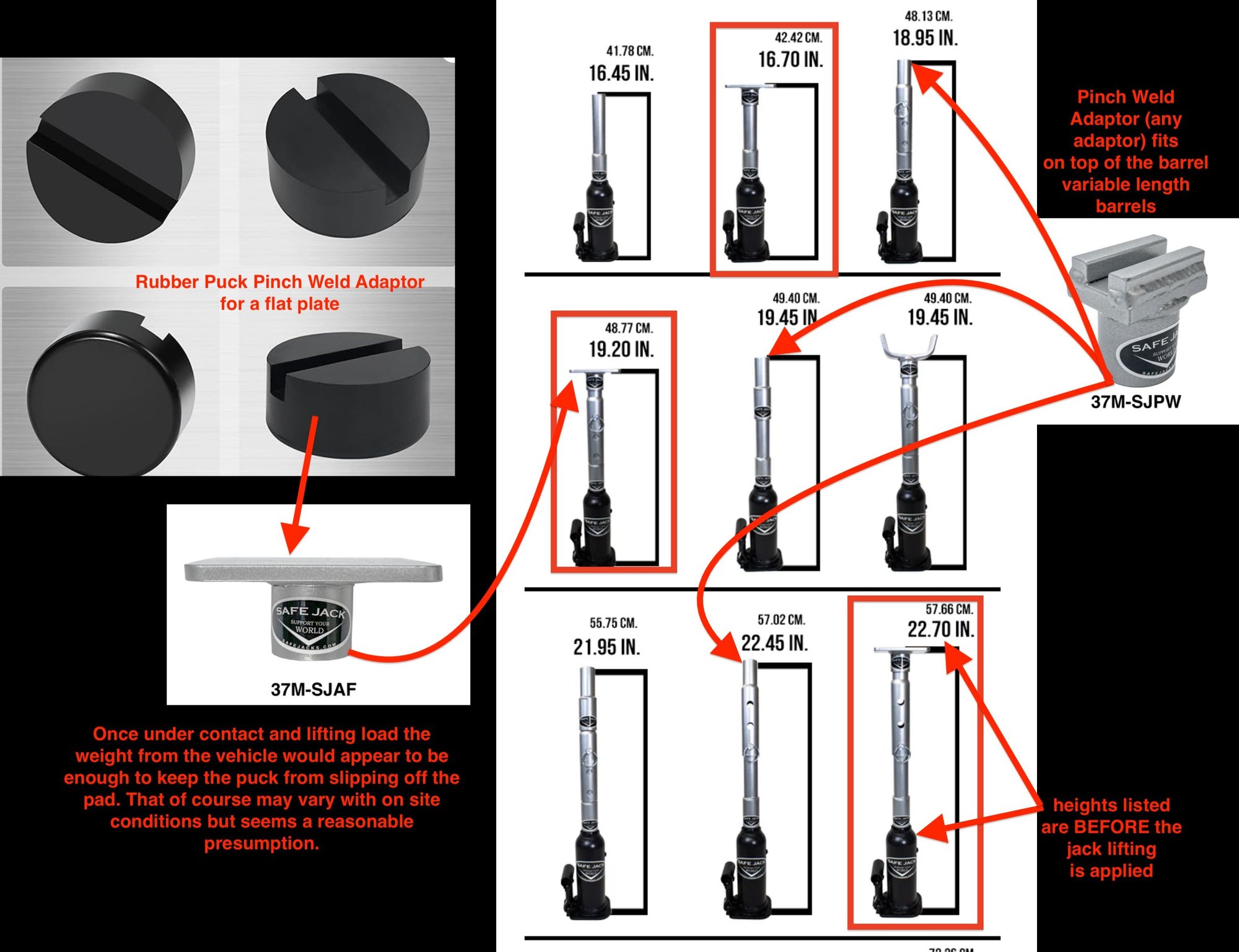

My next question is how the hell do you get one of these on a bottle jack:
To safely mate to these silly jacking points?

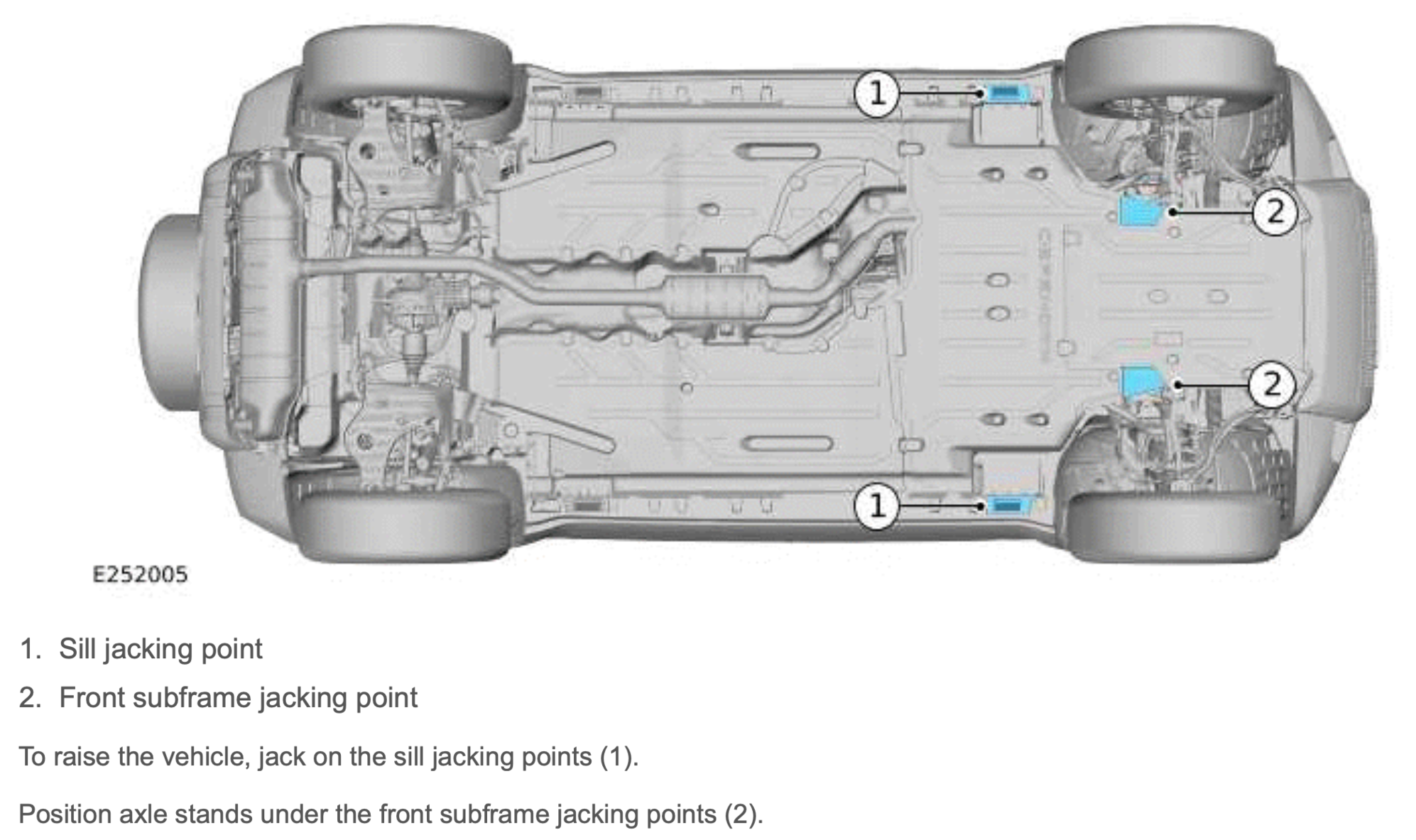

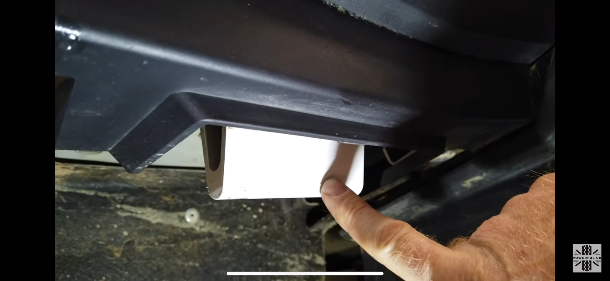

My next question is how the hell do you get one of these on a bottle jack... To safely mate to these silly jacking points?
Short answers:
1. Fittings as you pictured slide over the top of the SafeJack bottle jack primary lift point or any of their lifting extensions. That one is for large round or square tubular frames (axels, frames, etc). I wouldn't try and use to mate to the lifting point you pictured,.
2. There is a SafeJack pinch weld adaptor or the flat plate adaptor rather than the one you pictured. It is possible to use the flat plate adaptor with a rubber pinch weld adaptor on top, or lift from a different point on the LRD. See images below.
For example I might use the fitting you pictured to lift my trailer from its structural steel frame (HSS) assembly. I could also use a puck as pictured below to lift from a pinch weld point ontop of the flat plate adaptor, or from the LRD lift point you pictured with the pinch weld adaptor.
See the pictures below for the 8 possible lift points on the LRD. Four are as you pictures and 4 are slightly father back as noted in blue. I'd pull my SafeJack kit and take photos but I keep it packed with my trailer which, sadly, is not in my home garage.
I hope this helps

Woah, @Huc thanks for the detailed analysis. The puck and flat plate method definitely seems to be the best - but as you said conditions may cause it to slip off. What I’d be worried about is on a trail which isn’t completely flat having the puck slip off side of the plate then a whole manner of other things go wrong as a result. Is that fear warranted, or is it really just an issue in really steep areas?
