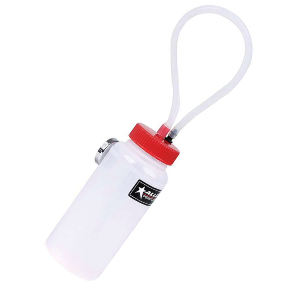

Good info
I have a brake bleeder but it's the kind where you hook it up and pump the brakes to flush the fluid. Any problems doing it without a power bleeder do you think?

That's a good question. I would think that would work, but I haven't tried it. The service manual says to use a pressure bleeder, but is also says you have to use the LR computer to put the brakes in assembly mode so....
https://www.lrdefender.org/brake_sys...liper-514.html
