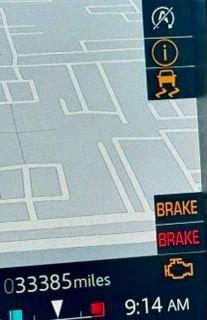

This is the 3rd time I’ve had a brake system failure in less than 2 years (photo).
Non-working systems include: cruise control, stability/traction control, terrain response, parking sensors, auto stop/start, lane keep assist, emergency braking, cross traffic alert, blind spot warning, parking brake, and of course generally crappy braking (pulling, ABS noises, inconsistent pedal pressure, pedal going to the floor(scary)).
First time dealer did a software update/reset. Lasted around 2 months.
Second time dealer replaced the ABS modulator and brake booster. Lasted around 12 months.
Third time - in for service now. I’ll let you know.
Dealer says this is a unique issue, and I’ve come up blank searching the internet. Anyone seen anything similar?

Quick follow up:
The factory rear calipers were installed, but the computer is still spitting out error codes.
The dealer is “checking with corporate for how to proceed”, but they may void the warranty.
If so I’m looking at a $10,000 bill (ABS Modulator + Brake Booster).
Good times.

Originally Posted by GavinC
Dollars to donuts the system has not been correctly bled.
I’d do that again myself first before writing any checks. Air in the system makes it go completely nuts.
You nailed it!
They couldn’t get the air out using the factory procedure of using some vacuum machine. But using the manual method got the air out (pumping the brake pedal while opening/closing the bleed valves).
So bottom line: the Lucky 8 brake calipers were letting air into the system.
Now, where do I get these “donuts” you’re talking about?
