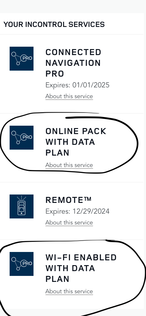

That is exactly where I ended up -- they created a 'ticket' -- then magically my in car wifi started working a day or so later. Also in my remote "incontrol account / app" it went from saying "expired" to now just showing up... like this
