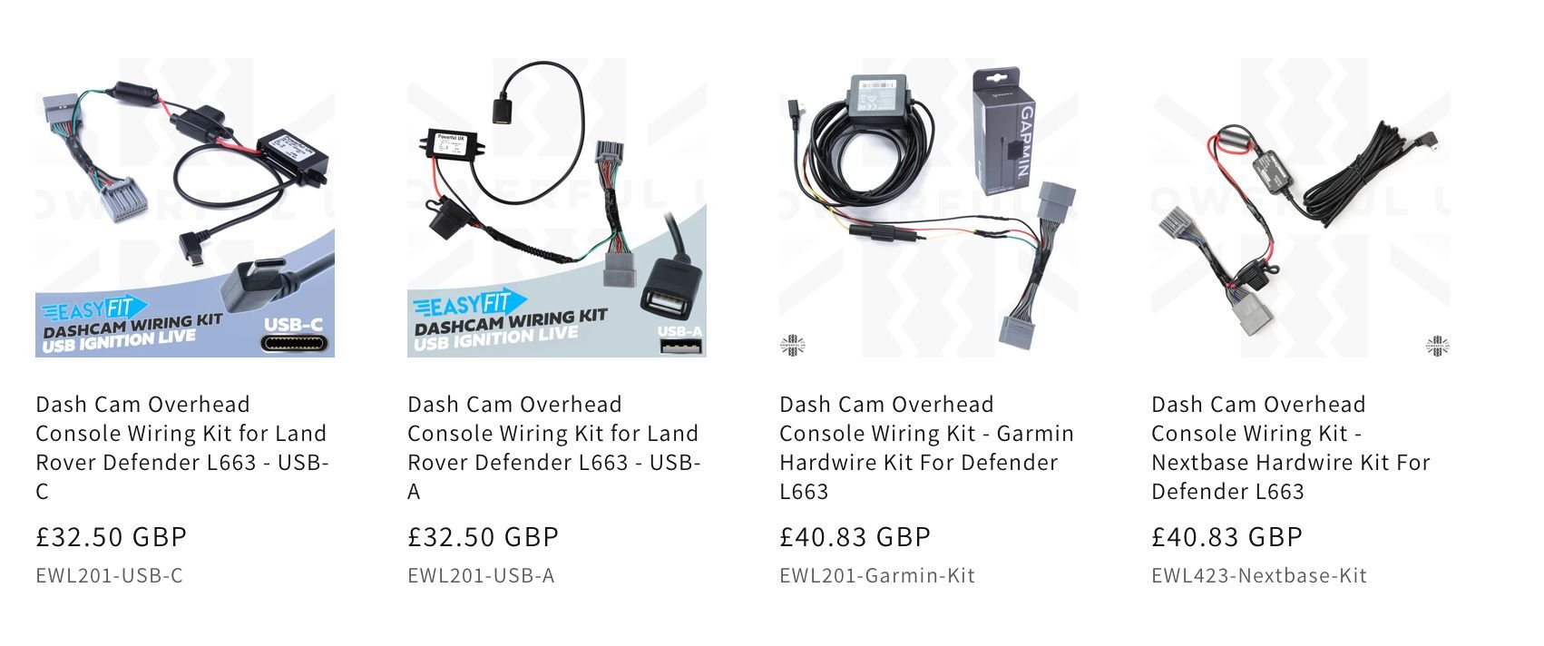

Has anyone found a way to hard wire a dashcam, possibly using a power source from the rear view mirror? I miss mine but don't want the wires running from the dash and looking messy.

Powerful UK has wiring harnesses for most dash cams that tap into the overhead console wiring with no cutting or splicing. I purchased one for my Garmin dash cam; installation was quick and easy.

I have this powerful UK harness for my Blackvue dash cam, works a treat. It’s been working properly for 2+ years.
Be advised, cut the wire to length. If you have a long coil of wire up there you may cause interference with your rain sensor.
Then I also have a radar detector and used genuine Mirror Tap to power that too (not the fake ones on amazon that cause intermittent connections). It did occur to me that -- well, why couldn’t use use mirror taps to power the camera? Probably could.

Just to second this, I used the Powerful UK harness splice to mount a Viofo camera in mine and it was easy and has been working flawlessly to the point that I forget it is even there. Leaves a very clean install, with only a slight bit of cables exposed before going up into the headliner. Just be sure to order the harness that corresponds to your camera's power input.
