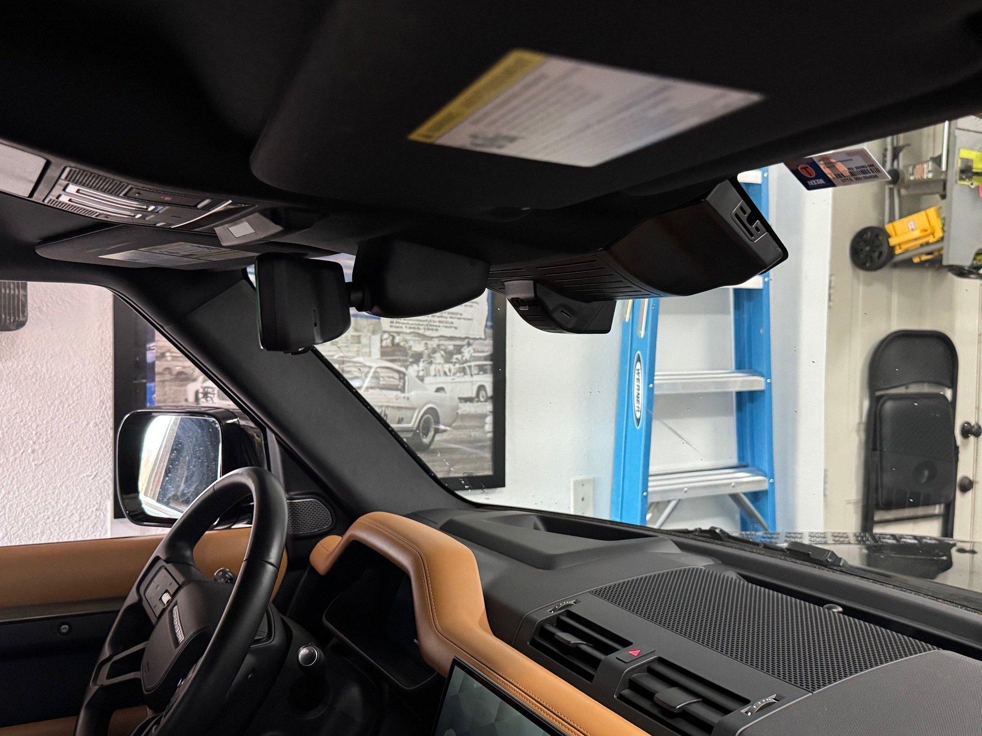

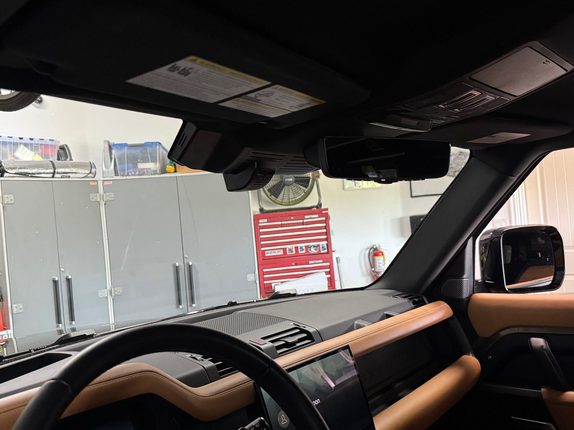

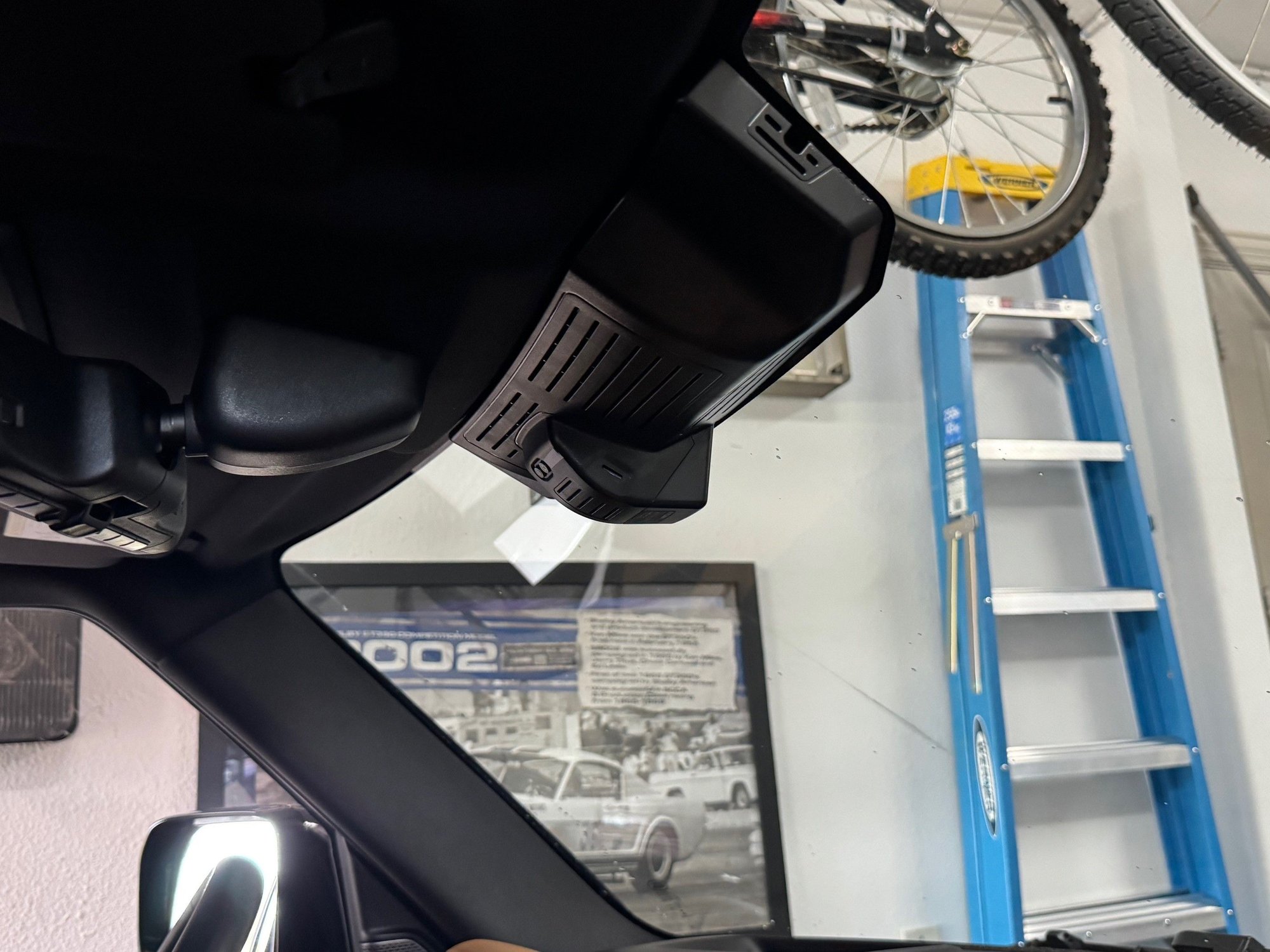

I installed the Fitcamx in our newly acquired 110 yesterday and am impressed. I only installed the main/front camera and will get to installing the included rear unit in a few days. The installation took about five minutes...seriously. Routing the rear camera's cable will take much, much more time, lol. Getting the iPhone app to connect did take another 5-10 minutes as I struggled with connectivity, but was finally able to get everything functioning properly. My previous dashcam experiences always included integrated displays, which I prefer. This is the wife's vehicle and she has no preference, so all good there. As you can see, it looks factory.
One tiny gripe is that the LED lights stay on and one of them flashes. My wife didn't mention it, but she hasn't driven at night either. I ended up putting a small piece of electrical tape over the offending lights (three of them, but they are very close together). You'd be hard-pressed to tell that there is tape on it, but it bugs me a little. I'd rather be able to disable them altogether.
