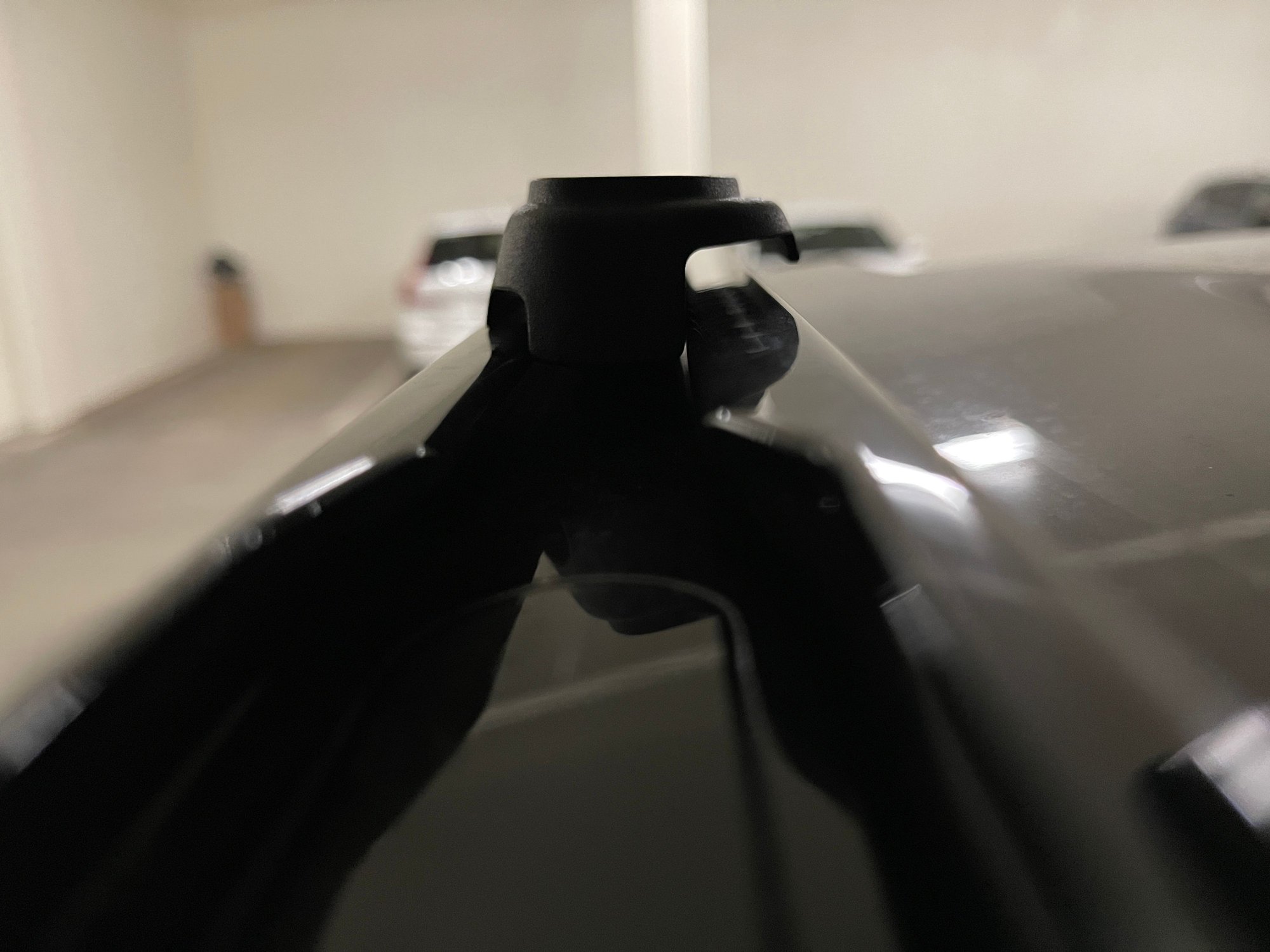

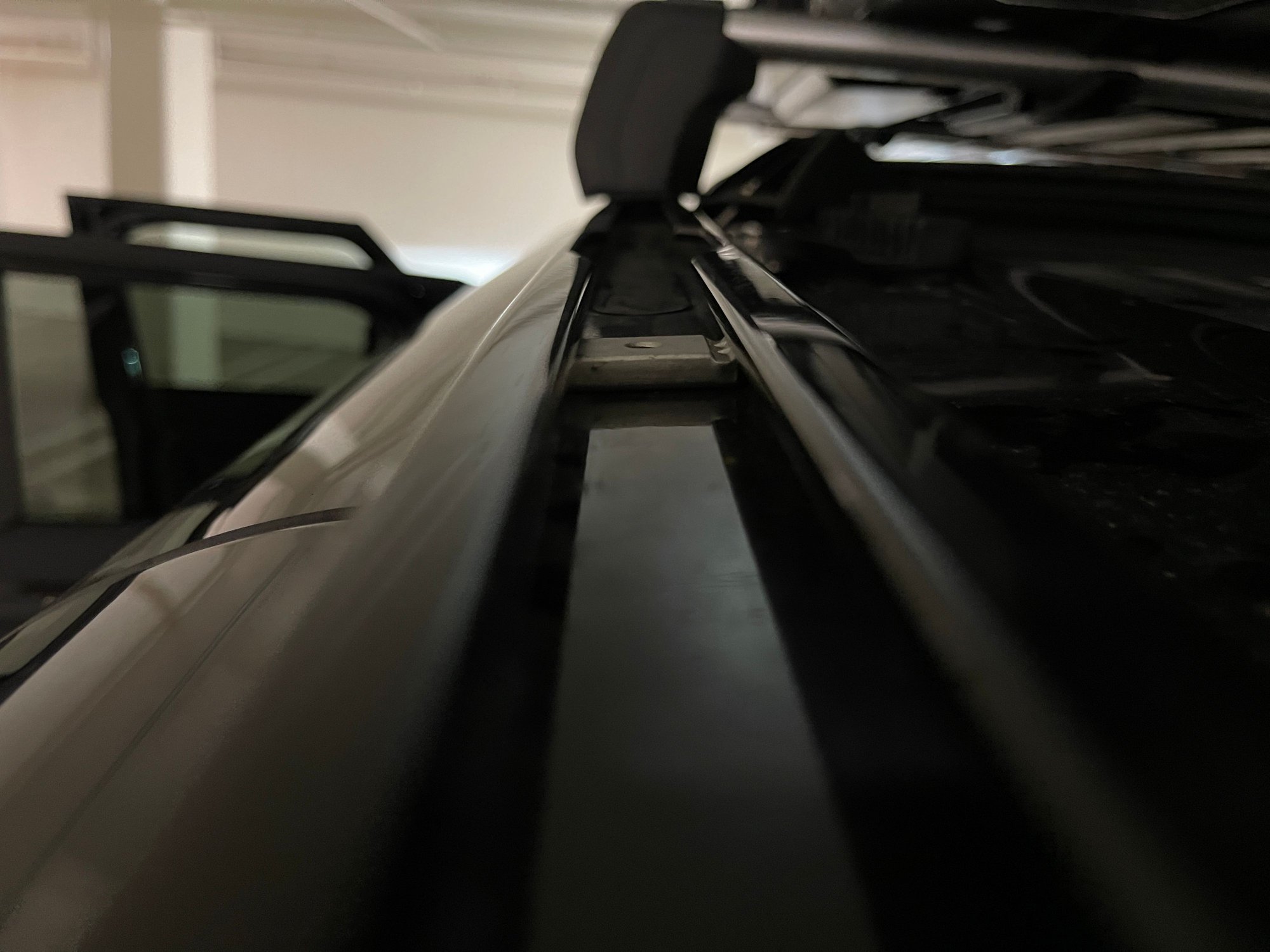

The RCP-13 fit kit finally arrived so I decided to do some test fitment before ordering the platform.

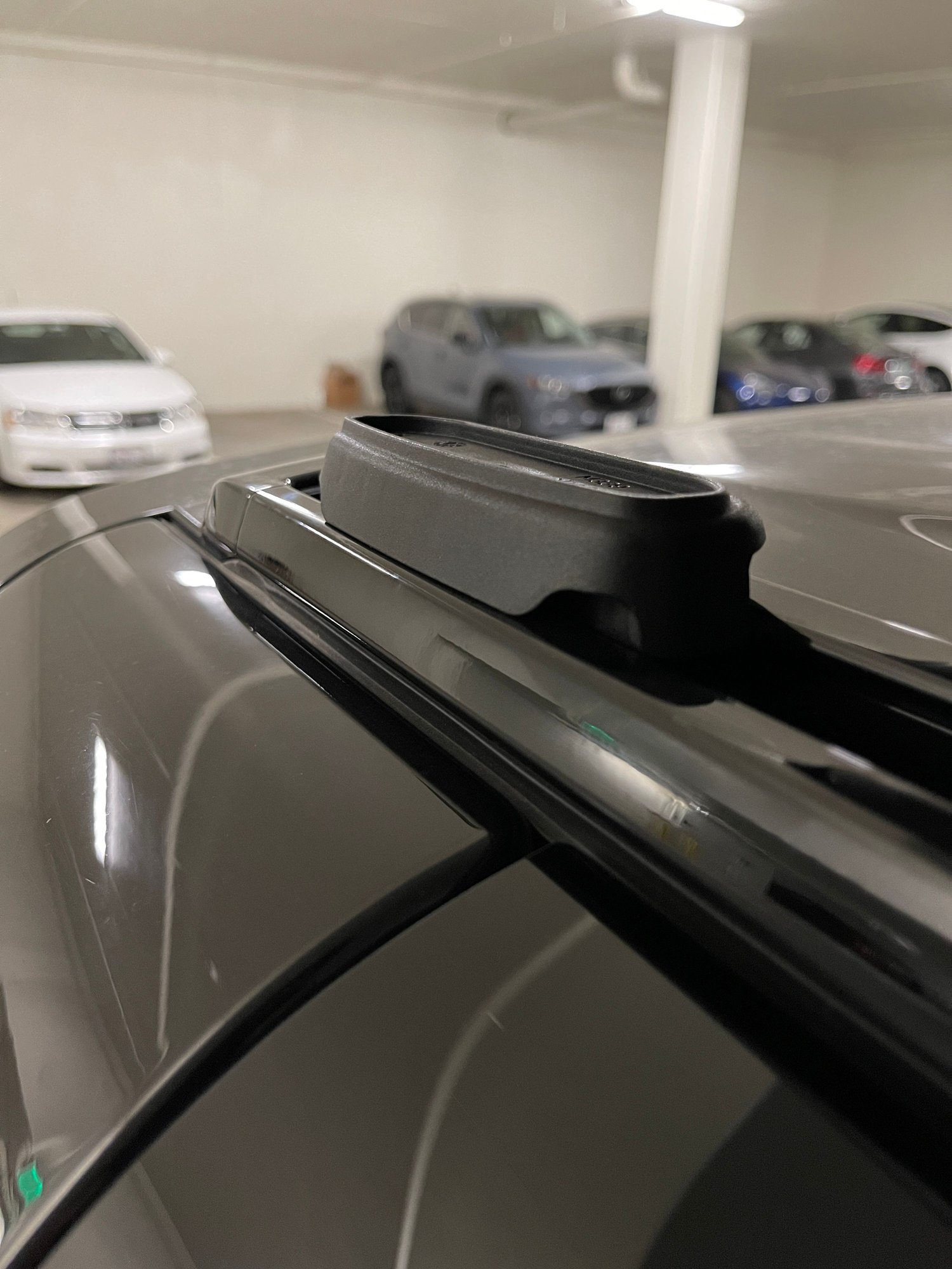

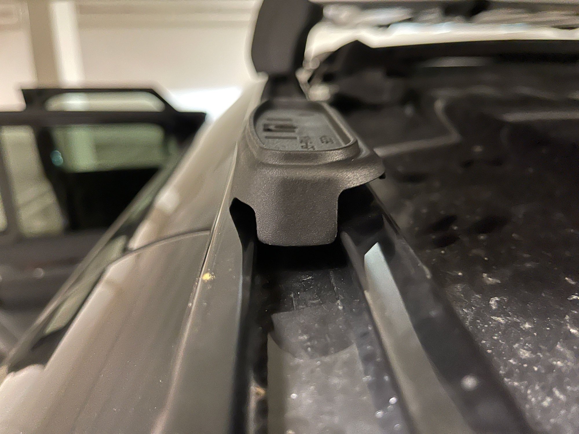

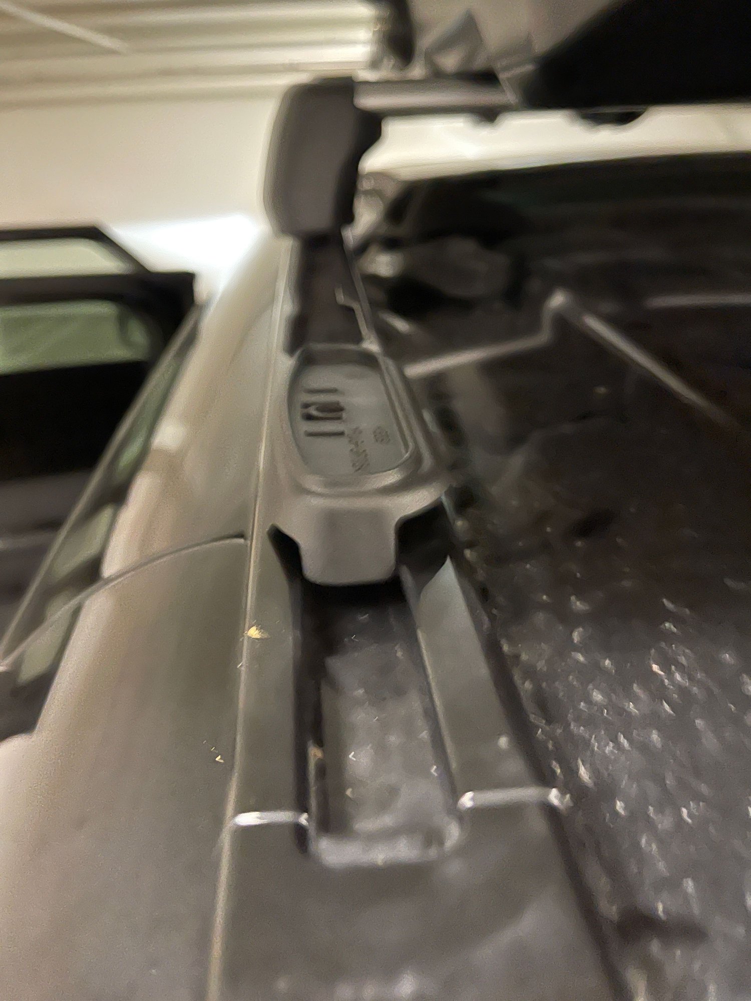

At first glance it looks like they fit, and the washer fits great in the track, however upon closer inspection I don't think there is enough support for much load.
The feet do not fit as designed (flush) in the tracks, and appear to be a little "tall" for the LR track. It's an interesting problem because technically it might fit great if the small edge of the fit kit was cut down (might attempt). The stock bolts are too long however and I feel that the retainer might be compromised if I need to cut that down as well.
I did email Rhino Rack to find out more about a Defender specific fit kit, response as below.
Hello, Thank you for reaching out to Rhino Rack. Unfortunately, we do not have an engineered fitment for the 2020 & 2021 Defenders. Our engineering team is working on making those fitments but at this time, we do not have an ETA for when they will be released
One side fits flush!!
Sits high in the track due to the "small" side of the kit.
