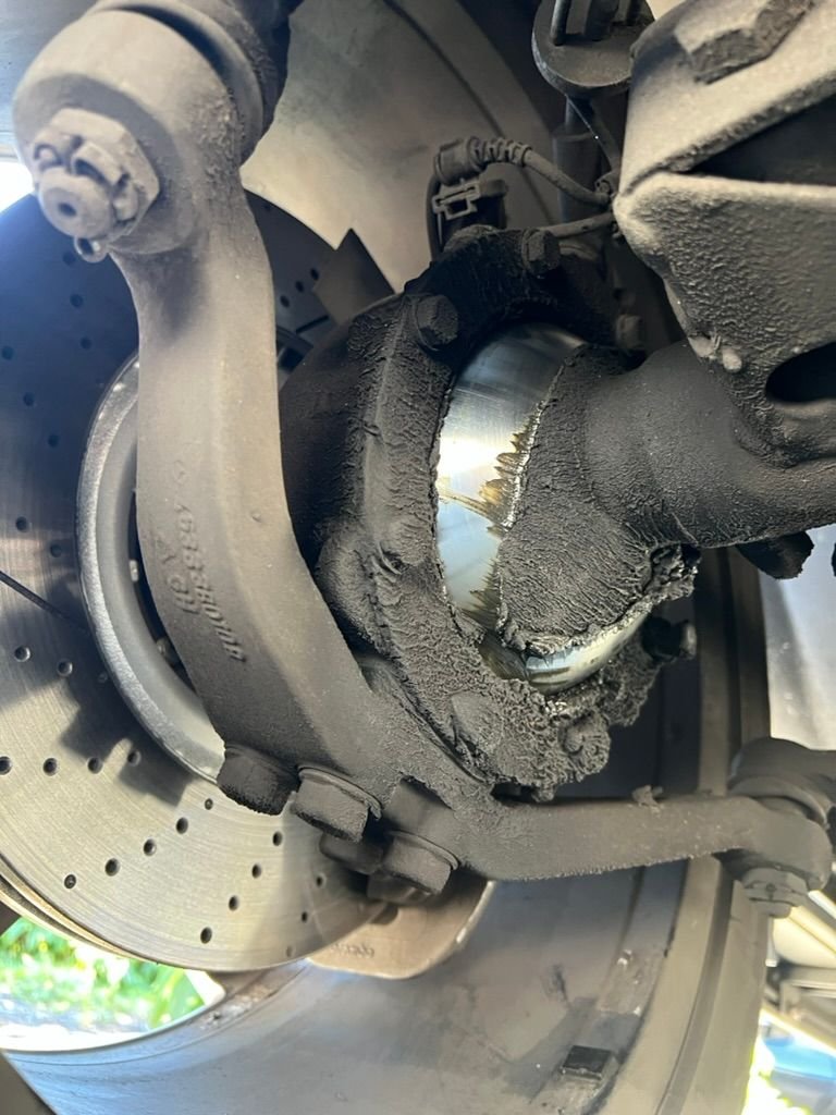

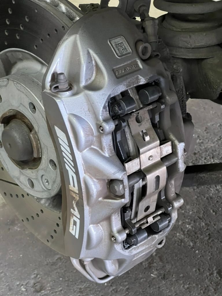

Ha, well, the G aren't for everyone but they are incredible off-road when set up properly. Mine currently has 34" BFG KO3 tires and a 2" lift.
Body on frame with steel springs and solid axles always lean in corners but it does not mean they are unstable, it's just a very different handling style that can take a long time to get comfortable with managing at higher speeds and/or less ideal terrain.
It is not different in concept, in fact almost identical, to the earlier Land Rovers like a 90's Defender and Discovery 1 which both had "ball swivel" front hubs and solid axles. The P38 Range Rover and Discovery II lept forward in their handling characteristics in part due to the sway bar but also a redesign on the front end while still being solid axles, not having a ball swivel anymore.
Having driven a 1996 Discovery 1 for nearly 200,000 miles before adding a 2004 Discovery II, the newer one seemed "sporty" by comparison.
The G has squeaks though for sure!!

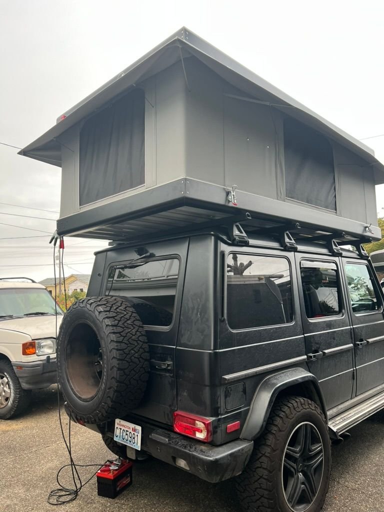

Well, mine is a 2018 G63. They are actually very straight forward to modify. However, you can never remedy the feeling of what a solid axle vehicle does to your body while rocking around LOL
The keen eye will see the Land Rover affection runs deep...

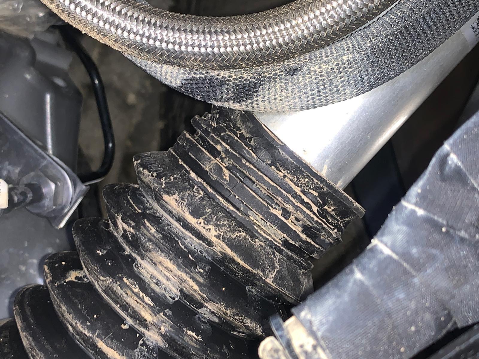

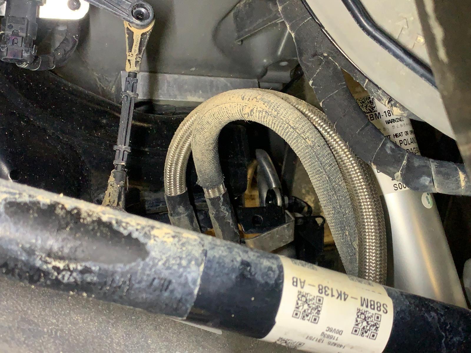

While it was in we also got some warranty work done. Two issues: squeaky front passenger head rest (going over bumps and when you put your head on it) and squeaky rear suspension (going over speed bumps, sort of sounded like the hydraulics of a low-rider).
About the headrest, the technician said Removed Front passenger seat head rest back cover and applied anti rattle tape. Verified concern, rattle noise from front passenger seat while driving on uneven roads. Noise located from head rest. Removed head rest cover, noticed rubbing marks on head rest clips. Applied anti rattle tape.” What exactly the attached photos of is difficult to gauge, somewhere in the headrest I presume, but I’ll attach them anyway.
The suspension: Corrected Rear 6D suspension hydraulic hose routing. However, 6D suspension hydraulic flow noise can be heard which is normal 6D suspension characteristic. Verified concern, Rubbing noise from rear suspension while driving over the road humps. No related DTCs. During rear suspension inspection noticed rear RH damper 6D hydraulic hose routing incorrect, hoses crossing over and rubbing against to each other. Also rear LH hydraulic hose rubbing with damper dust cover. Corrected hydraulic hose routing and re-tested concern rectified.” Umm, not ideal that the car was built wrong. It’s not even one of the first batches - they are 2024 and this is a 2025. Oh well, it’s quieter now but as the tech said some hydraulic noise is characteristic of the 6D suspension. I just hope no other lines are routed wrong. Here’s the photos they attached:
That milk that we went through at Mount Mee really got everywhere hey! FYI, these services were done back in early October.
