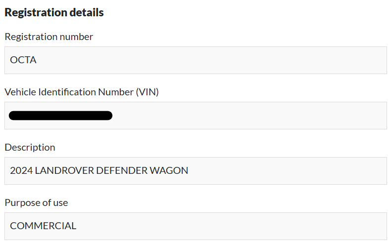

Originally Posted by A1C6;939843[color=#333333
” Umm, not ideal that the car was built wrong. It’s not even one of the first batches - they are 2024 and this is a 2025. Oh well, it’s quieter now but as the tech said some hydraulic noise is characteristic of the 6D suspension. I just hope no other lines are routed wrong. [/color]
OCTA was new for the 2025MY worldwide. There were no 24MY OCTAs.
Yeah, my bad. I meant the year it landed. There were only a few in Australia that landed 2024, but mine landed 2025 so therefore it's somewhat of a later model. See the NDM Defender OCTA
Attached Thumbnails Defender OCTA Ownership Review-screenshot-2025-11-18-064018.png
