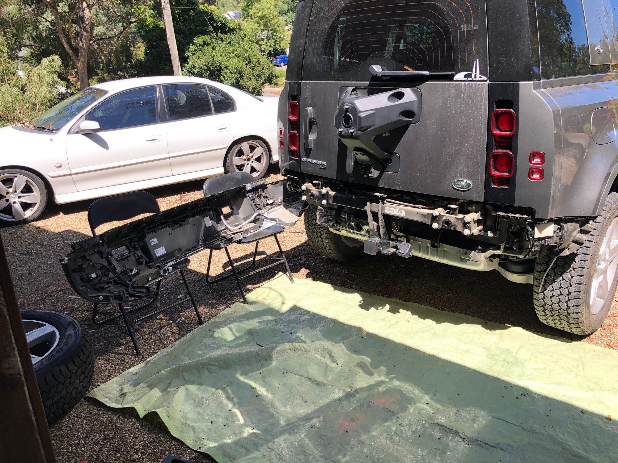

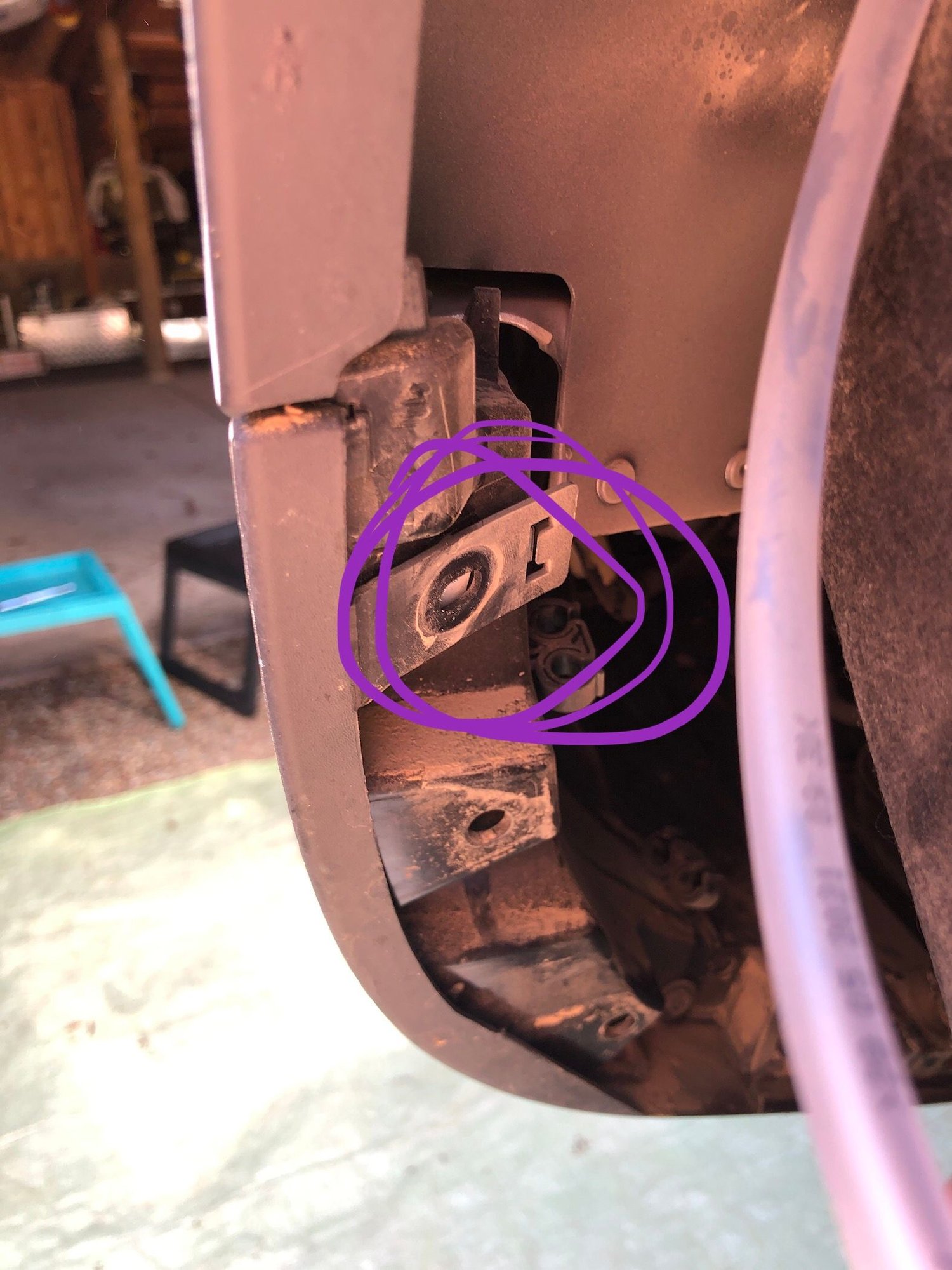

It is certainly doable, but I was nervous the whole way through. In the end, I got there after two and a half hours. The tricky bits:
  • a clip inside the wheel arch that you need to undo after taking the screw out (see image below with purple circle)
  • removing the wheel arch trim without breaking the white clips by pushing the clips through from the back once you’ve lifted away the lining
  • releasing the sides of the bumpers first by gently lifting around the underlying bodywork.
  • removing the rear wheel helped too.
And a simple suggestion:
  • don’t detach the cabling on the left, just swivel and rest on a suitable platform (second photo).
I have the D300 with tow bar and all the parking sensors. I didn’t count the screws removed, but PowerfulUK’s video identifies them all I think. You know you’ve removed everything needed when the bumper can rotate upwards when you pull gently on it. Then it is just the clips along the top holding it on, and a firm tug separates them. If you have mudguards, you’ll need to undo the screws holding them to the body work (basically, remove them).

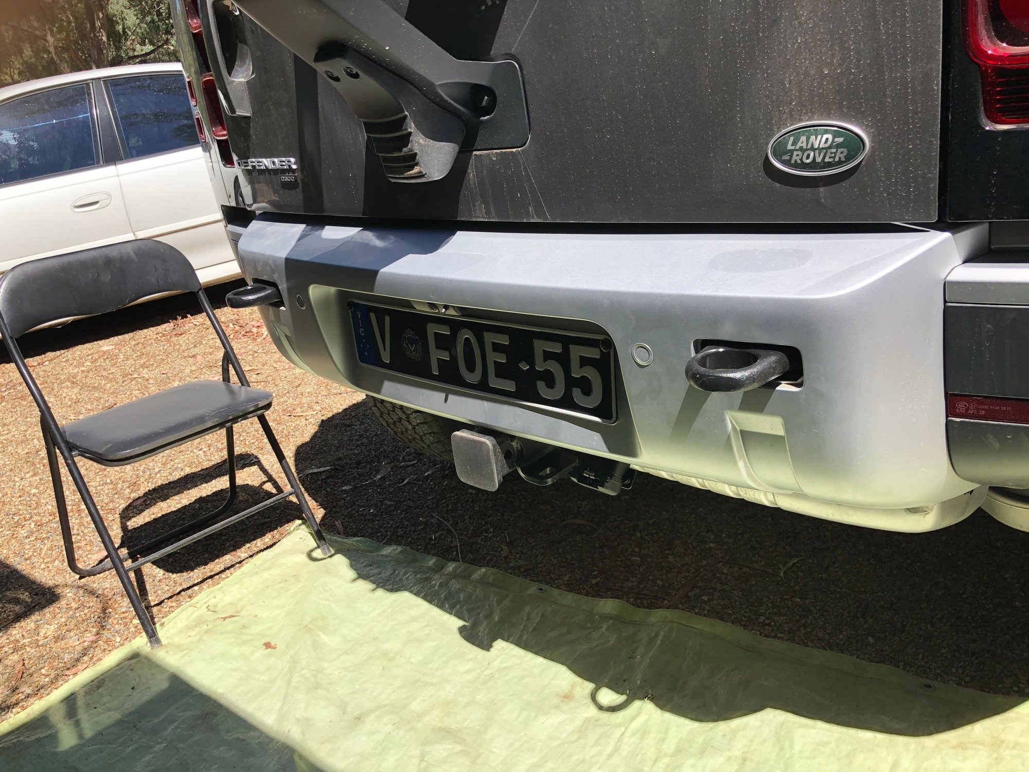

I removed and reinstalled the rear bumper this evening, with rear mudflaps and tow package, rear mudflaps make it more difficult.
Installed the rear tow hooks, and extra reverse lights.
