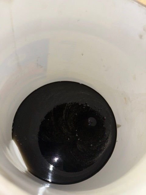

The fluid does get quite dirty. I'd definitely have it done at 30k miles. I did mine at 34k and a couple weeks ago at 50k. This is what it looked like when I drained it a few weeks ago after 16k miles.

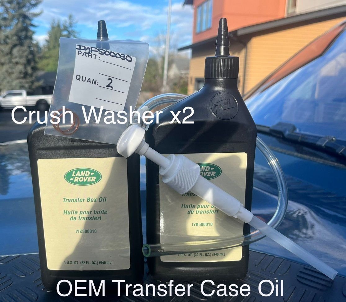

There's no flushing involved. A simple drain and fill is all that is done. Curious as to their rationale. It seems early for the transfer case.
T-case
T-case
Some oil and two crush washers. is all that's needed.

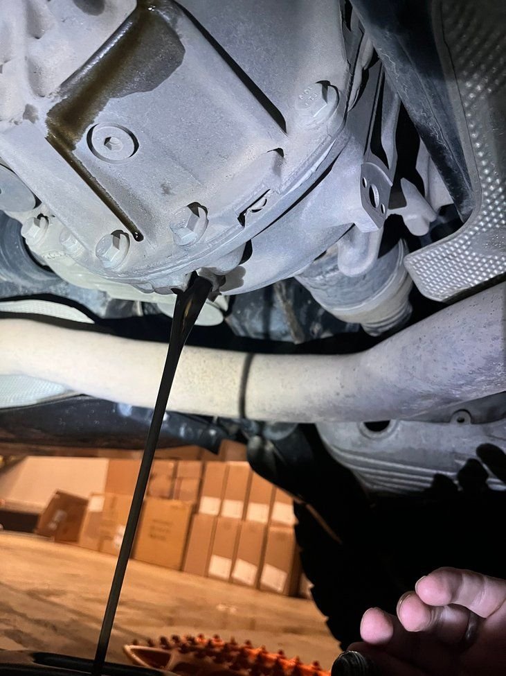

Rear diff, I think that's a good mileage to change the fluid given the complexity of the ediff and their diva-esque character.
Oil and new plugs
Oil and new plugs
 Very dark oil at 50k miles
