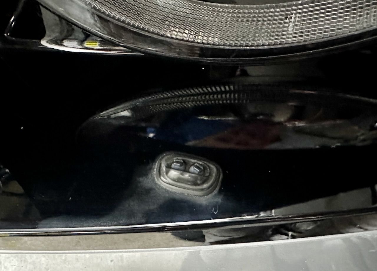

Went to test my 2022 defender today before taking delivery.. Everything looked outstanding other than it seemed the front drivers side headlight washer jet was leaking.
I know that this is a known issue I have seen on the FB groups but couldn’t find a thread for it here. Does anyone know if there is a known fix/SSM for this issue?
… or is something leaking on day 1 just to be expected

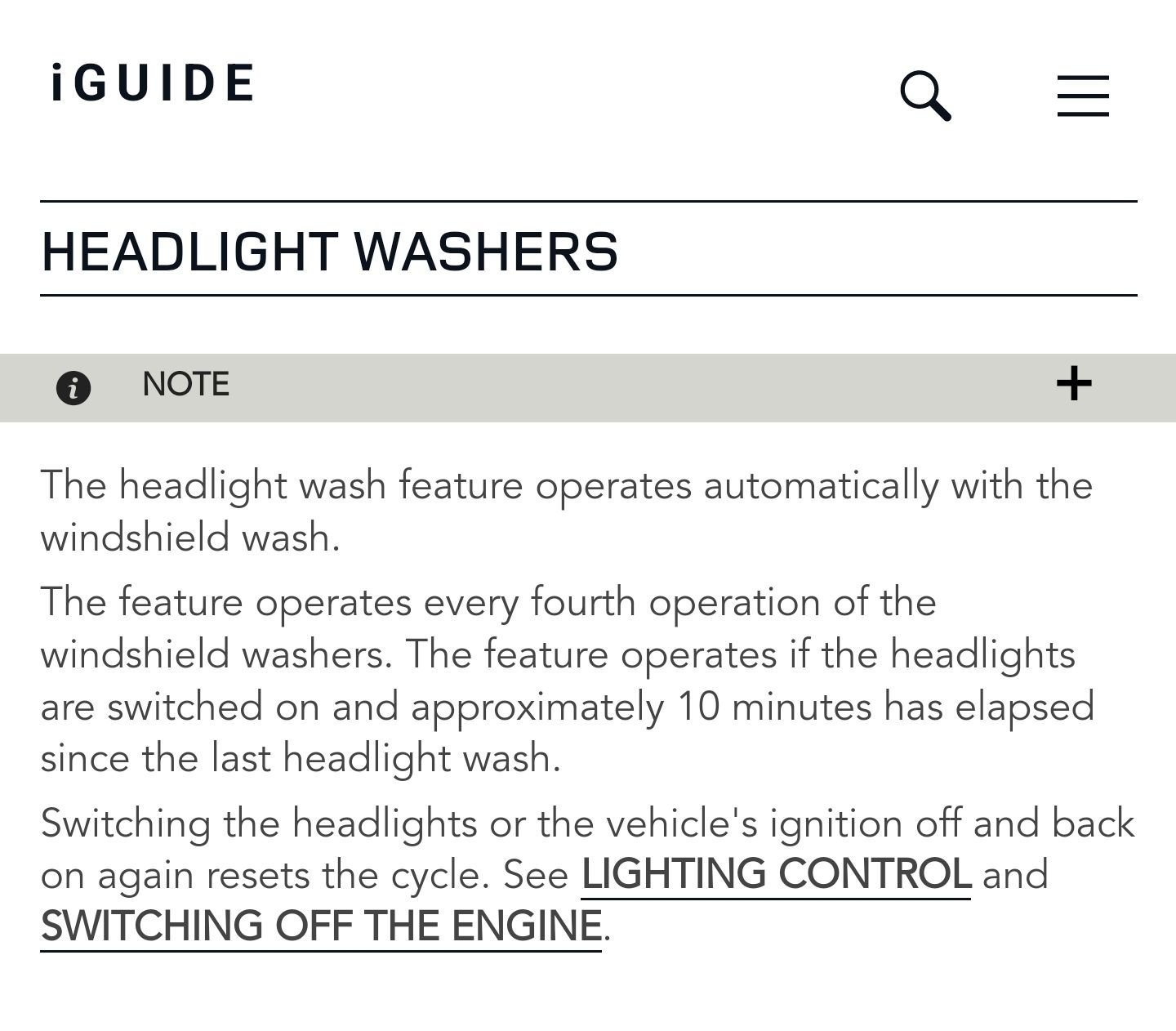

How do you test this? I don’t know that o have ever used mine.

The headlight washer is activated with the windshield washer.

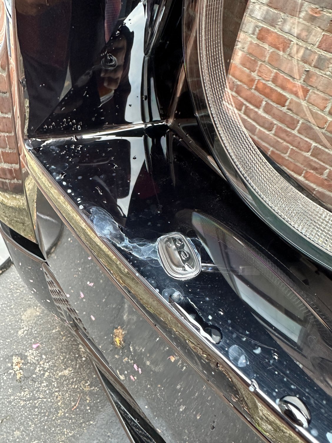

My 23.5MY X-dynamic has BOTH headlight nozzles leaking, identified within 1 week of delivery. Dealer collected vehicle from my house and took into shop for review and acknowledged the seals were defective. Mine too had awful staining from the fluid (black body so it showed up more). I had the shop empty the reservoir and clean up the paintwork. They actually did a great job at cleaning it up but I was without washer fluid until this can be fixed. Parts were on backorder and now 8 weeks into ownership only JUST showed up. Hopefully will get in within the week to install and put this behind us.

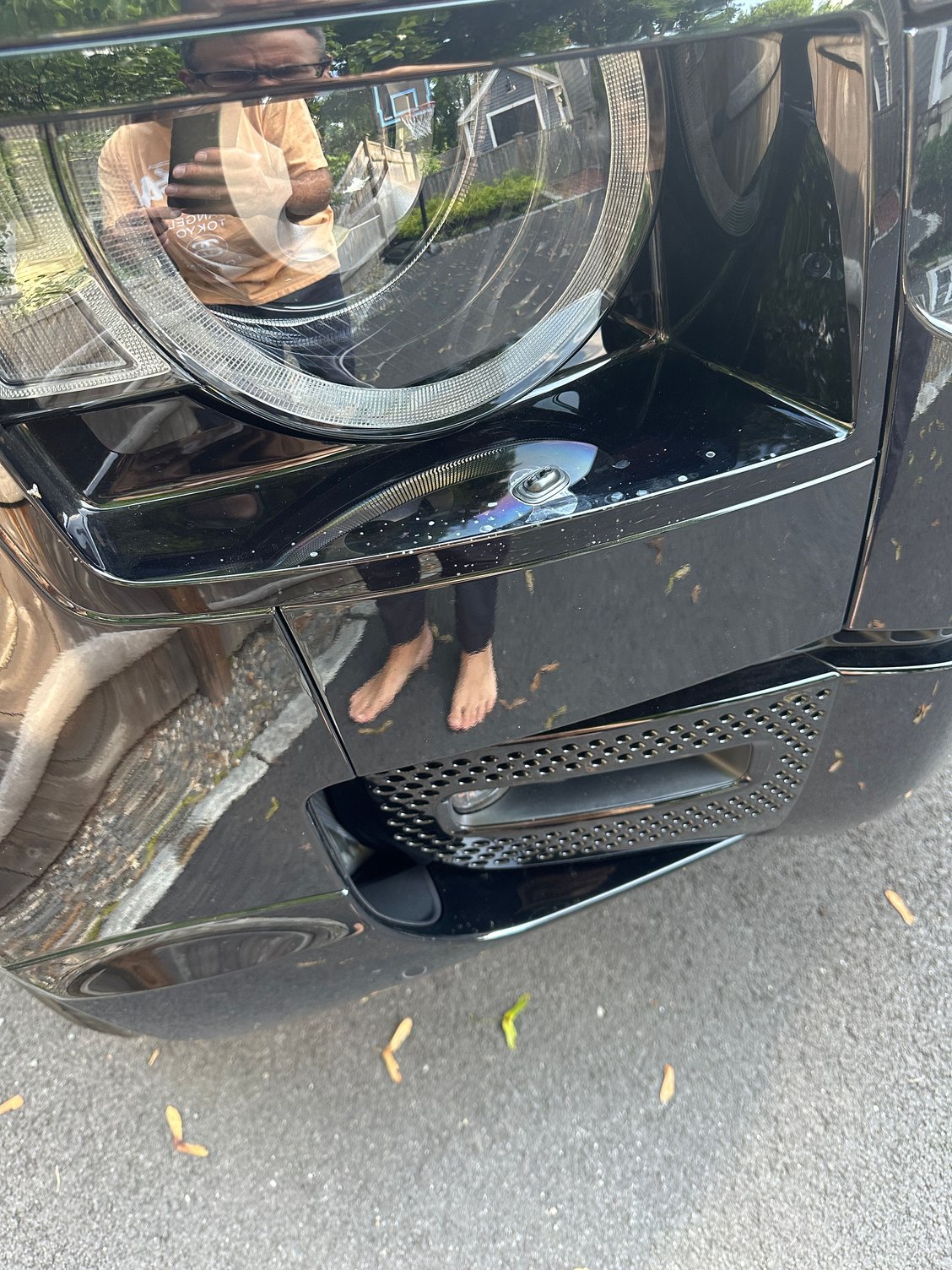

My 23.5 delivered 7 days ago has the same issue. Walked by last night and wondered why there was white stuff all around the drivers headlight washer. I've never used the windscreen washers, haven't had a need so this is just sitting there leaking like that.
