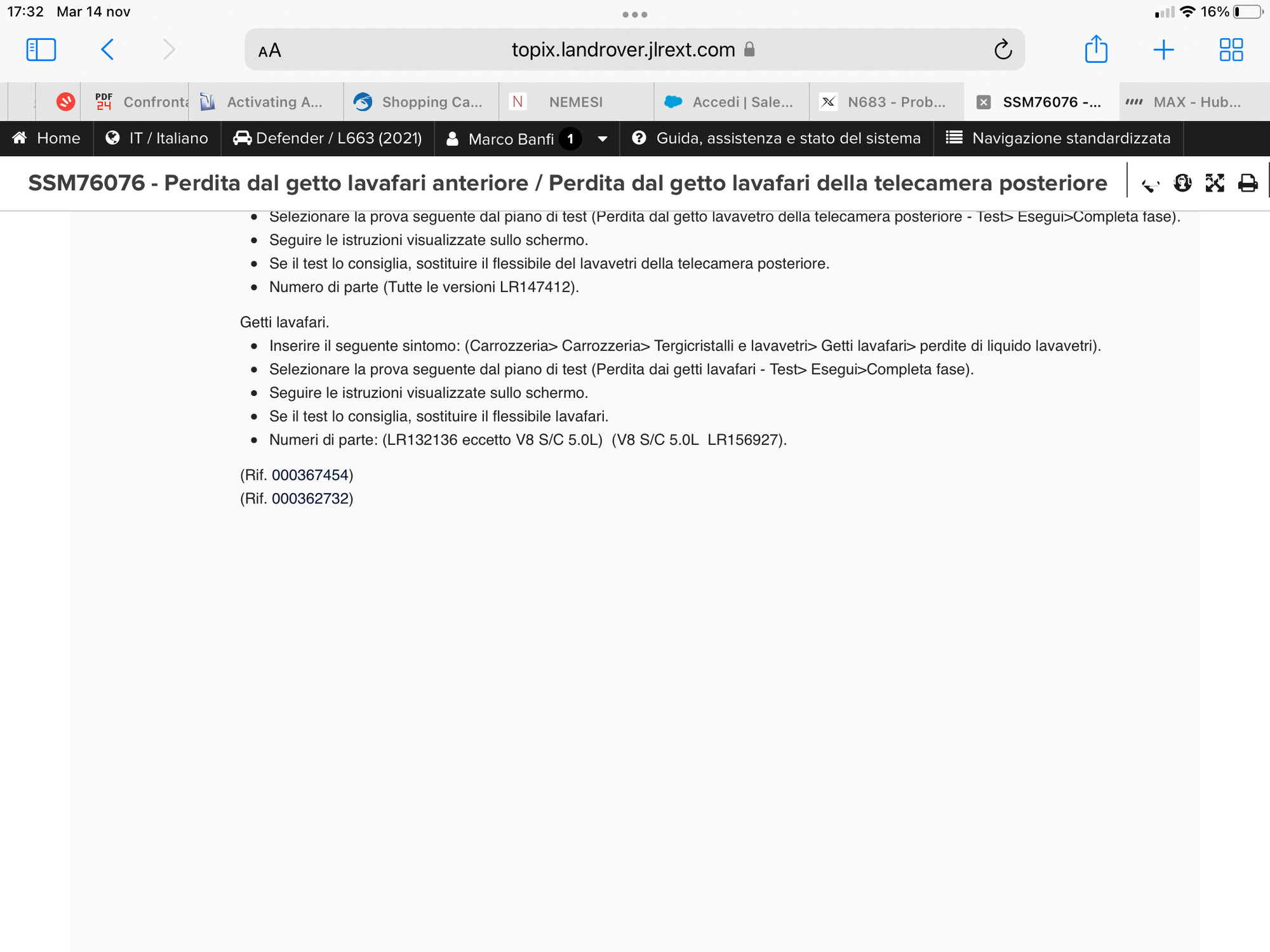

Hi everyone, there is a technical bulletin on leakage from headlight washers, the procedure involves a diagnosis with Pathfinder Jlr, however replacement of the part is recommended (sorry for the text in Italian, but I took a photo from my Topix)
Marco
Marco
THANK YOU!
The PDF (in English) = MC-10243700-0001.pdf (nhtsa.gov)
