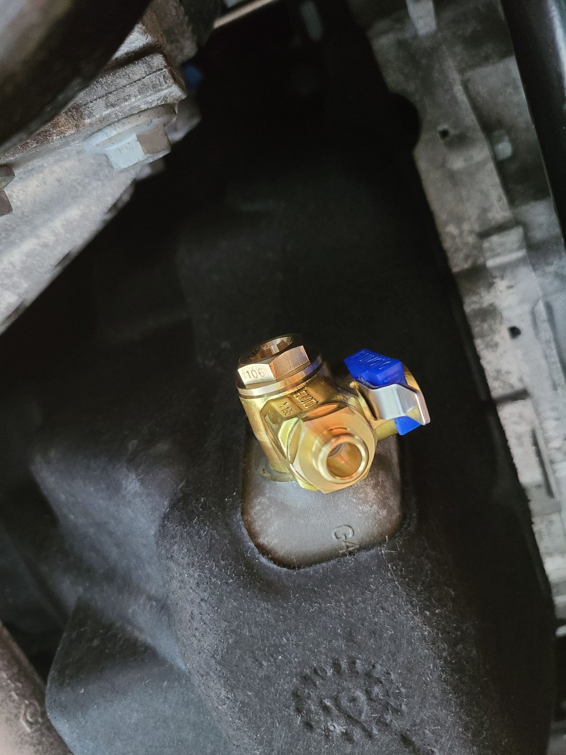

So oil changes, I got a mity vac and did my first oil change the official way. Felt pretty alien to me, was pretty sure draining would get more oil out. So the second time round I decided to see how much it was missing. Suctioned out all I could, took off all the armor plates and removed the drain plug, and managed to drain out about half a liter, which is fairly significant. Only problem is removing all the plates is a major pain in the ***, why in the world didn't they make those inspection holes in the armor a tiny big larger. One of the holes is directly under the drain plug, you can touch it, and probably could get it off with an angled wrench, but the mess it would make...

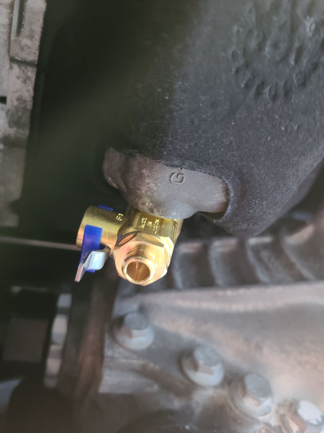

A day or two before I had randomly happened across a reddit post that popped up in my feed about a mess free oil change using FUMOTO oil drain plug valves. I'd never heard of them, but apparently people have been swearing by these for years, made in japan, high quality. Wow, these are a game changer for us defender owners, as you can get a finger on the drain plug, and the valve makes it so you can drain the oil in a controlled manner through a tube.
I get on the FUMOTO site and they don't have a listing for the defender, or any other Land Rover for that matter, but they do have Jaguar. I have a 2022 P300, and the 2022 F-PACE has a listing for a 2.0L 4 Cylinder, which maps to the F106SX . They have a few different styles, but the SX style gives the best clearance and access through the armor plates, and we definitely need it to drain at a 90 degree angle. They have these on
amazon here amazon here
, so I ordered one. Came out next day, and it was a perfect fit. I was a little worried that maybe the OEM drain plug was magnetic, but it's not. I don't know if the P400 uses the same drain plug or not, or if it's accessible through the armor. I'd have to imagine it's similar.

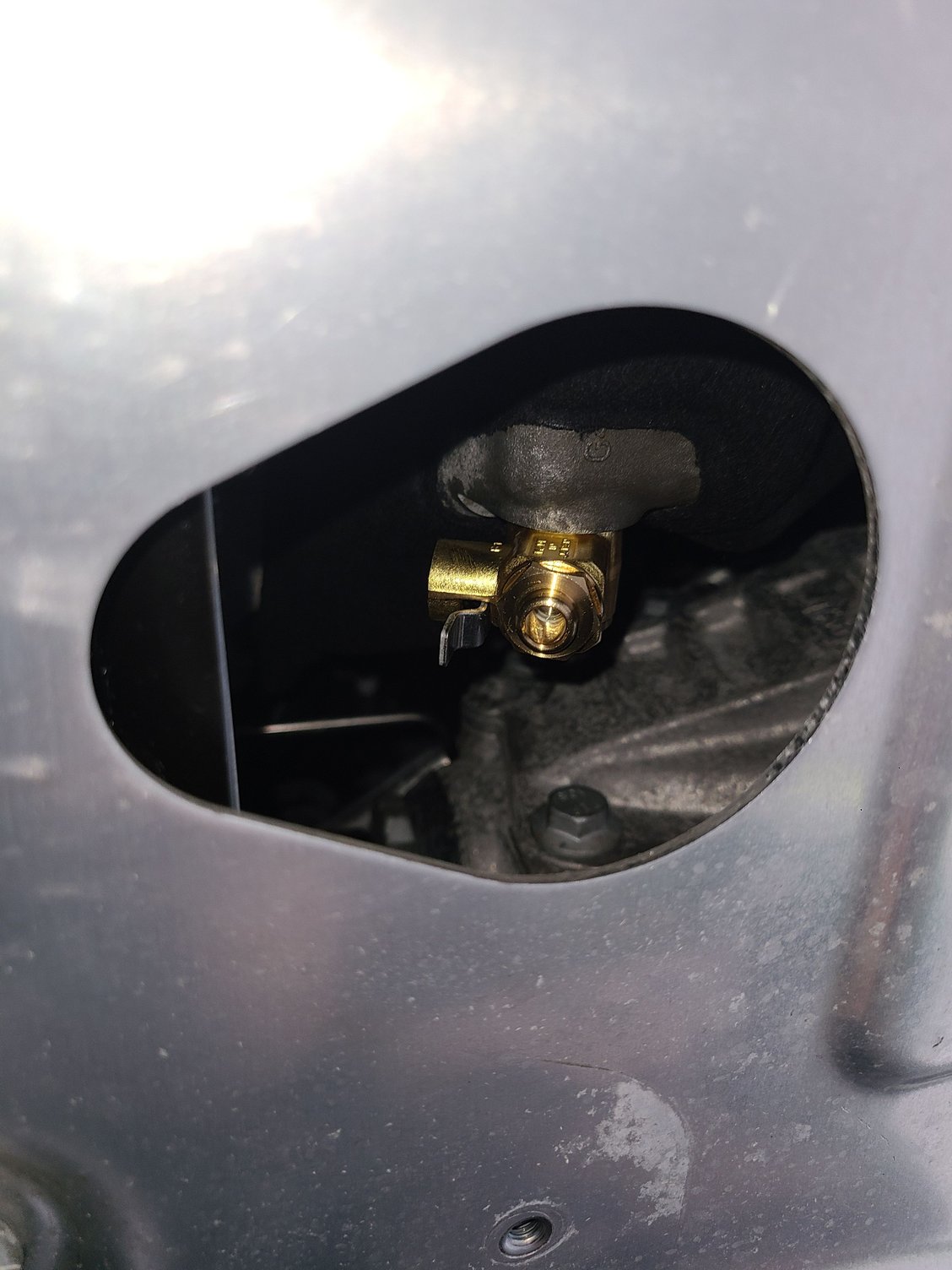

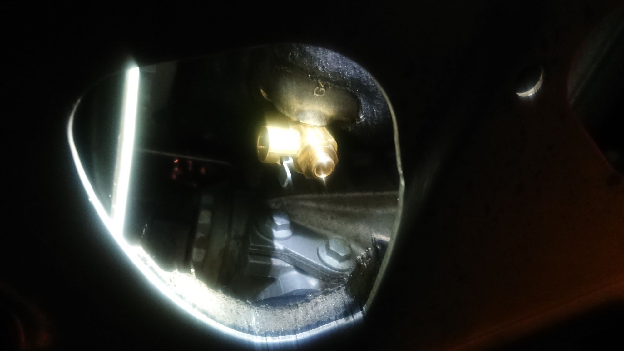

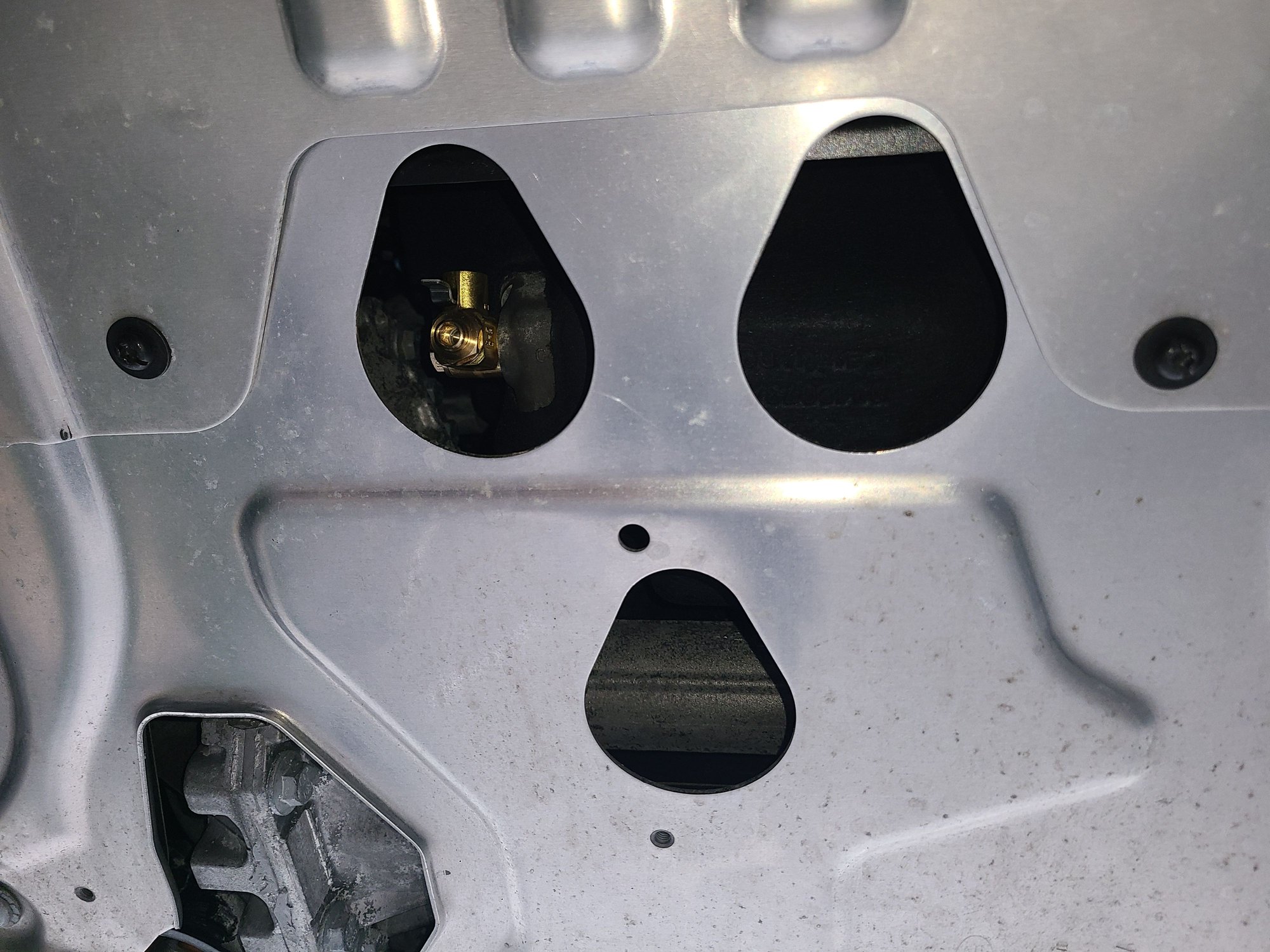

Got some pictures below of it installed, and I can confirm you can reach it with the armor on. There is enough room to click on the 90 degree hose adapter, route the hose out one of the other inspection holes, and then use your finger to open the valve. The other scenario this enables is if you accidentally overfill, you can easily drain out small amounts without any mess. I decided to leave off the blue plastic safety clip as unless you have really tiny hands that is going to be tricky to remove/install with the armor on. The armor will stop anything from getting to the valve. This is also significantly cheaper than buying a mity vac, and it lets you be confident that you drained ALL of the oil. It just has the one time cost of install, which for me meant I discovered a minor transmission fluid leak that was being caught by the armor plates. Which is really those inspections holes are actually for, so check your holes while you are down there.

' why in the world didn't they make those inspection holes in the armor a tiny big larger.
One of the holes is directly under the drain plug, you can touch it'
So I used my jigsaw to make it just a little wider to be sure the Fumoto output was free direct down under.
very easy to saw with a metalblade
Very easy now to attach the drain hose and clip.
