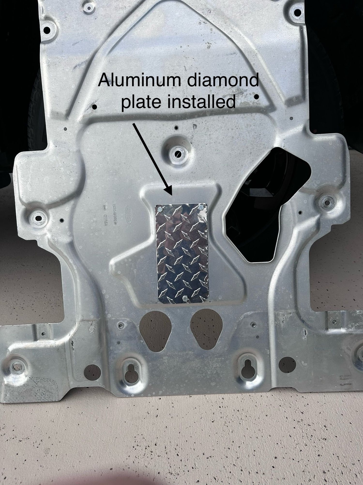

Some worried about the Fumoto drain valve becoming opened during use. My solution.

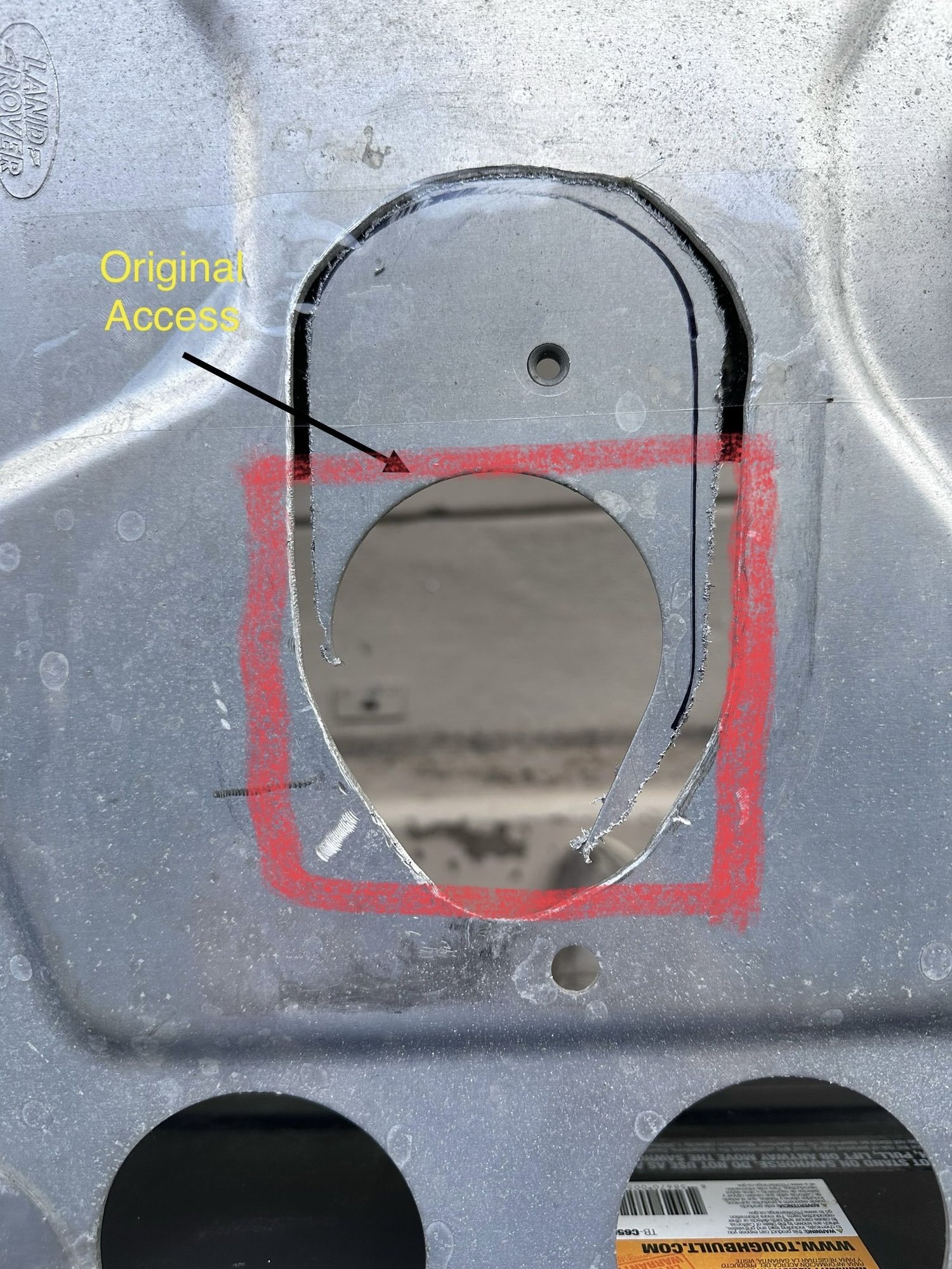

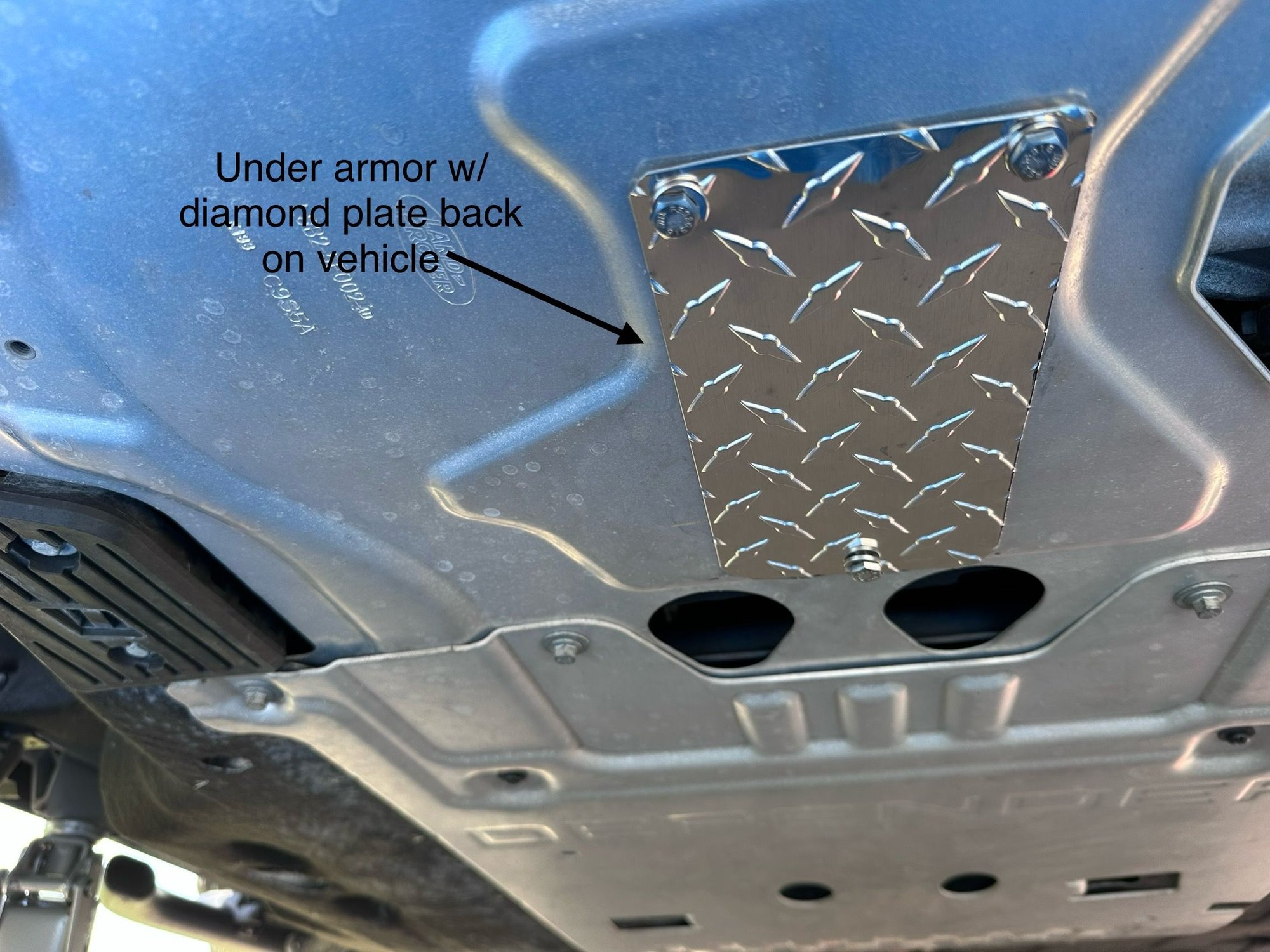

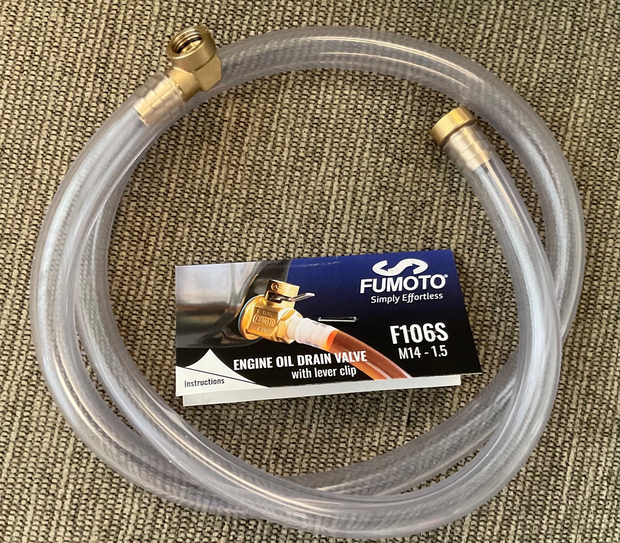

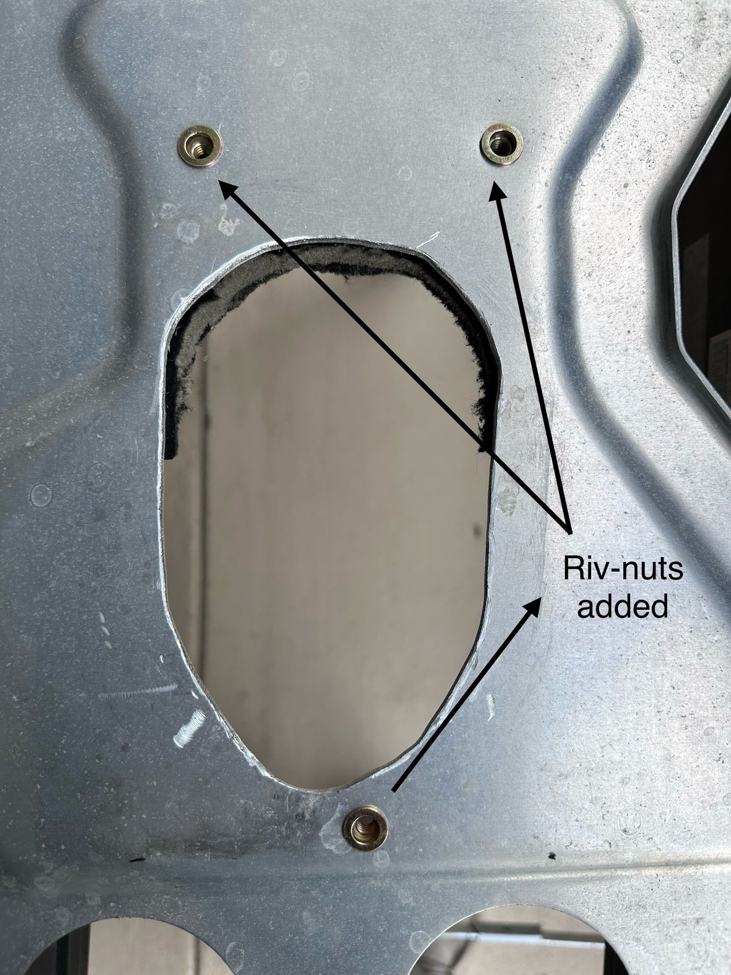

The previous post, detailing my project installing the Fumoto drain valve, shows the end result. Others have noted the accessibility of the drain plug on the P300 without enlarging the opening, but the clearances are different on the P400, which is why I went the extra distance to make the job easier. It may be possible to do it without the extra clearance but I felt that it would take a bit too much wrangling to make it a simple process. I went with the F106S, which came with a drain hose, and both a straight and 90 degree snap on fitting. Oil changes are a breeze now. (And I can attest that the force, position and dexterity to flip the lever to open is such that no branch or kicked up gravel or rock will cause the valve to open unintended, as others have expressed fears of happening. But to add extra insurance to that possibility, I added the diamond plate cover. If you decide to skip that step the chances of that mishap range from extremely low to near impossible.)

The photo of the drain hose shows the straight and 90 degree angle snap on fittings both inserted into each end of the hose. I place them both that way so as not to lose either but I use the straight fitting usually, removing the angle one from the other end before I stick it into the catch basin. If you notice the picture on the packaging, the fitting is white and made of plastic. When I received my valve from Fumoto inside the package was a note from the company explaining that the fittings were previously made of plastic, but in response to customer feedback and technical changes, they decided to upgrade the quality of their product and changed over to brass fittings. It has a snap ring which connects to the nipple on the valve with a solid, reassuring ‘click’. Props to Fumoto for the improvement.
