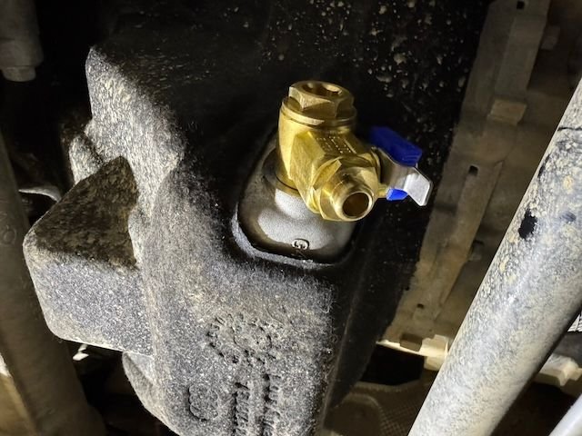

I bought this valve, though after closer inspection, opted against installing it as I use my vehicle off-road regularly.
The plastic lock is flimsy. Any random stick contact through the armour and that plastic comes off. You'd be unlucky but it can happen.
I really wanted to install it, but the consequence of draining oil when off-road is too high a risk for me.
I will stick to removing the armour for intermittent oil changes, like they do for scheduled servicing.
After installing the valve, one could get a piece of scrap aluminum and make a cover to fit over the opening. I plan on doing something similar, but go one step further and using Riv-nuts fashion a swing away cover which pivots on one riv-nut fastener. Just remove one bolt, swing the cover out of the way, open the valve, drain the oil, close the valve and replace the cover. Easy oil changes from then on.

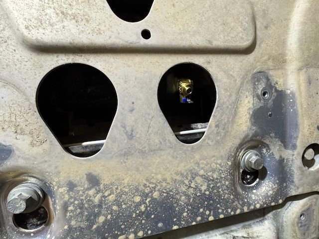

This thread has been great. Added one to my wife’s 130 P400 today. Fit great and I cut the skid plate hole a little bigger. I plan to use a drain hose with it just to make things really clean. I ended up angling the valve body up a few degrees which puts the handle up more and out of the way. I am not worried on her car as it never leaves the road however my 110 does and when I install one on the 110 here soon I will most likely fab a cover for the access hole. With that said I will argue that I doubt it is possible for a stick or something to open the valve. The valve handle rotates to the front meaning there is more likely a chance of damage to the valve or handle than if opening. A cover is an easy option so why not.
on another not the skid plate already had two holes around the access. One was threaded for sure as I looked at it after I had cut it out doing the expansion. You can see the other one towards the bottom between the two lower access holes and the upper one I cut. Again I am not concerned on the 130. If my 110 plate is the same I will adjust my cut to leave both and just use them to fix a cover over that hole. Will post some pictures once I do the 110 closer to the end of the month.

Just a little update here, finally actually used this after installing at last years oil change. it is absolutely game changing, not only fast and easy, but zero mess at the same time. it's also super easy to drain small amounts out of you overfill.
Can also confirm that there is no need to trim the skid plate hole assuming you use a drain hose, access was still very easy through the factory cutout, at least on the P300.

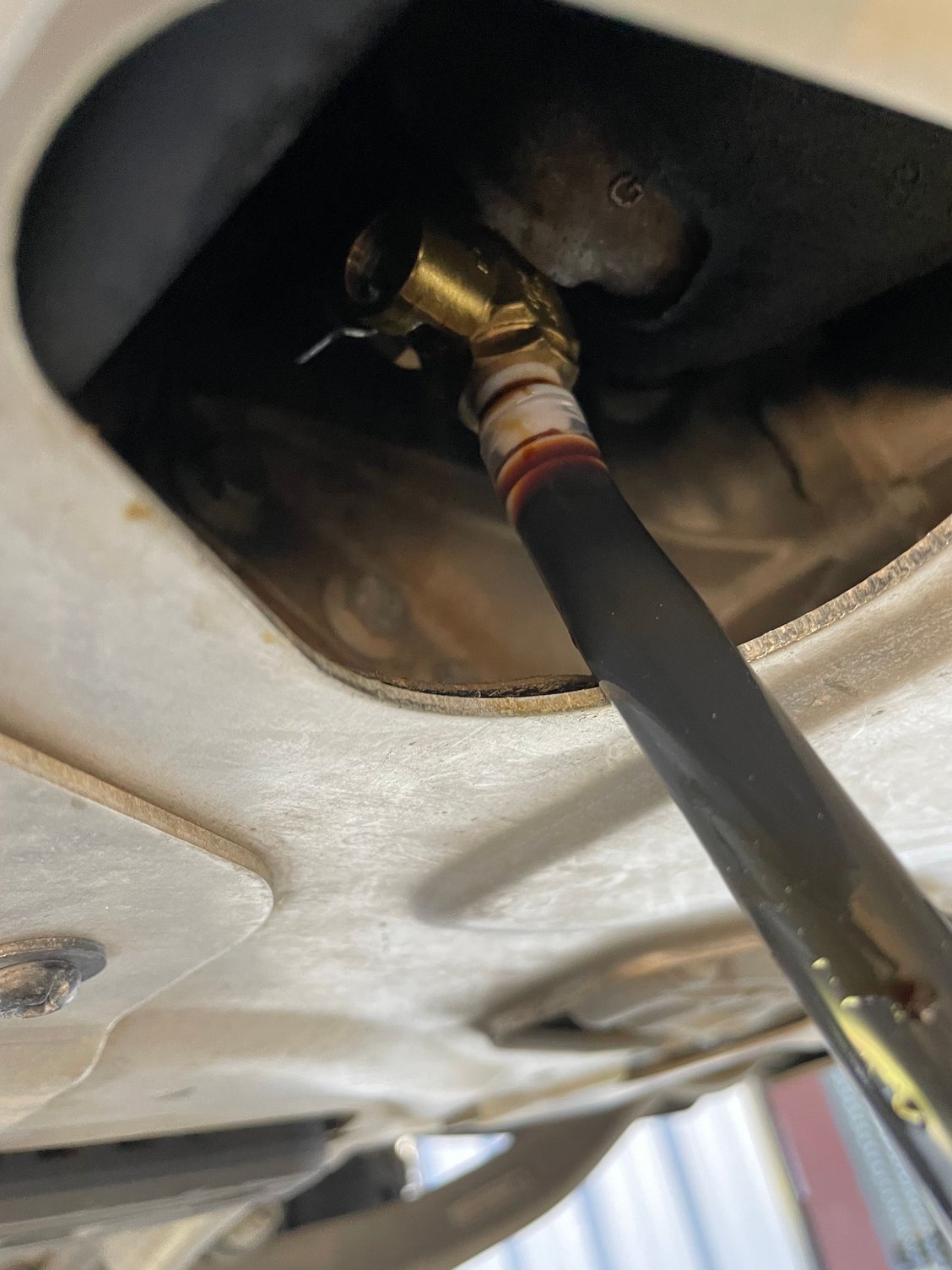

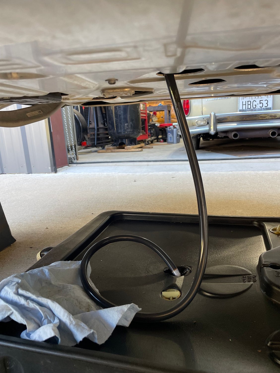

I agree. Here is the hose connected and draining on ours. No cutting of the under armor plate.
