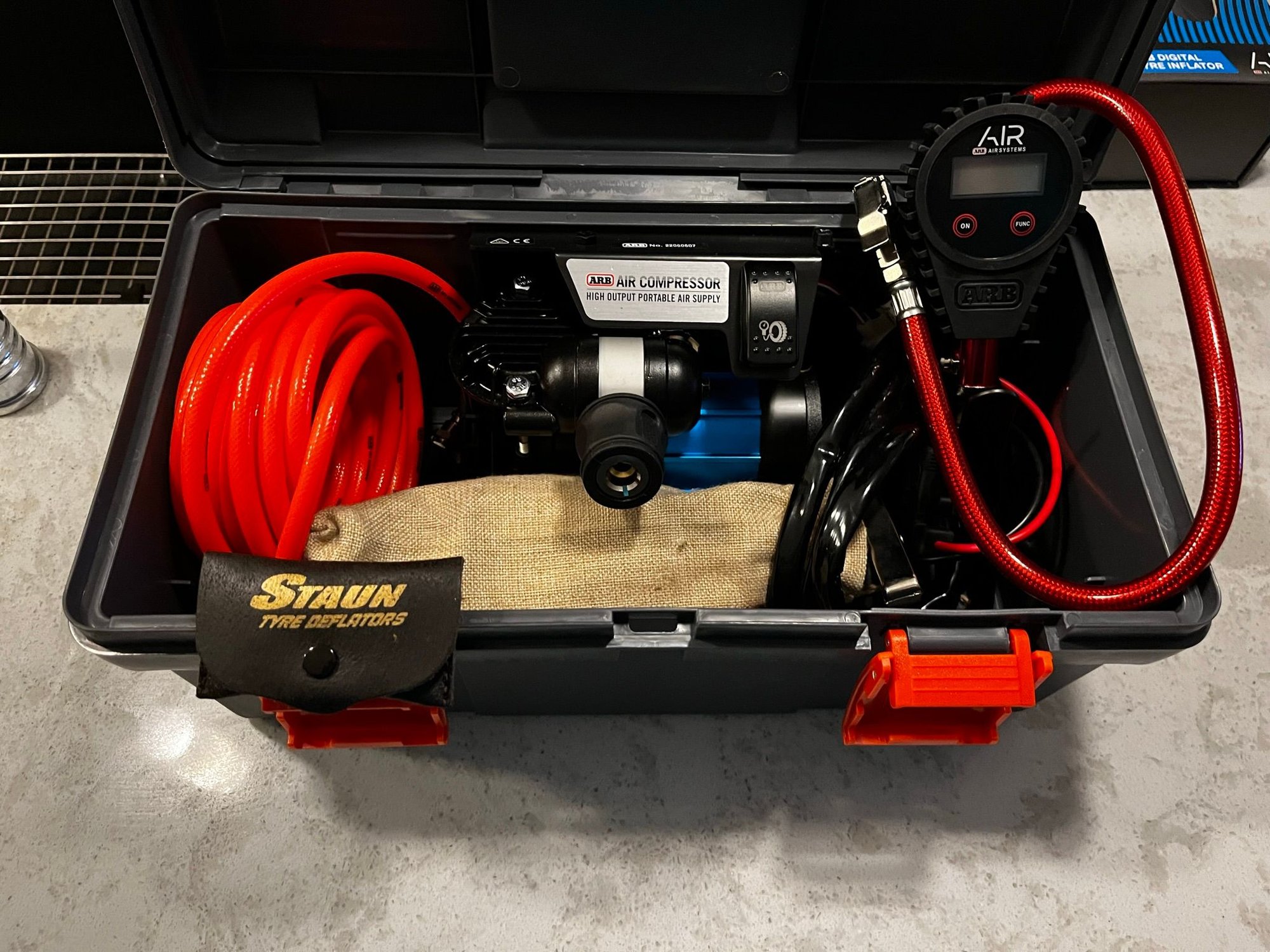

Get a 12V compressor. Hard to beat ARB built in or portable. I have the latter. No complaints. 10-15 mins or so to inflate all 4 tires. A nice bit of time to chill, chat, shoot the breeze, check the rig for cuts and scrapes, remove any tree branches etc. A nice little relax before heading for home on the blacktop.

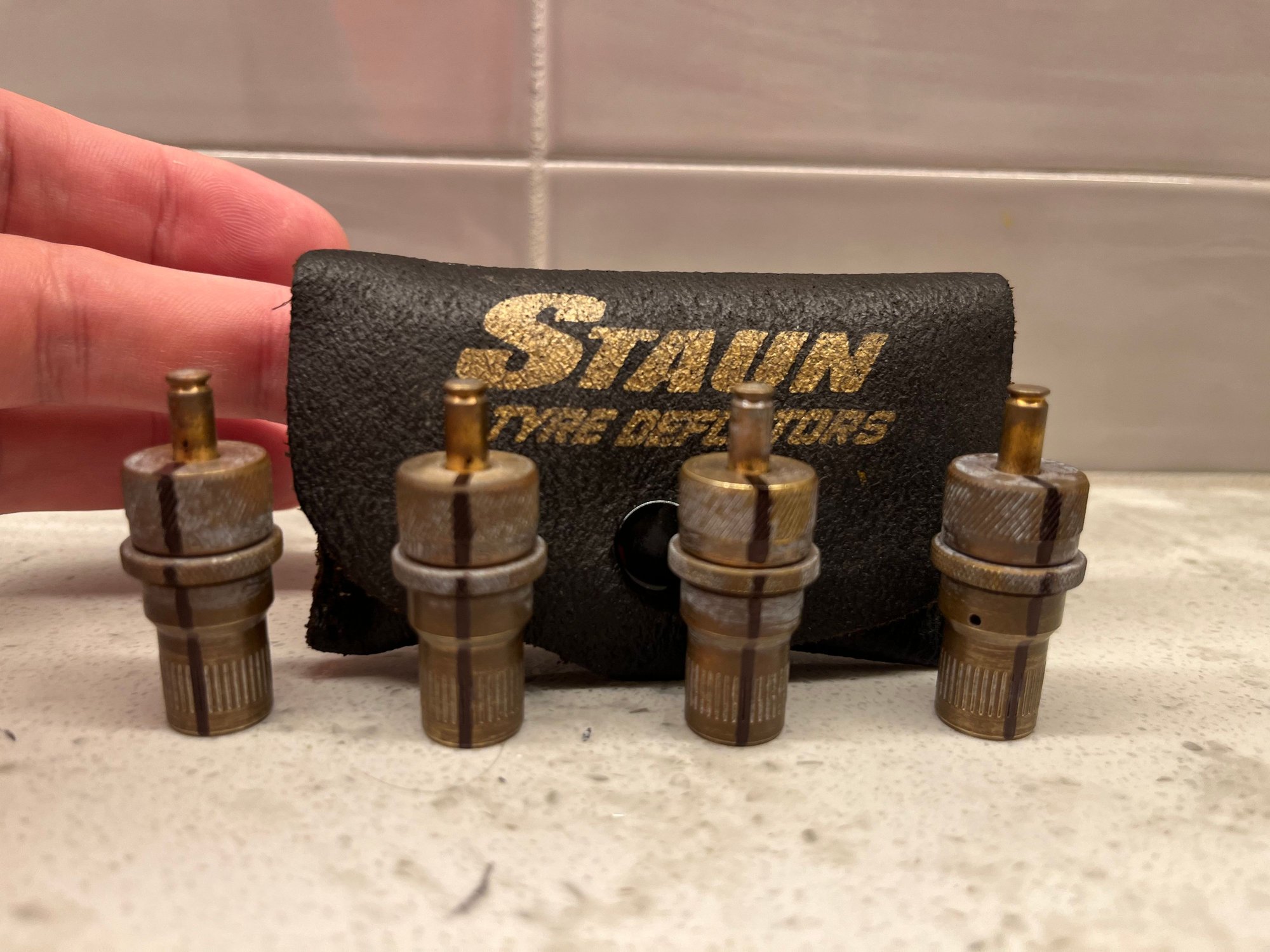

Airing down takes about 3 minutes with Staun deflators. I'm usually close to done by the time I've lapped the vehicle to screw the 4 in. I have them calibrated so I know what 1,2,3,4 etc turns of the deflator will bring. Very handy.

I have the same ARB setup that @GavinC just showed. It works GREAT and is very portable. But it DOES take up a bit of room. I have plans (I have LOTS of plans) to install an ARB under the hood. I would like to mount mine ON the hood. I have a mount, just haven't picked up the ARB.

Oh and Pro-tip: That digital inflator/gauge on GavinC's photo is the BOMB. It's life changing when you finally get one. In fact, I now use it on my shop compressor a LOT more than I thought. I should have bought one of those YEARS ago.

A nice bonus of having the ARB inflator gauge or something like it, is that you can do it all hands free for the most part. Wedge the inflator handle between tire and either the ground or the wheel-well and let it do its thing. I can monitor my psi live values via my GAP tool so know when I'm there or thereabouts on each corner. A couple of final squirts of air by hand and I'm on to the next one.
Built in compressors are handy for sure.
But I also use mine to winterize our home's sprinkler system and to adjust my other vehicle's tires as needed. That's an advantage of the portable compressors I suppose; their portability.
With all the other stuff I have when I'm camping or wheeling, the space demands of the compressor are largely insignificant. From a volume standpoint, it's a touch larger than the OEM built in. Also, I use the box to store my tire pugging kit, replacement valve-stems, Staun deflators, and some basic tools. I don't see portability as a down-side really.
