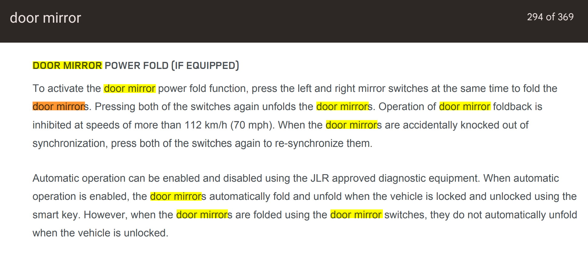

From the service manual. It's a dealer configurable setting.

It can easily be done at the dealership or anyone with the factory diag tools. Pathfinder or topix cloud. It is in the service menu under customer personalization features. There are a few other settings in there. This is not one of the features that require ccf editing, so should just require an appointment.
