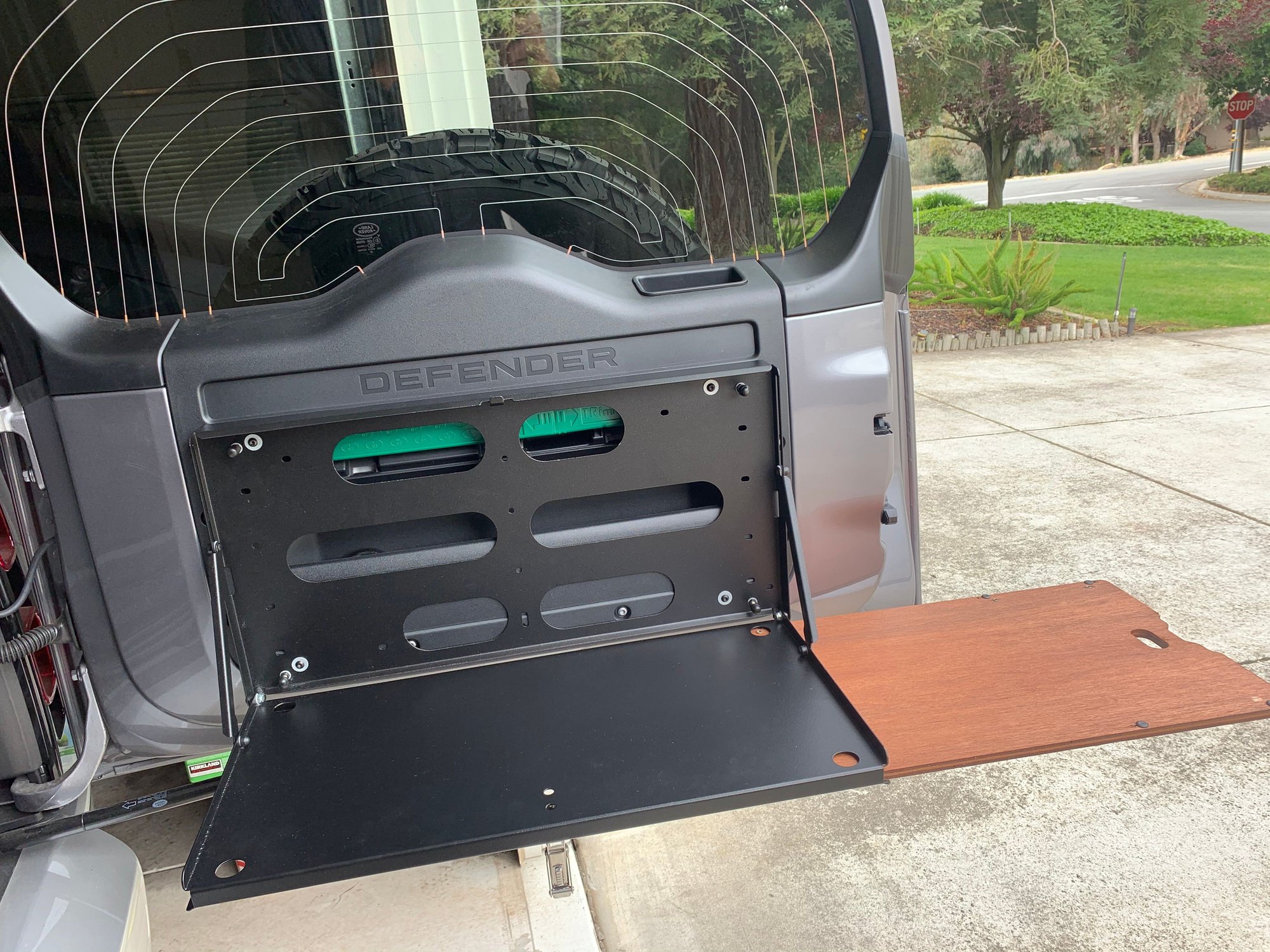

This is what some others have done: https://www.defender2.net/forum/topi...ko4ZOFZ-T2o8bk

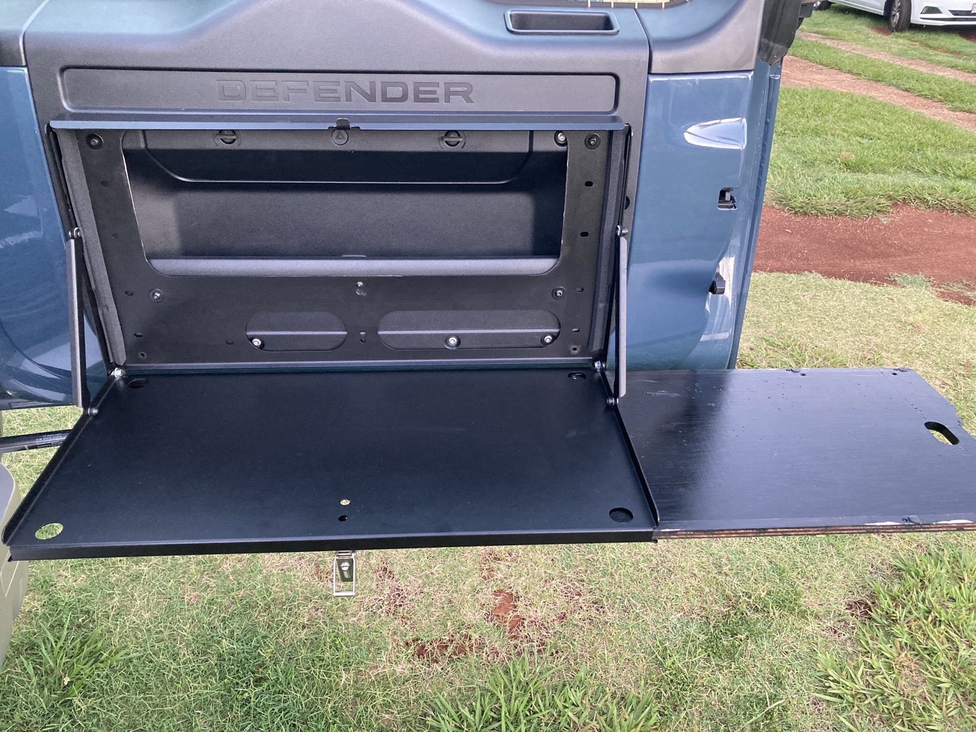

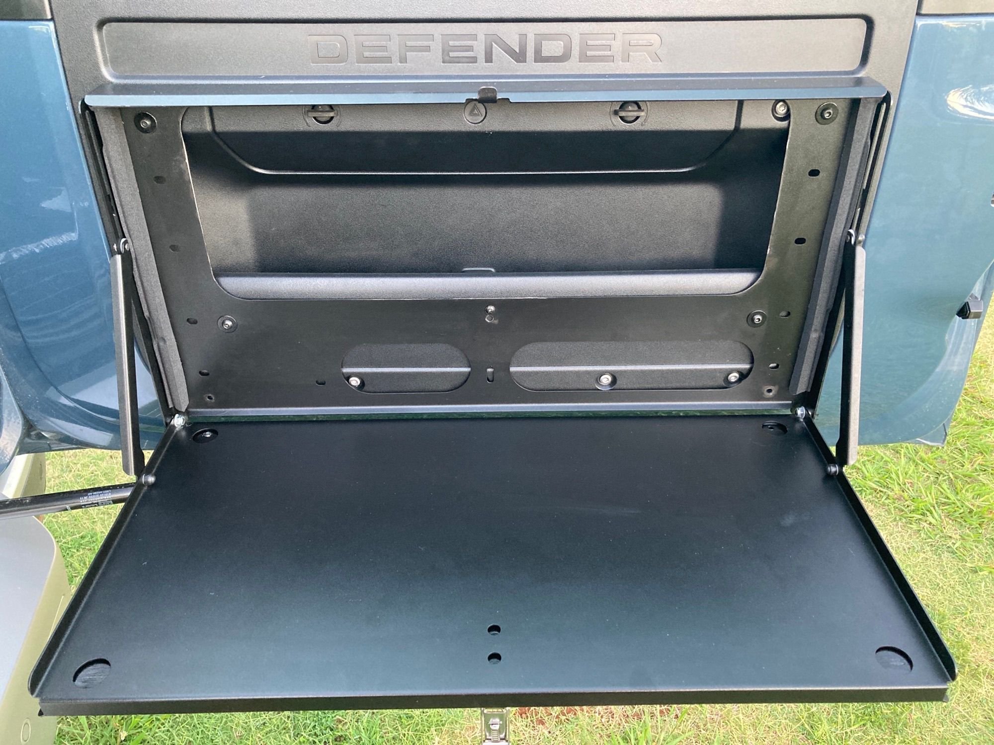

for anyone interested in installing or adding. This was actually a very easy install. I did not end up using the back plate included and not sure if it’s actually needed. the table wasn’t made for the defender but fits perfectly. unlike the pics on the other forum the holes lines up perfectly and centered to the rear gate.
not intending to put anything that heavy so it should hold up
great add to the truck. the kit includes various m6 length bolts and spacers and everything you need to install

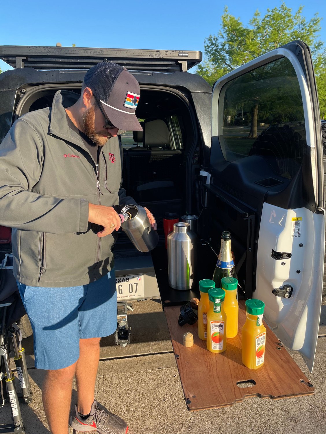

Love mine, used it this weekend for mimosas for the kiddos softball tournament

we did the same last weekend. some tailgating in the parking lot at my kids events. very handy

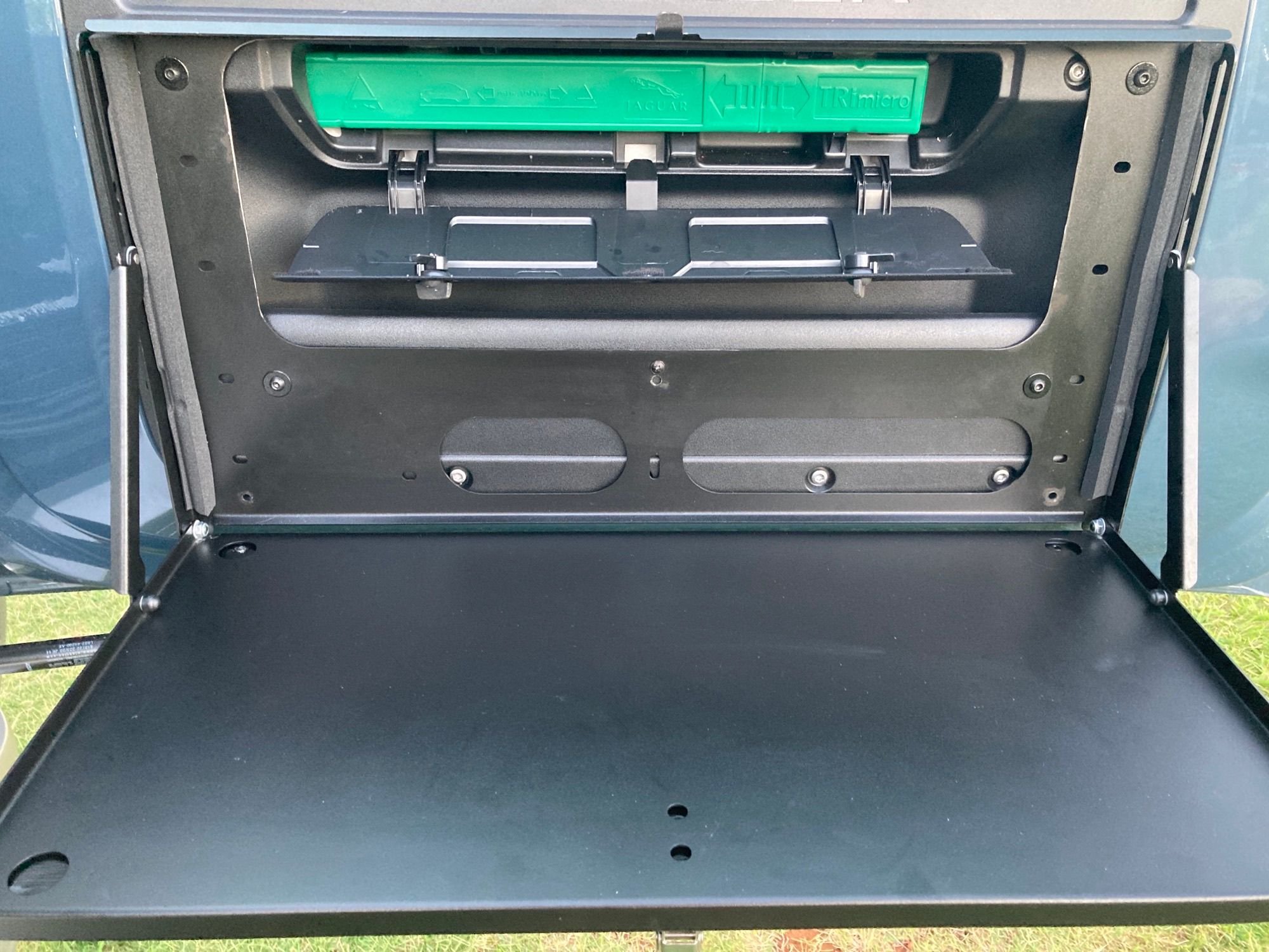

I also installed one of these tables a few months ago, but wanted access to the door pocket and warning triangle recess to remain, and also wanted the thing to sit centrally on the door (as my OCD would not live with the slightly off-centre mounting) so I attacked the backplate with a holesaw and cutting disc, and this is the result...
I'm happy with the result, but had to add the two rubber strips you can see in the pic, as it rattled like hell without them.
