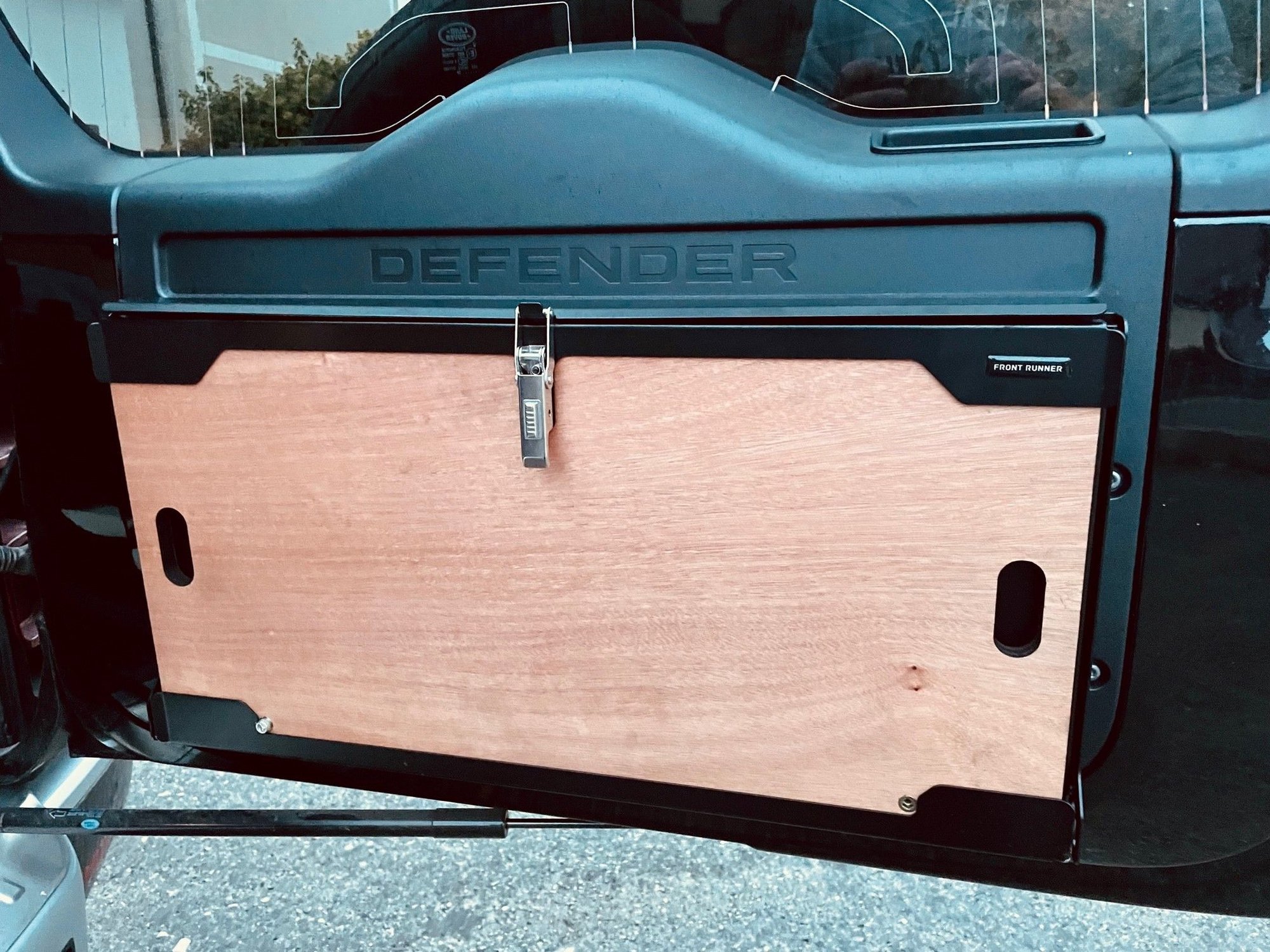

The new Frontrunner table fits perfectly on the Defender and installs in 10 minutes.
getting ready to install mine as well. Did you use the back plate?

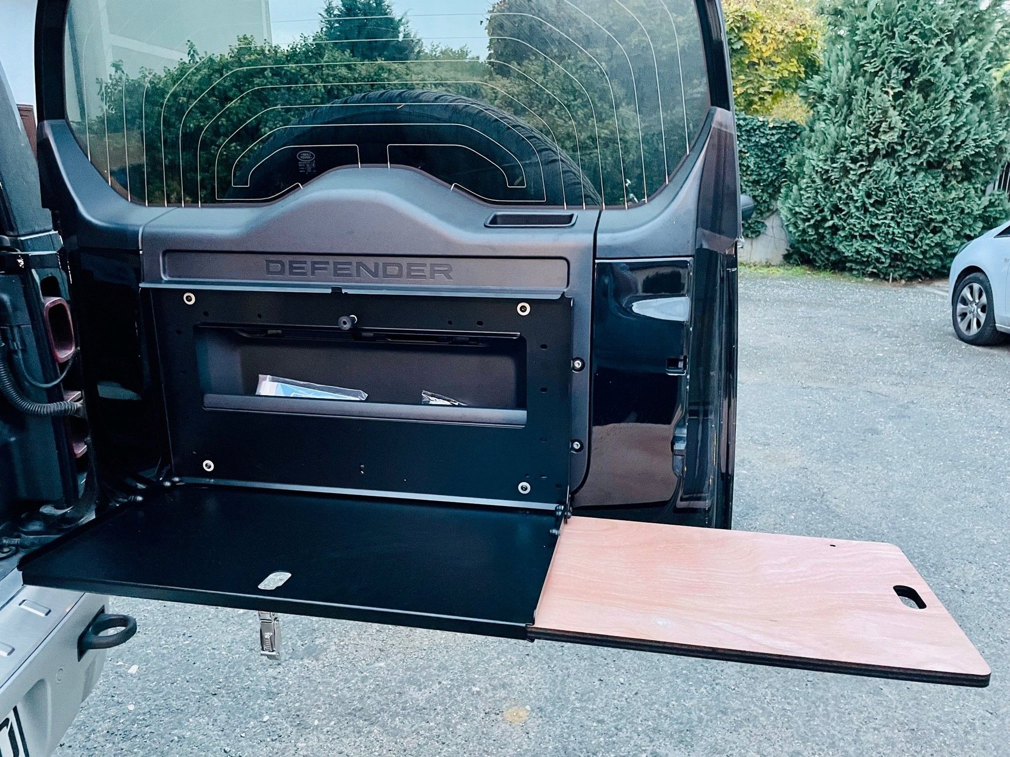

Originally Posted by Ehloo
for anyone interested in installing or adding. This was actually a very easy install. I did not end up using the back plate included and not sure if it’s actually needed. the table wasn’t made for the defender but fits perfectly. unlike the pics on the other forum the holes lines up perfectly and centered to the rear gate.
not intending to put anything that heavy so it should hold up
great add to the truck. the kit includes various m6 length bolts and spacers and everything you need to install
link please…. Any modifications required or plug & play? Thx

Originally Posted by Oldmowgli
I also installed one of these tables a few months ago, but wanted access to the door pocket and warning triangle recess to remain, and also wanted the thing to sit centrally on the door (as my OCD would not live with the slightly off-centre mounting) so I attacked the backplate with a holesaw and cutting disc, and this is the result...
I'm happy with the result, but had to add the two rubber strips you can see in the pic, as it rattled like hell without them.
Oldmowgli
Thanks so much for that. My OCD was kicking in just looking at the OP's pics.
