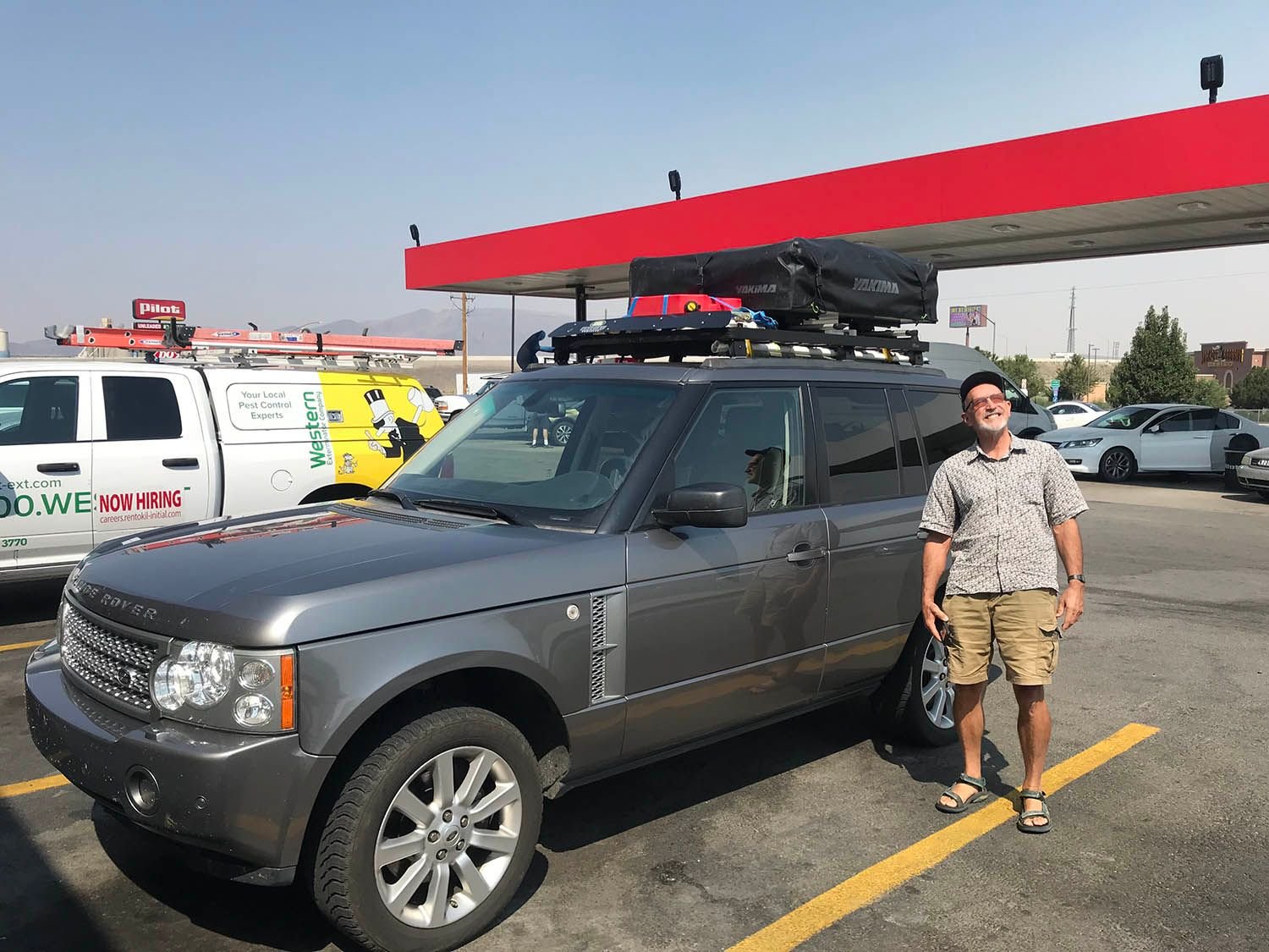

The rack is 2" thick, add 3-3.5 for the feet so it is 5"-5.5" high. I already had this rack, which I used on the Range Rover before. So I kind of ordered the Land Rover one on a dare with the car. The Voyager is nice looking, but appears a tad heavy. The Slimline is heavier than the Land Rover one, since it is a rectangle vs a trapezoid with a cutout. It is a very personal thing, depends on what you throw up there and which on's appearance you prefer. It seems to me that all the racks mounting system's tracks are the wrong size for pretty much anything you want to throw up there. Necessitating buying or making a bunch of adaptors at a couple of C notes each. The Series III I had in Italy, had this humongous steel rack with no mounting points on it. You just tied everything to it and it kind of resembled a Mexican bus loaded. I shipped it back with the vehicle, why I don't know, different times. On the plus side, you could get 4-6 people up there for Sundowners, without a squeak.
