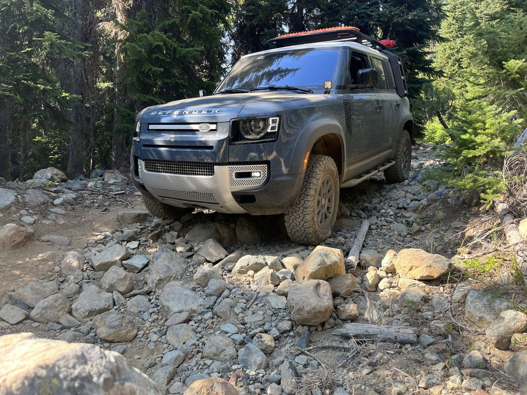

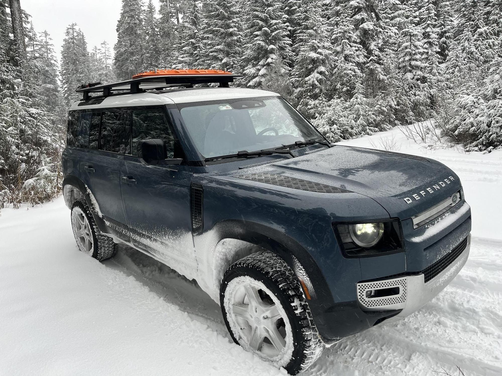

To my eye. Not bad at all on OEM rims but it's very subjective. Personally I don't like the idea of running spacers for a number of reason but sometimes it's needed to fit very much wider tires. 315 aspect ratio 35" require spacers.
OEM rims offset +41.5
Aftermarket rims Offset +29
