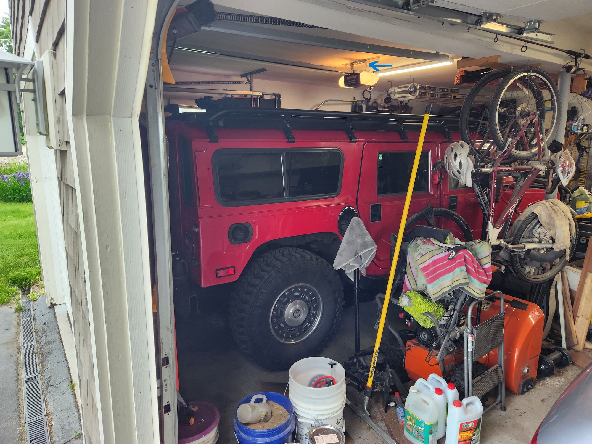

I have asked my garage door guy about this height issue since I'm going to be slapping some 40's on my hummer later this year and I might be getting close to the top of the garage door with the roof rack.
He said that they need 10" of space between the garage ceiling and the door (indicated by my crude blue arrow in the picture - please excuse my disaster area of a garage) for the opener equipment. So if you have a higher ceiling inside your garage - you can get tracks run that can lift the door higher up. Unfortunately mine is as high as it gets.
I don't know if he brought up the fact that side openers exist by now - from my semi-educated recollection, you can halve that space because all you need to have above the garage door frame is the rails. However, there's a catch unless you have a "high lift garage door conversion" (not your case) - they need some sort of force for the door to go down otherwise they just produce slack in their cable and refuse to operate. Two ways to achieve that; either have the door balanced slightly overweight (also not your case because it will go completely flat), or have a "garage door pusher spring" installed to help the door to return to the point where it will go further down under its own weight. Those springs tend to screech nastily, but I'd say it's a small price to pay for all the space you're getting - and potentially getting the vehicle into the garage to begin with
I have the same problem - mine will likely not even fit into the garage except at access height if at all. Been thinking about the ways to prevent serious damage ("it is not if, it is when you get tired and make a mistake"), and am now seriously considering installing a contraption similar to the one below - except that this one seems to be heavy, but I'm thinking of rather something light that produces a very audible sound when hit - possibly a big aluminum tube. One complicating factor is that I'm sure as it is for lot of you folks, my driveway is at the angle to the garage floor plane, so the only way to get this right would be to actually calibrate the damn thing after it is installed
