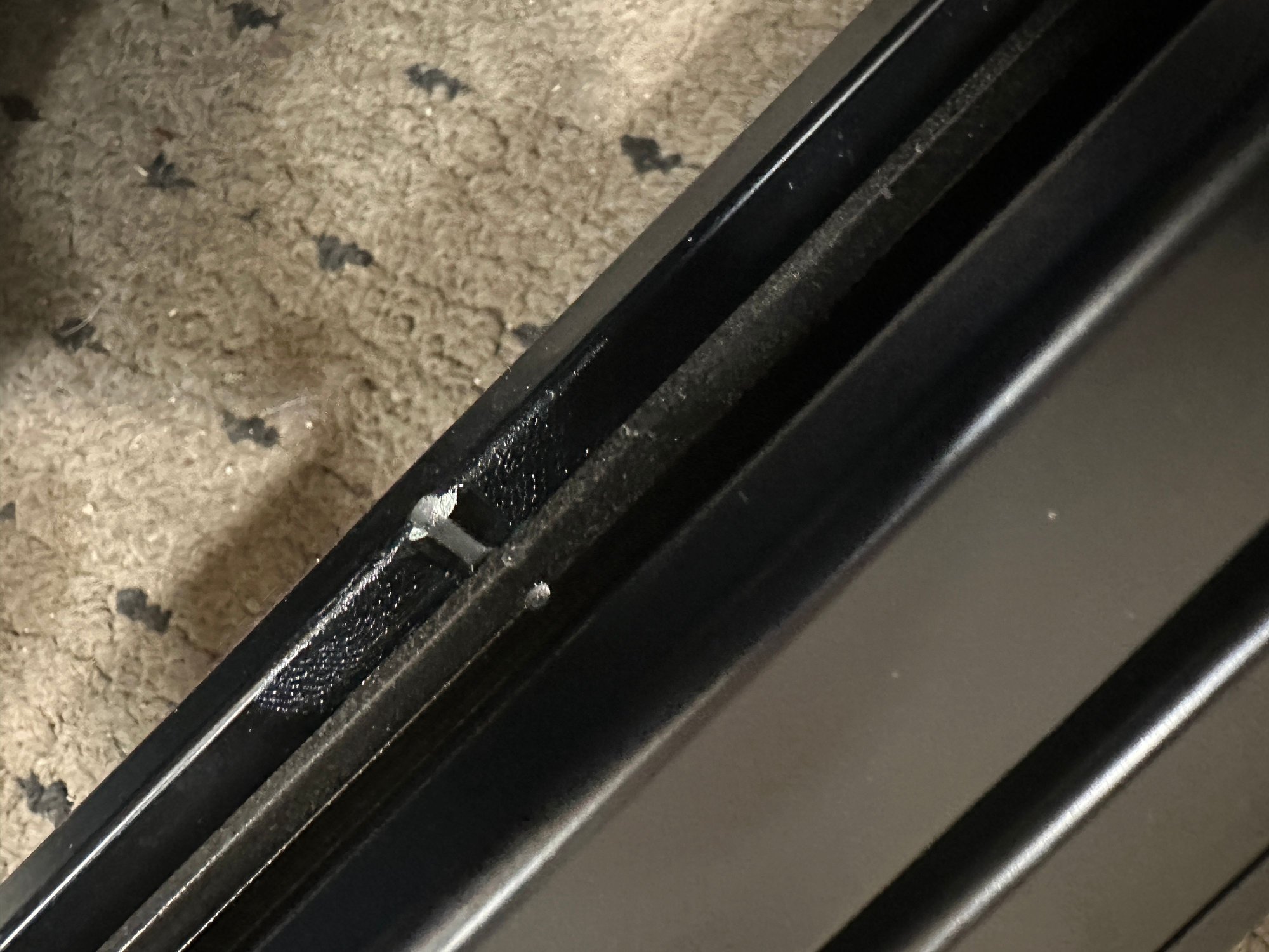

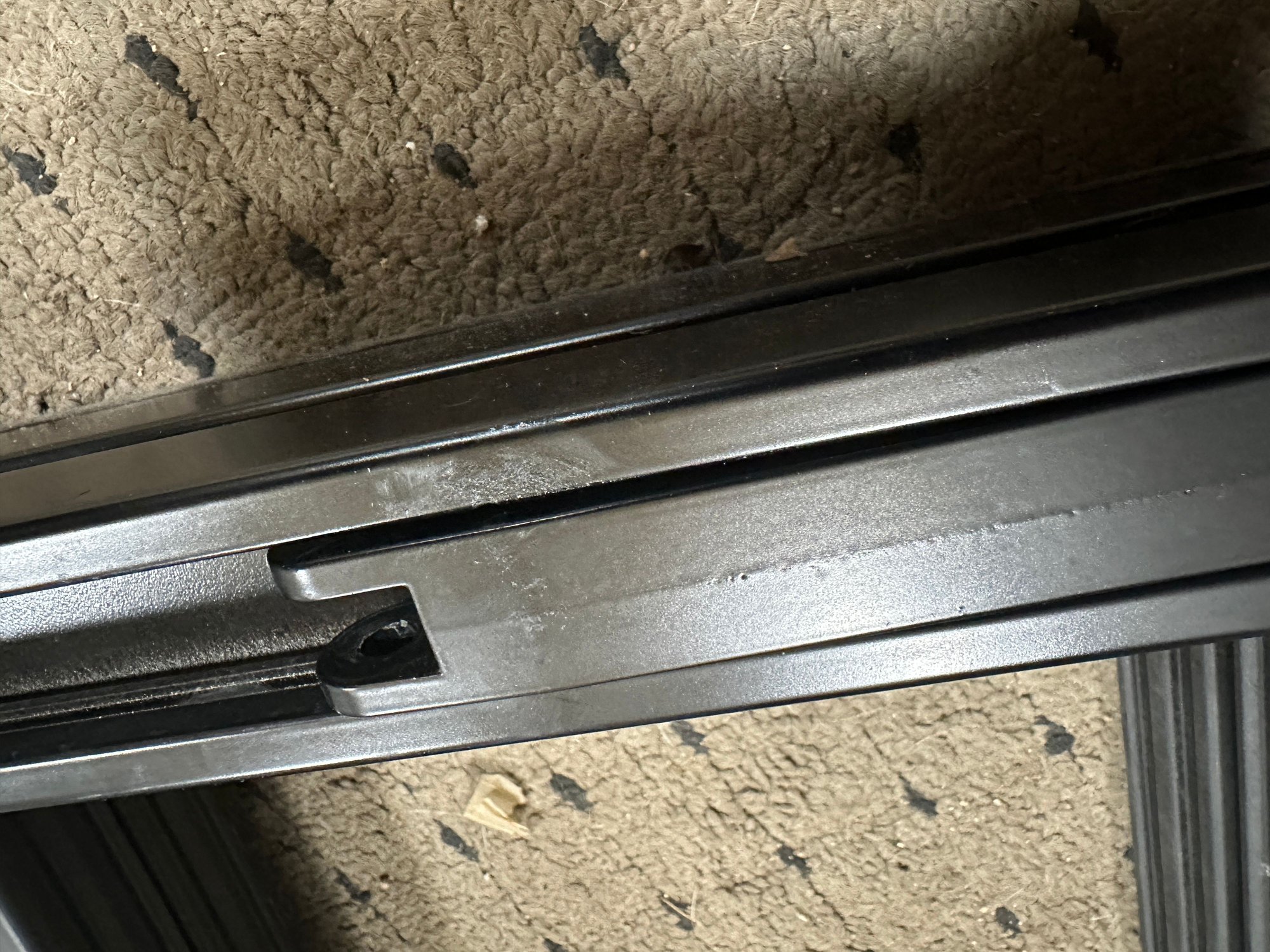

I made my sticker ladder much smoother. I decided to undo for bolt to remove the ladder from the frame to see what's going on. It turns out there are for stainless steel spring loaded bearings that snap into the aluminum groove in the ladder. Two on each side, top and bottom. That's why you have to pull on the top and the bottom to get the ladder out. They are also VERY STIFF. So stiff I can not depress the ball with my fingers, but only with pliers. They are on a very strong spring to keep it in place. The spring is so strong the stainless bearing is actually carving a groove in the aluminum. When I had it apart I put some thick grease on all four bearings. Hopefully it stays in place, but the ladder is much easier to deploy now. See pics below.
