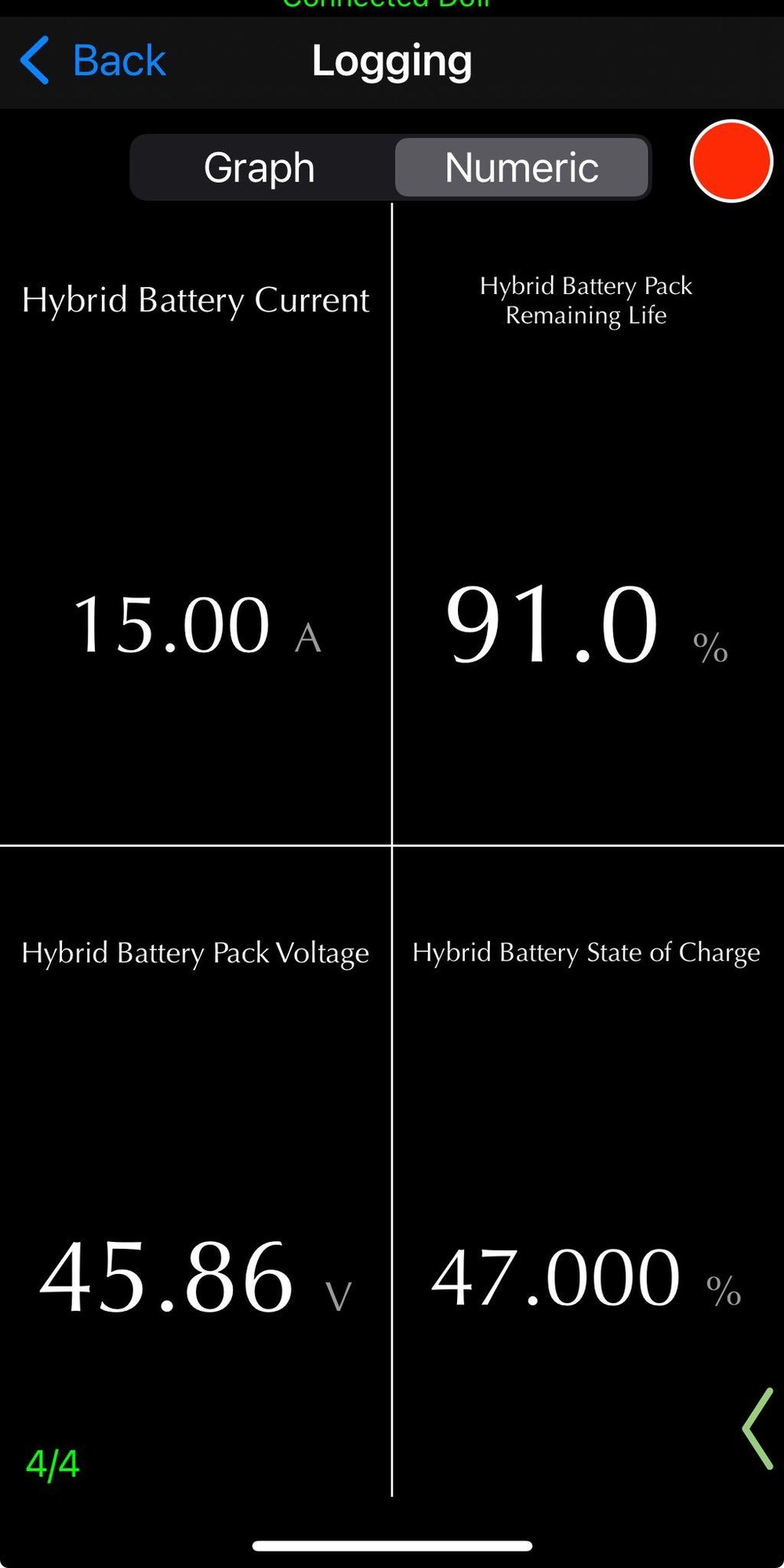

Yes. It's a good video. Got me inspired to check my own. 91% at 4+ years.
It's kind of fun to watch these live values as the car is driven.
