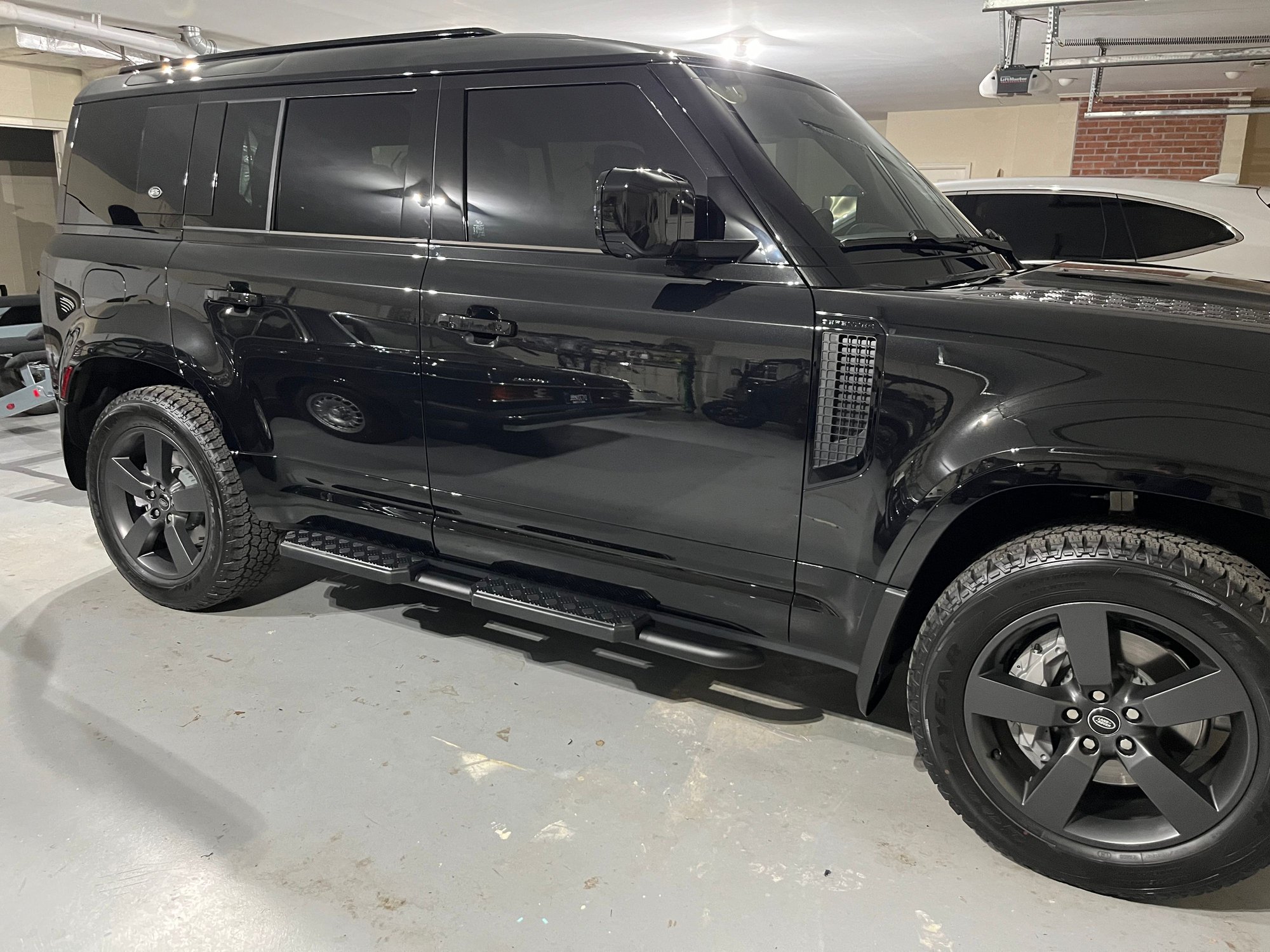

You will like them! The US distributor for Urban is close to my work so I bit the bullet and called this morning and they let me pick a set up. Took about an hour total to install and the plastic and felt cut fine with a razor blade. They seem like very good quality.

No need to take off any trim for the Urban steps…..they don’t have the side bolts. Just crawl underneath, roughly measure the mounting points based upon the Urban instructions, feel under the rocker trim for the cutting guide lines (not in the instructions….got this bit from the powerfuluk video), use a razor knife to cut the plastic and felt, remove the mounting bolts that you will see once the cuts are made (6 of the 8 bolts were already there), and bolt on the steps using one additional bolt per side that comes with the kit.
