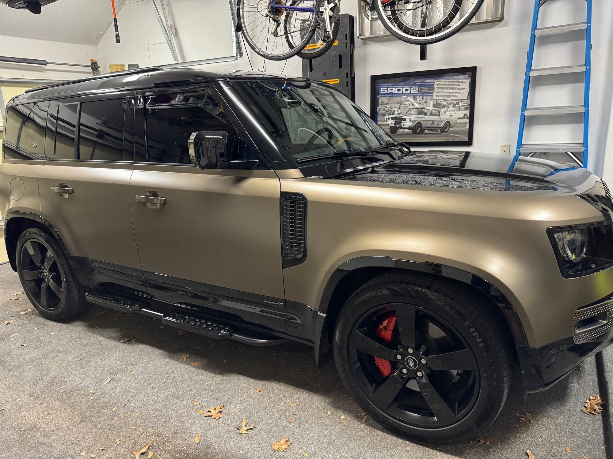

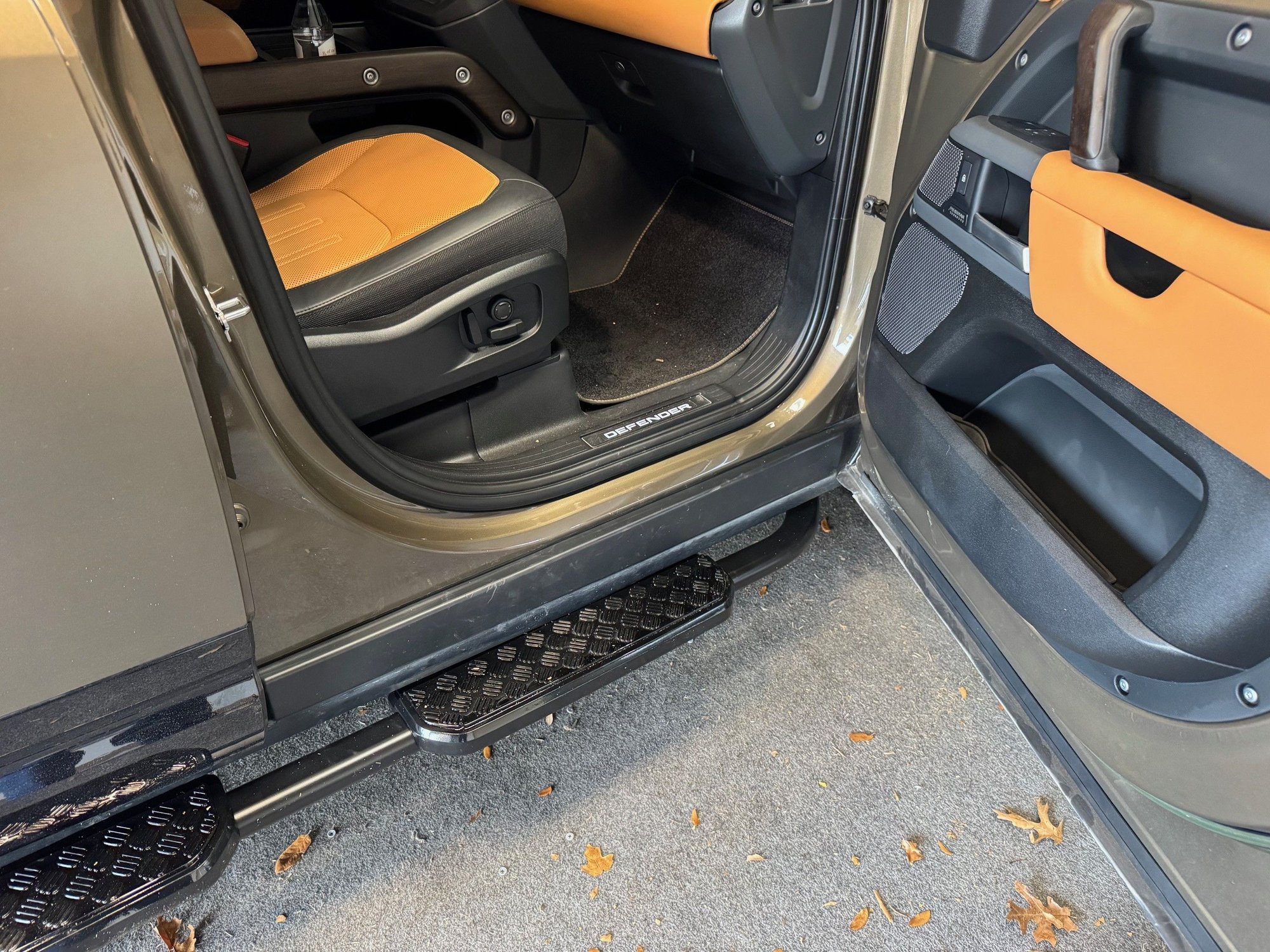

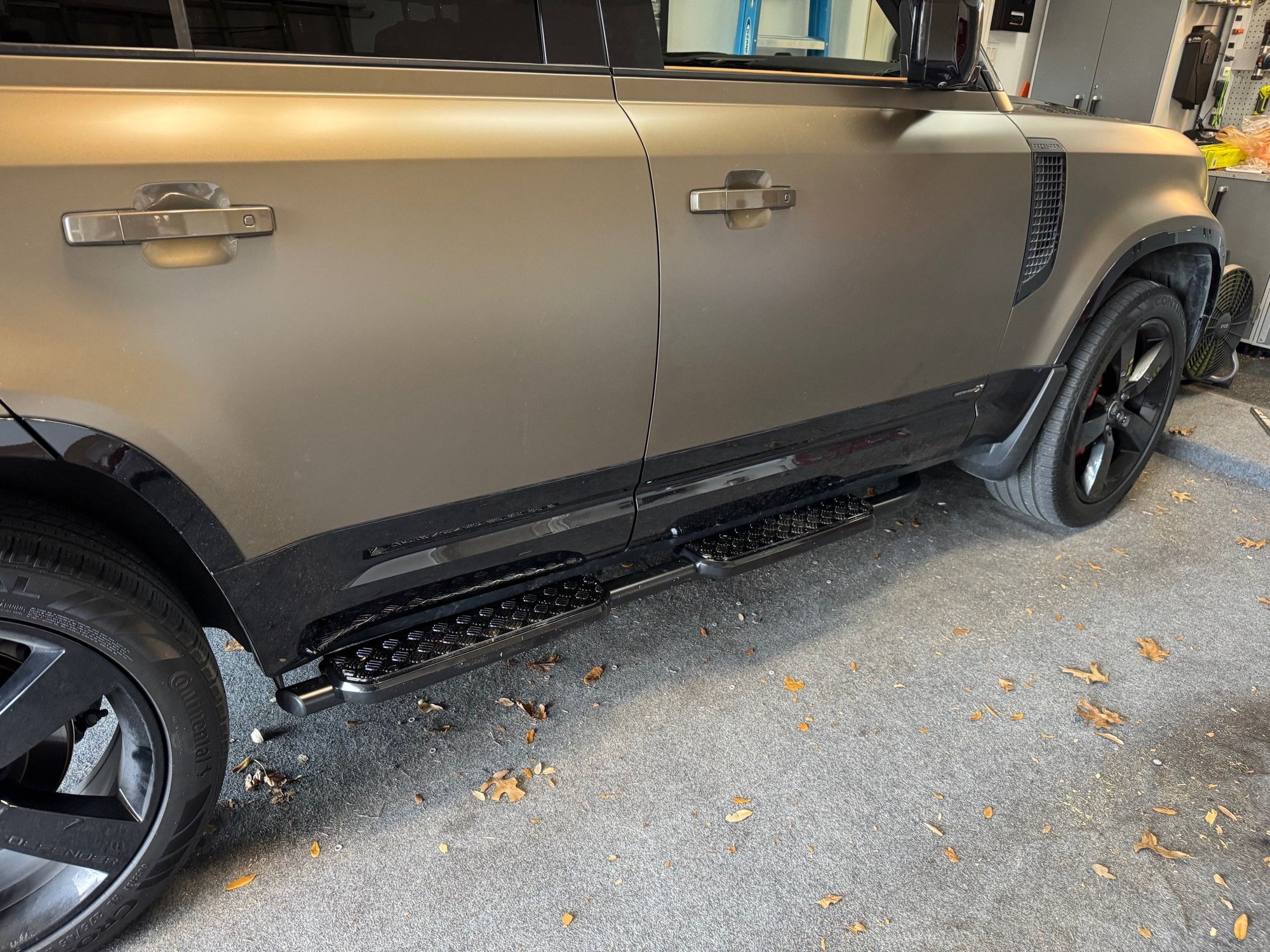

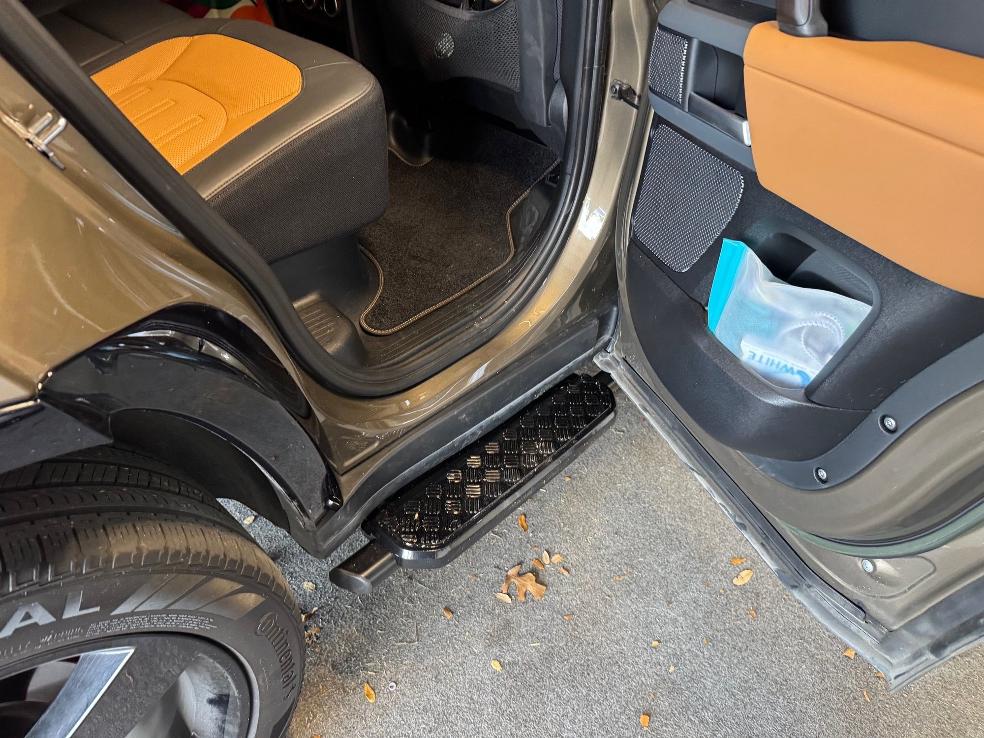

I just finished adding the side steps to my wife's 110. I thought the installation went very well and took ~2.5 hours (doing everything by myself). I'd bet I could easily shave 45 minutes off of my next installation...if the need arises. I used the video instructions from Hunters Prestige and that was a big win. The other videos instructed me to remove the entire pan, etc.
Here are the results:

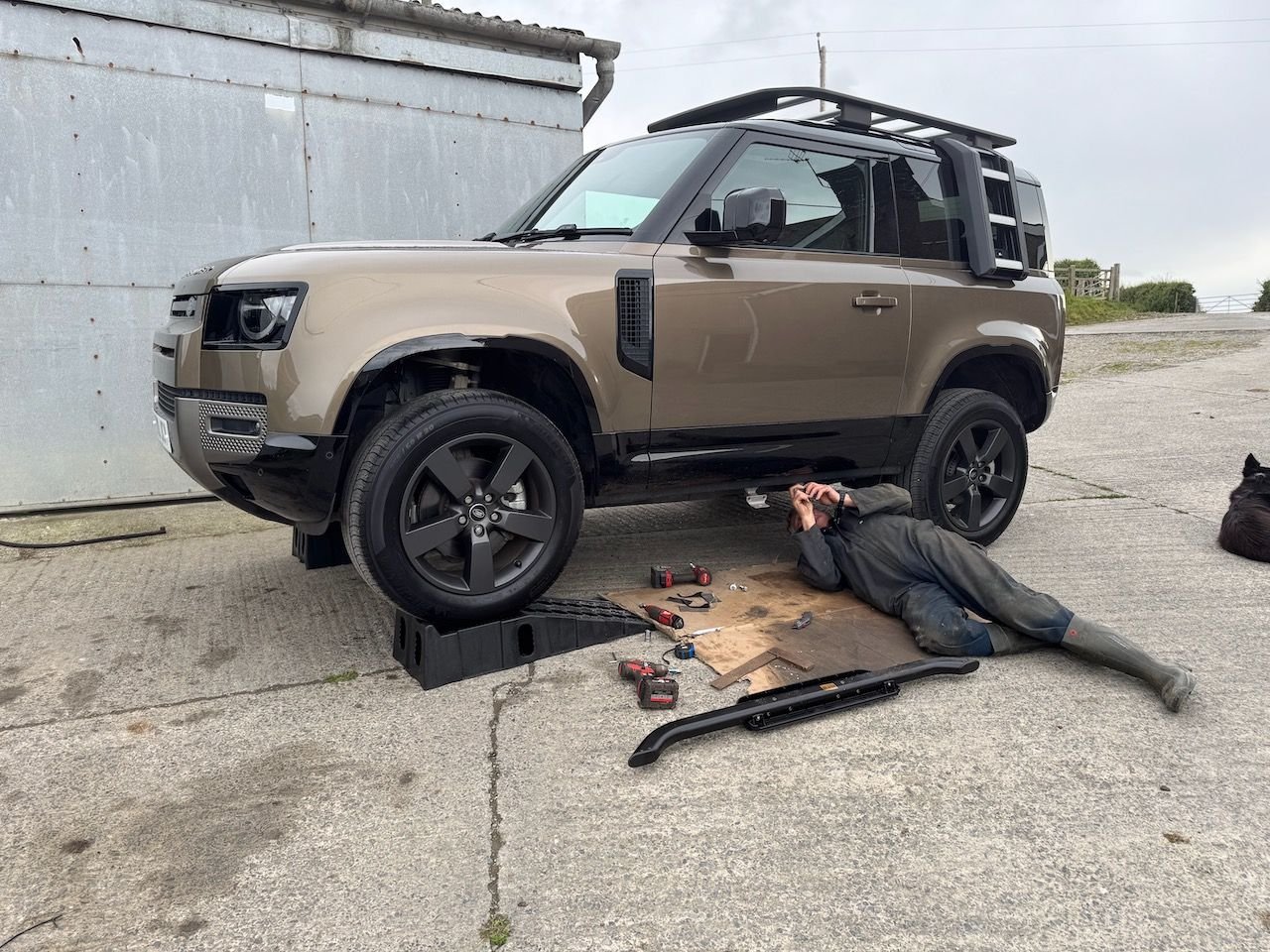

Here is mine being installed. Defender up on ramps with the suspension raised to offroad height for maximum convenience.
