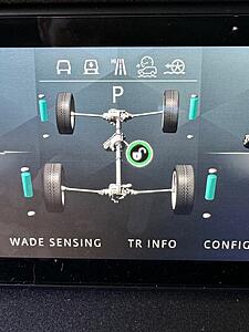

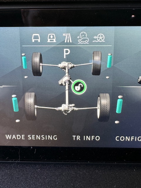

Originally Posted by tbrown
In Pivi select the i4x4, it should show you there if you have one or two locking diffs. I'll try and find a photo showing it (or maybe google for the image).
Here is a photo of my set up via Pivi

you have a stock setup
no rear locking e-diff is on your Defender
center locking diff only
rear is regular.

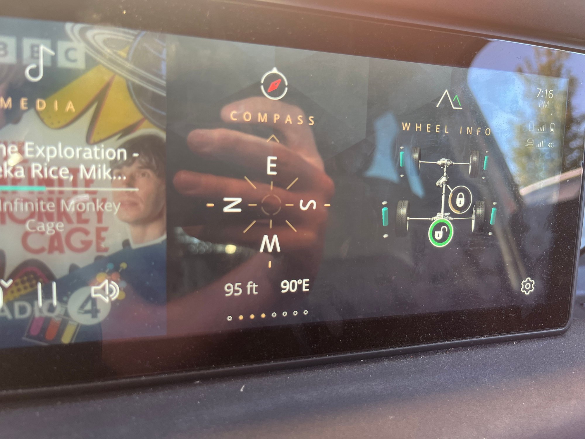

rear is regular.
Two diffs shown here. Off road pack gets you the rear e diff.
