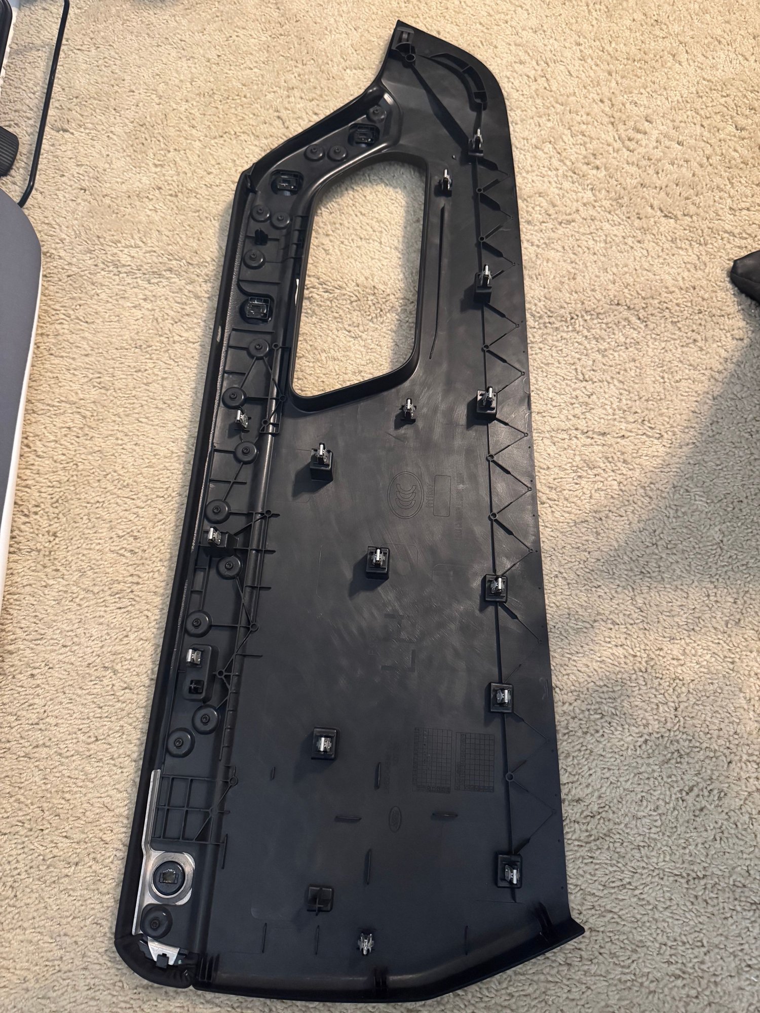

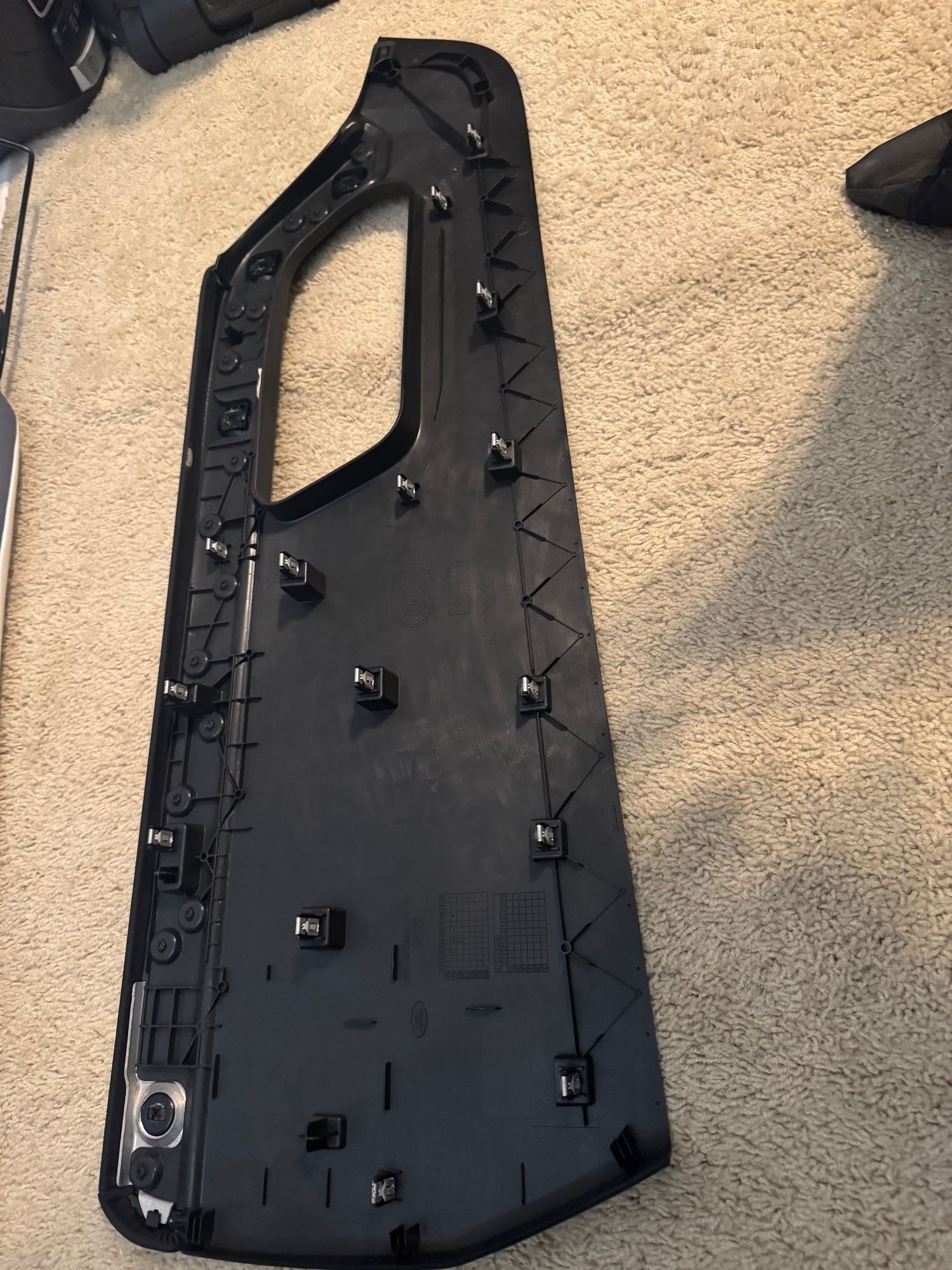

Here is what the finisher panel looks like on the back side. I would recommend unbolting the seats to give you more room as you want to pull the full panel (side of the console off) as the wood finisher is screwed to it from the back side. Please note that toward the front of the car, where your feet are it slots into the trim in the front, so you pull the clips off (outward) and then pull the full panel back to get it out of this slot. Hope that makes sense. See pics for more below. What are the finishes of the finishers you are removing?
I am looking to replace my black ones that use the same "neoprene" material as the door arm rests.

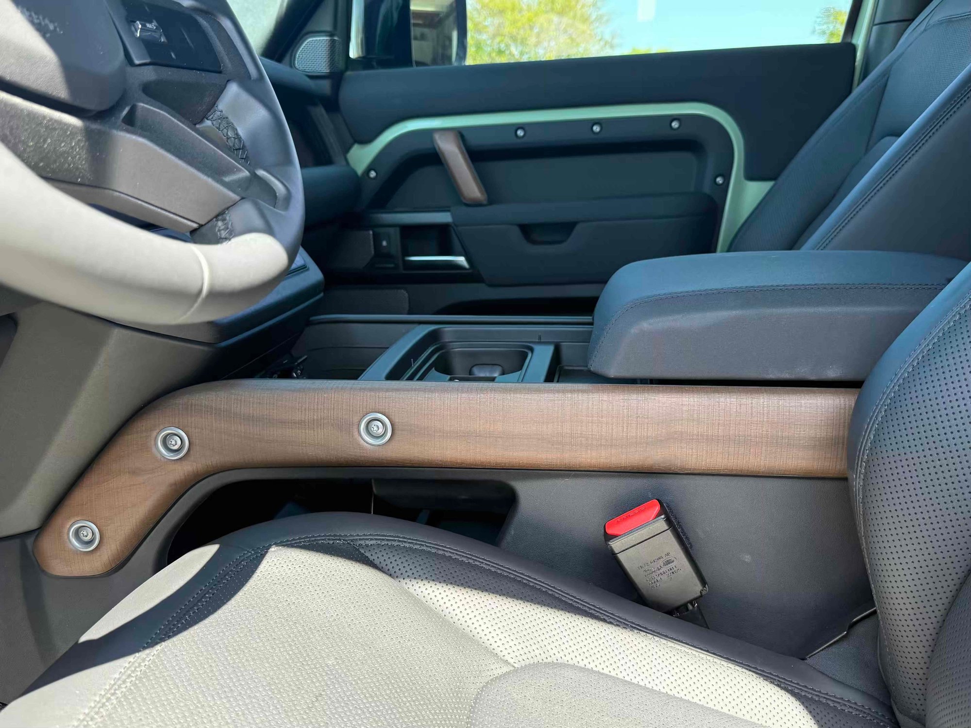

I maybe the rare (or weirdo) since I took off black hexagon textured fabric center trims + satin silver door trim to walnut wood.
I never knew I'll spend money to buy wood trim for my car ever but I wanted some color inside and matte walnut seems like its complementing the 75th somewhat retro color exterior well so I just made a move.
Removing seats (just to put as far as possible from the center trim without removing any harnesses) helped. That 1-1.5" extra space is what I really needed to access the long center clips.
Thanks everyone here sharing their tips from the experience. Really helped me a lot.

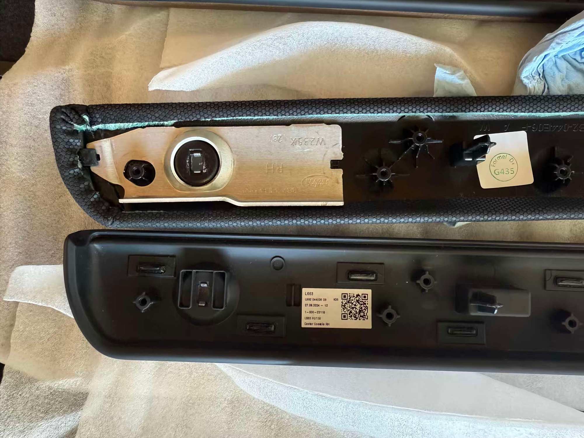

One note though, I didn't (couldn't) install the end metal plates on the genuine wood trim as inside of my original and wood trims shaped differently (all bolts/clips lined up perfectly but didn't have metal bracket holding area at the end also clip area shaped differently on the plate covering area). Maybe this is updated design. Other than that, everything worked out perfectly.
