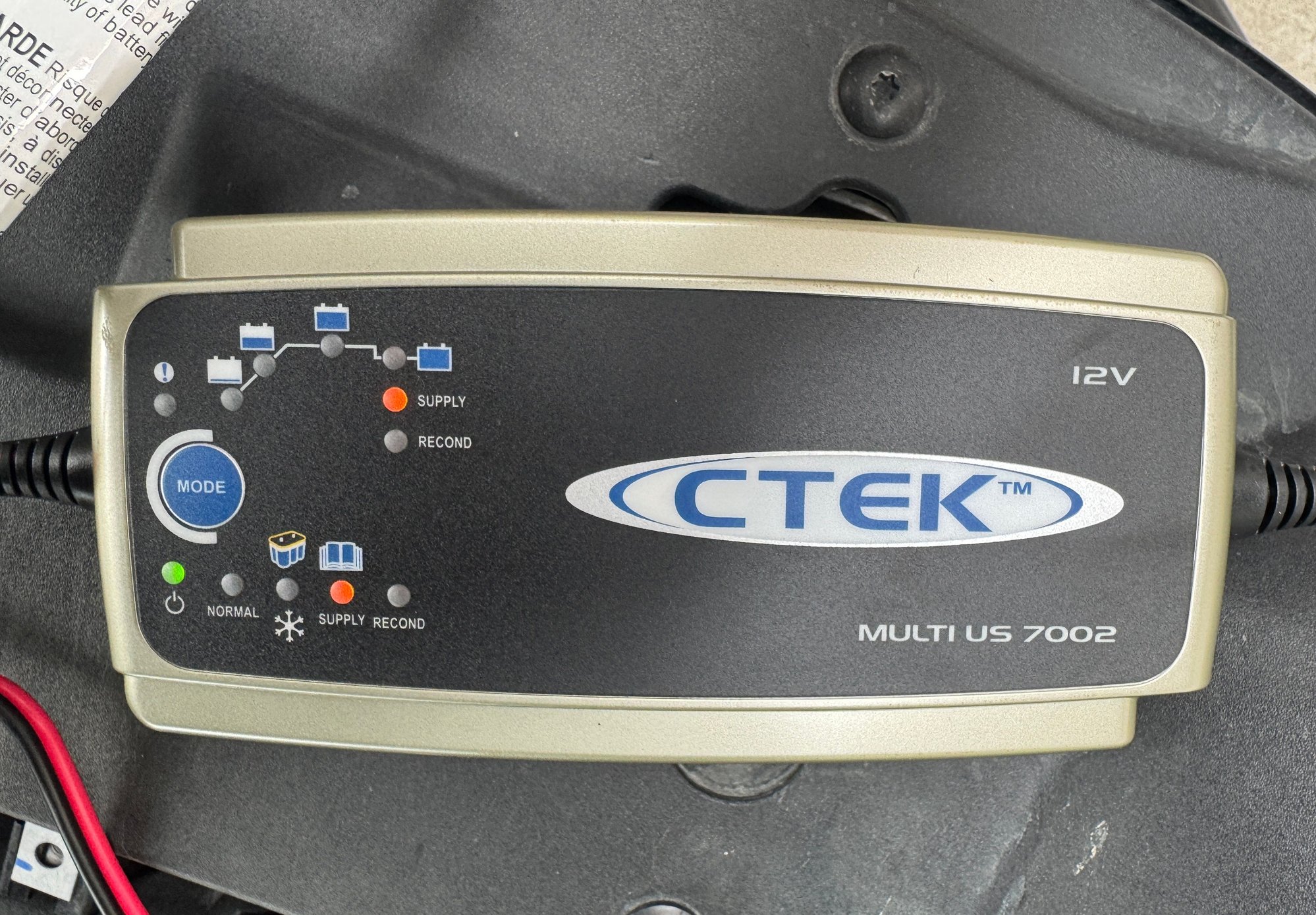

FYI: A standard garden variety lead acid / AGM / Li-Ion CTEK which charges as a trickle charger is not a power supply and won't function as such
There are a couple models of CTEK (I have one) that act a as power supply and have a power supply mode. The easy way to tell = it's sort of 2x the size of the smaller ctek chargers.
This was a surprise to me. Until I got the one that acted as a power supply.
Which unit died you get? I got one recently and it seems to act as a power supply, but only for 7A, and it's their most expensive model.
Old Sep 2, 2024 | 02:49 PM
  #24
nashvegas's Avatar
Joined: Oct 2007
Posts: 2,768
Likes: 1,982
From: Whidbey Island, PNW
I think I got the same one… The 7002. Did you see something from JLR where it said it should be more than 7 A?
