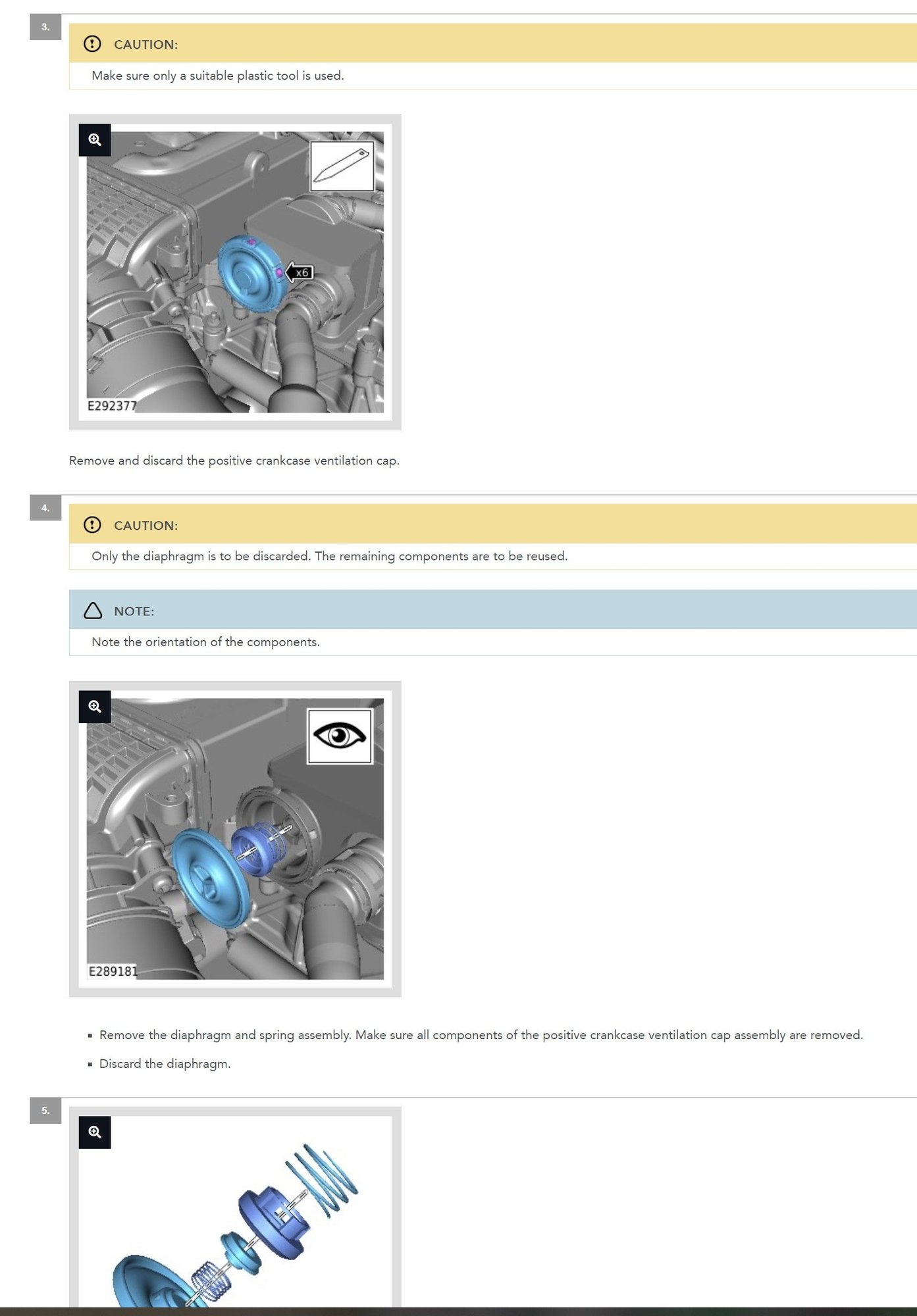

Seems straight forward. Biggest PITA is to move a few things to get to it. First the main diaphram is replaced after removing the air filter outlet hose. Never knew there was an "outlet" side of the air filter - I'll figure it out.
Then replace the two breather seals. One on left side of engine, one on the right. THAT is going to be the effort. As it appears like some things may have to be moved around first. Worse thing that could happen is that I F' it up and have to take it in to the Dealer for them to do under Warranty recall. "What's that you say, Mr. Service Writer? No way did I attempt to fix that! Why would I possibly try to work on something that you all can do for free? Me, I do all my mods to the exterior that you see. Someone reading a Topix manual must not have installed it correctly!"

Thanks for the pics and notes. I take notice of the warnings such as: ‘Make sure the seal is installed correctly’, and ‘Note the orientation of the components’. Makes me think that the poster who brought in a perfectly running vehicle only to receive it back exhibiting the exact symptoms that the replacement was supposed to ‘fix’ was a victim of a lackey mechanic who ‘effed’ up the install. Looking at all those components, it’s possible that adequate attention was not paid to the proper order of those parts when reinstalling. How else to explain his dilemma? It really is a simple job, especially for a trained mechanic, but we all see the level of competence these days. Heck, it’s hard to even get the right sandwich made these days, you ask for extra cheese, no onions and get home and find just the opposite. I will show these forum entries to my service advisor and gauge his reaction when I inform him that if I get my car back running worse than when I brought it in, a dark cloud will follow him for eternity. This is the guy who when I picked it up from a minor adjustment the day after delivery, pulled me aside and practically begged me for all 10’s on his performance review, suggesting his job would be on the line if he gets anything less. Well then, I expect all 10’s in the work being done. Going under the hood to scope out the situation and decide which route to go. Thanks.
