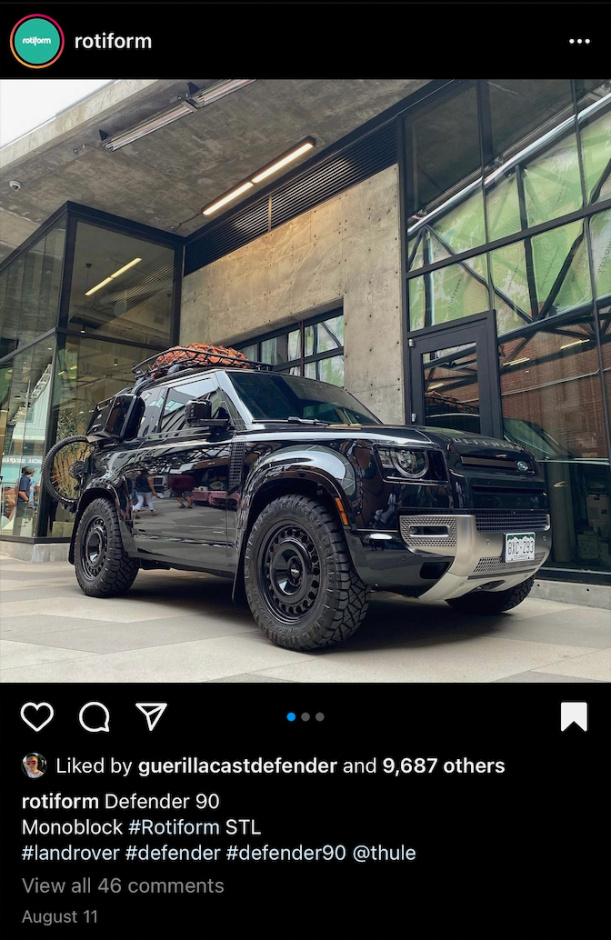

Nice! Go notes! Those look like "18s these were the "20s I had in mind

Default Rotiform Wheels
Mine are 20's with Toyo Open Country A/T 285/55R 20 tires.
No rubbing or fitment issues? There's another thread with someone asking if a 285/55 would work (rather than the safer 275/55 option)
Old Oct 12, 2021 | 04:50 PM
  #24
jrod's Avatar
Joined: Nov 2020
Posts: 11
There's a little bit of rub in access mode when turning so I raise to normal height at start up.
