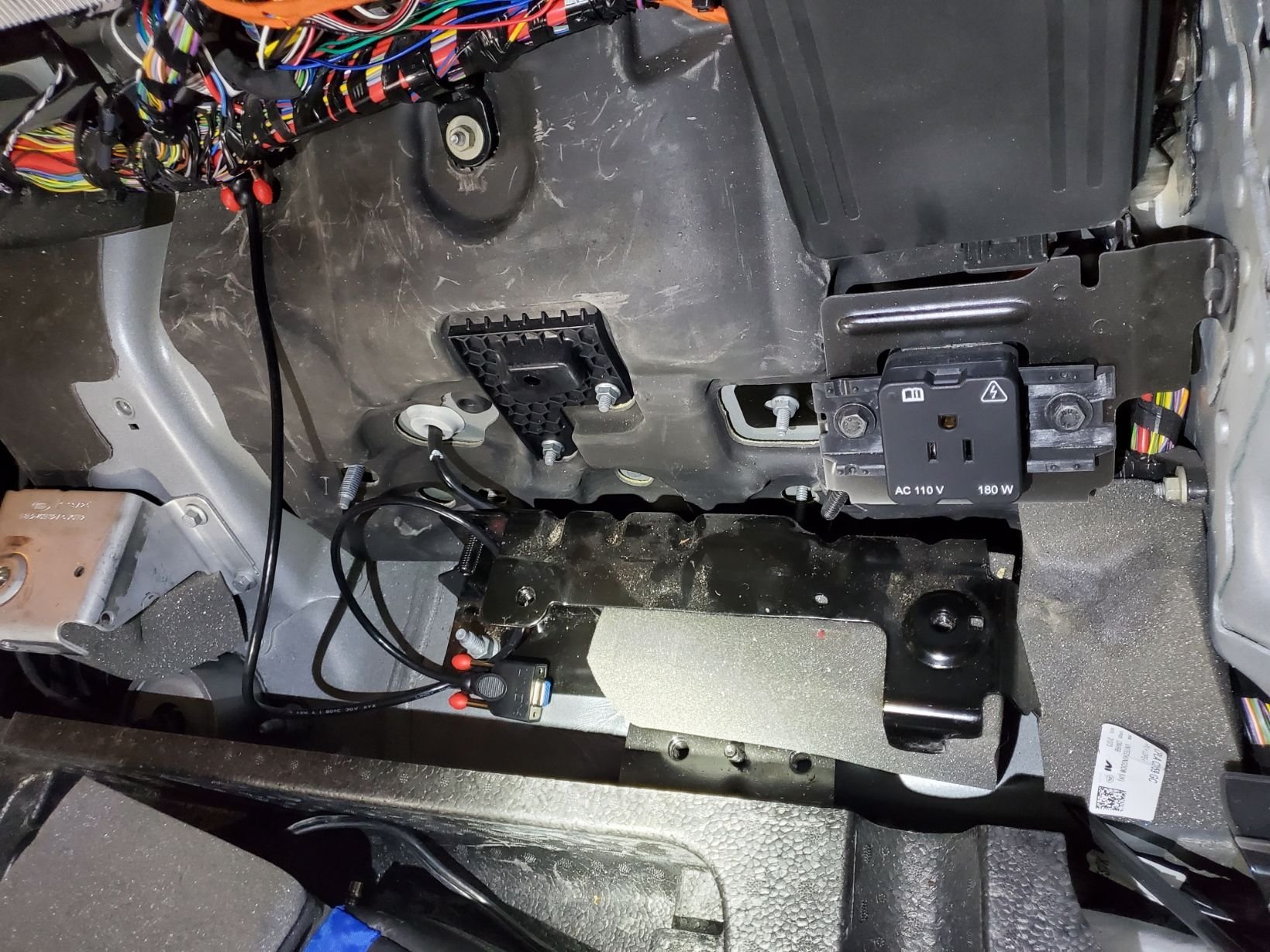

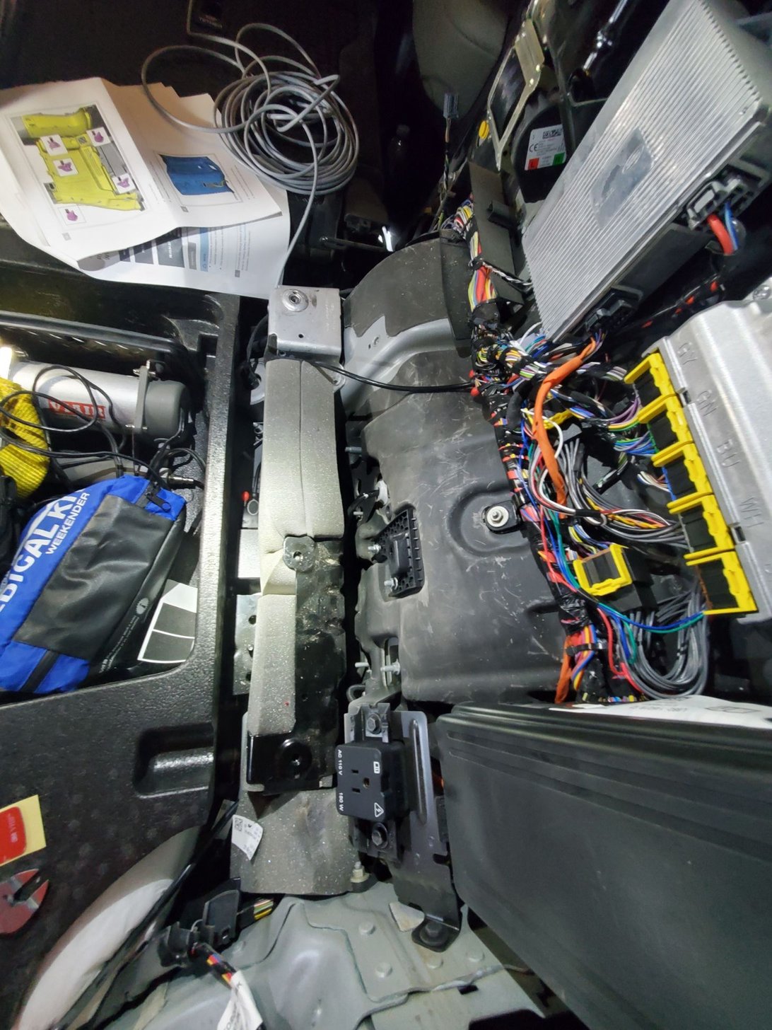

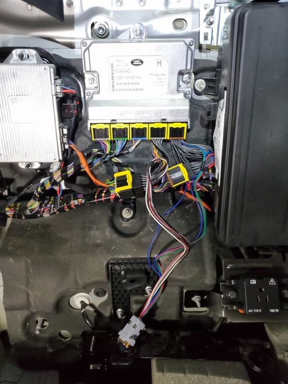

Installed, works great. The LLAMS controller is easy enough to hook up to the EAS module with the supplied harness, and I found the ideal place to install it so it is easy to access for service or to install the null plug that disables the controller completely (making it undetectable to the dealer's diagnostic system and allowing factory calibration.) The biggest PITA was, you guessed it, running the long cable for the switch from the rear right panel in the cargo area to the front left dash near the steering wheel. I tucked it under the edges of the floorboard and it was a painstakingly slow process, but I wanted to make sure the cable was invisible. Also, after much thinking I decided to mount the control switch on the shroud of the steering column - the switch is too large to easily mount in the blank for the brake controller. I can operate it by feel anyway, so don't really need to see the switch or its LED to find out where it's set. Even on the steering column shroud where I placed it, you need to be very precise as there is a lot of stuff hidden there and the switch could get in the way of other modules and wiring harnesses if it's mounted too high, or not mount properly if you drill too low... Lots of measuring was required before I decided to commit and drill, lol.
Overall it took me 5 hours, longer than I thought but I was being careful not to lose or break clips and stuff (still managed to break a couple of yellow poppers behind the right side loadspace panel, but luckily there's at least a dozen more back there, so two broken ones don't seem to make any difference.)
Will take a short video tomorrow, to show the benefits and features of the LLAMS height controller, since pictures are worth a thousand words. Meanwhile, here is a handful of install photos (it was dark outside, so they kind of suck), which probably won't make much sense to you unless you decide to install this, in which case they may be helpful. As you can see, I have a 5-seater so 7-seaters may not have as much empty space available under the cargo area floor.
